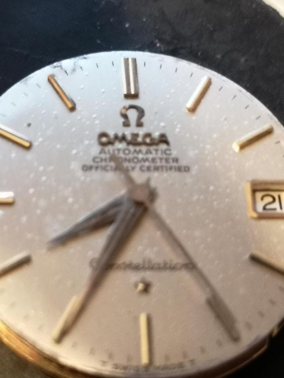

4 minutes ago, Mazboy said:
Hi guys, i'm slowly learning and improving my skills to service and repair watches and getting good results.  One area i've yet to tackle is how to clean up a dial.  I don't want to get in re-luming/re-laquering etc. just yet, just a basic clean of dust and dirt to improve the look of the dial.
I've seen a few videos where is suggested to immerse the dial in boiling water for a few mins before dabbing with a cotton bud but wasn't sure if this would lead to adding more damage.
I've also seen a few of the watch tool sites selling Class & Dial Cleaning Pens and Cleaning Swabs and wondered if anyone had used them with any success?
So my question is in two parts, firstly what chemical/liquid should i be using that will at least be able to remove some of the dirt without causing more damage, will water suffice or should i use Isopropyl Alcohol or is there something else better suited?
Secondly, what tool should i use to remove the dirt, i've seen Rodico being used which seems to work to remove the initial layer of dust and grim but what should i use along with the chemical/liquid mentioned above, cotton buds, baby wipes, cleaning swabs or something else?
Any guidance is appreciated, thanks in advance.
It really depends on the dial material, paint, etc. Some dials are very forgiving, some not so much. Thinks twice. No, think 25 times before you try to remove anything from the dial.
A very sharp peg-wood stick can be gently used to remove dirt, old lume, etc. Then you can use lighter fuel and soft brash to just brash off any oil, discoloration, etc. But you have to be so careful and do not apply pressure on the dial, or you may remove more that desired :-(.
Dry the dial immediately by blowing air. I have just cleaned my Omega dial and it was somewhat nerve-racking / delicate process. It's better to clean less, then accidentally remove more ?
Every dial is different. Sometime we read here people wanting to clean corrosion or substrate reaction, or faded paint - you can't do that. While a damped earbud, applied gently, is almost always safe, I have seen cases were it was not.  So avoid any chemicals and try first to understand well what is dirt and what is not, what the dial can take and what it can't.  Of course, experience helps, when in doubt post good picture here as good advice is always present.
