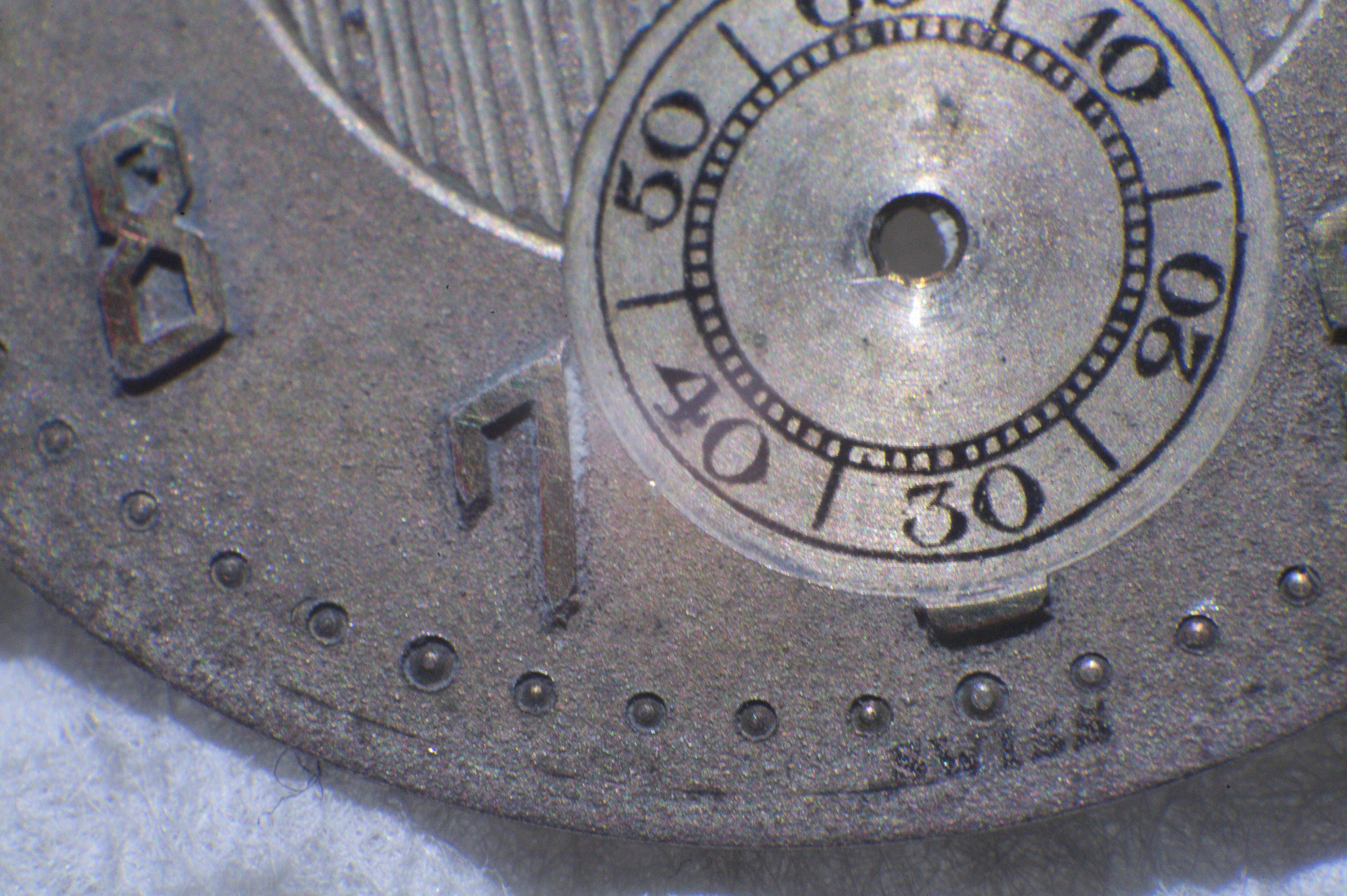

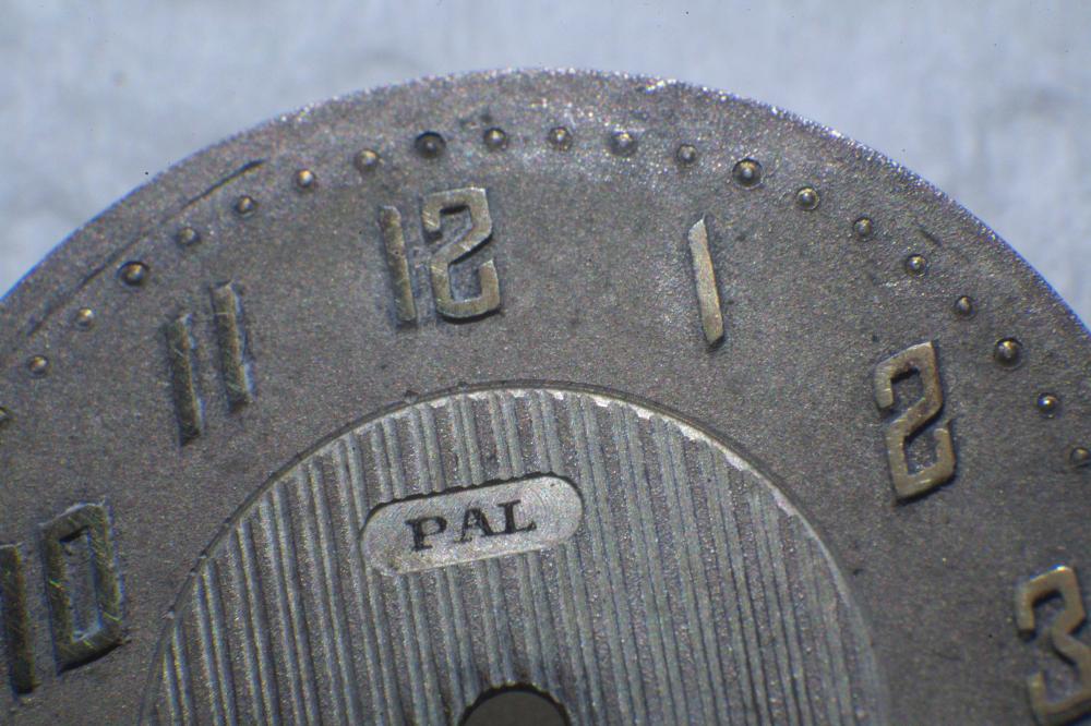

Hello,
I'm working on my AS 341 movement and am trying to clean up the dial.  So far I've been able to polish the numbers by rubbing the face against some paper with a bit of polish on it.  I've also tried using a bit of soap and water as well as isopropyl alcohol, but I'm not able to bring it back to what I would expect is "clean".  Does anyone have any tips or experience with cleaning old watch dials, or what a watch dial like this "should" look like?
Closeups were done with a DLSR, taking an old manual lens and using it backwards.  Makes a great cheap macro lens!  Just make sure to check the mirror won't hit anything and the aperture is as small as possible
Thanks!
