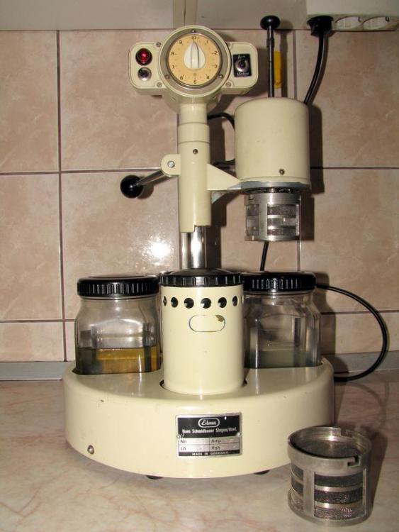

My great Aunt died a couple years back. She had had been married to a man that owned a jewelry store back in the early 80's. In her estate was a number of great treasures and even literal gems.  After the estate sale not much was left, but I did end up with what Ive deduced to be a Vintage Elma watch parts cleaner.  And that is about as much as I have been able to figure out. None of the searches I've performed on the internet have returned with the exact model that I have. Not even an image... Similar , yes. The same . no. ..
I don't have a clue as to how to operate any watch parts cleaner, much less one with minimal text (german) to clue one in on function of switches and dials. So, I can't verify it is in working order. I did notice that the plug had a short in it so I replaced that, Plugged it in and a light above the switch lights up after being flipped, but again end of my road of investigation... So basically, I would really appreciate any information at all about this machine
You turn it on by the switch. The big dial in the centre you set for minutes you want it to spin in each jar, if working properly when the time is up a bell should ring. You lift the centre rod up in the middle that’s attached to the basket and lift it to spin off.  Release the handle on the main shaft and lift, move the basket to the next jar and repeat. You can change the time to however many minutes you want. I cannot remember if the heater warms up automatically or if it needs to be switched on.
Here is Marks video.
 https://www.youtube.com/watch?v=qtQhRKPgjY4
  Here is a photo of what you have.
