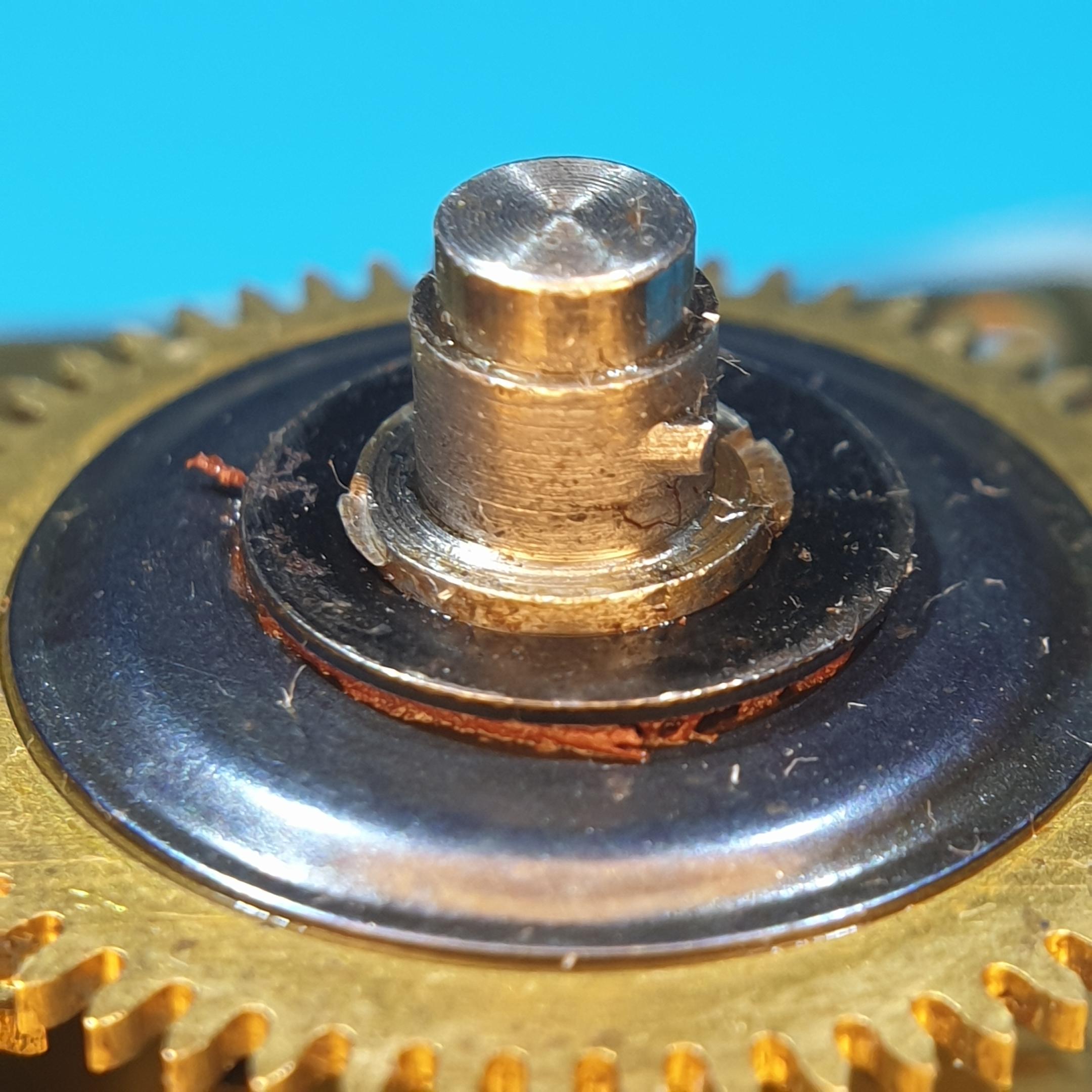

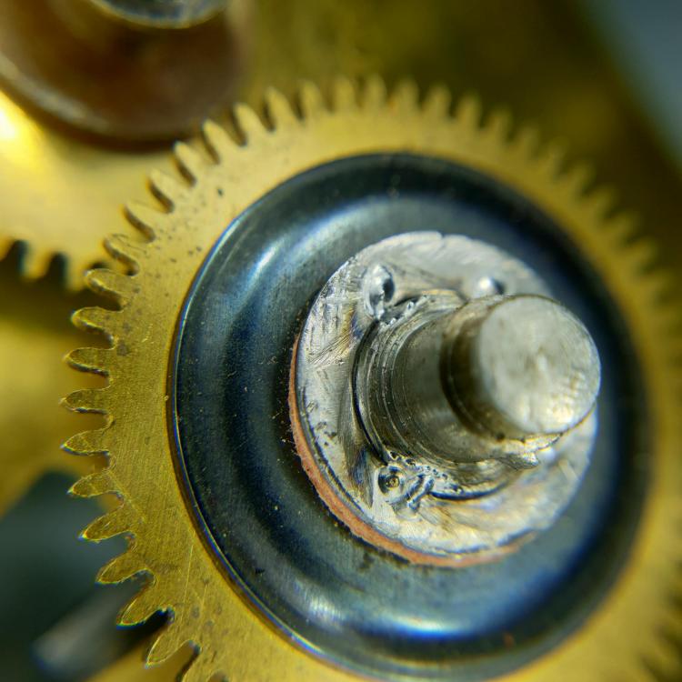

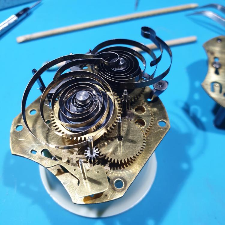

I helping my mentor to repair the timer of his old Elma cleaning machine.
The timer is like a kitchen timer, you turn it to the time desired and it winds down to zero then rings a bell. But now, it appears that the friction wheel has worn off and it returns to zero the moment immediately when your hand leaves the knob.
I've stripped the timer down and can see that the friction wheel is part of the mainspring arbor. There appears to be a red phenolic paper washer that is disintegrating and the spring washer can no longer exert adequate pressure to stop the wheel from slipping.
Has anyone attempted to fix something like this before? I told my mentor to replace it with a timer switch or cannibalize a kitchen timer. But he's a stickler for authenticity.
Thanks in advance.
Just an update.
I used a diamond disk to free the washers from the mainspring arbor and replaced the worn off paper washer.
I had some paper washers on hand but the centre hole was of the wrong diameter. I spent about an hour reaming the hole to the correct diameter and sanding it down to a thickness of 0.6mm.
I then reassembled the stack of washers and spot welded it with my micro tig welder.
Reassembling all the wheels, levers and springs and screwing down the plates was a nightmare. The springs were bulging out and pushing against everything.
But finally everything is back together and working properly.

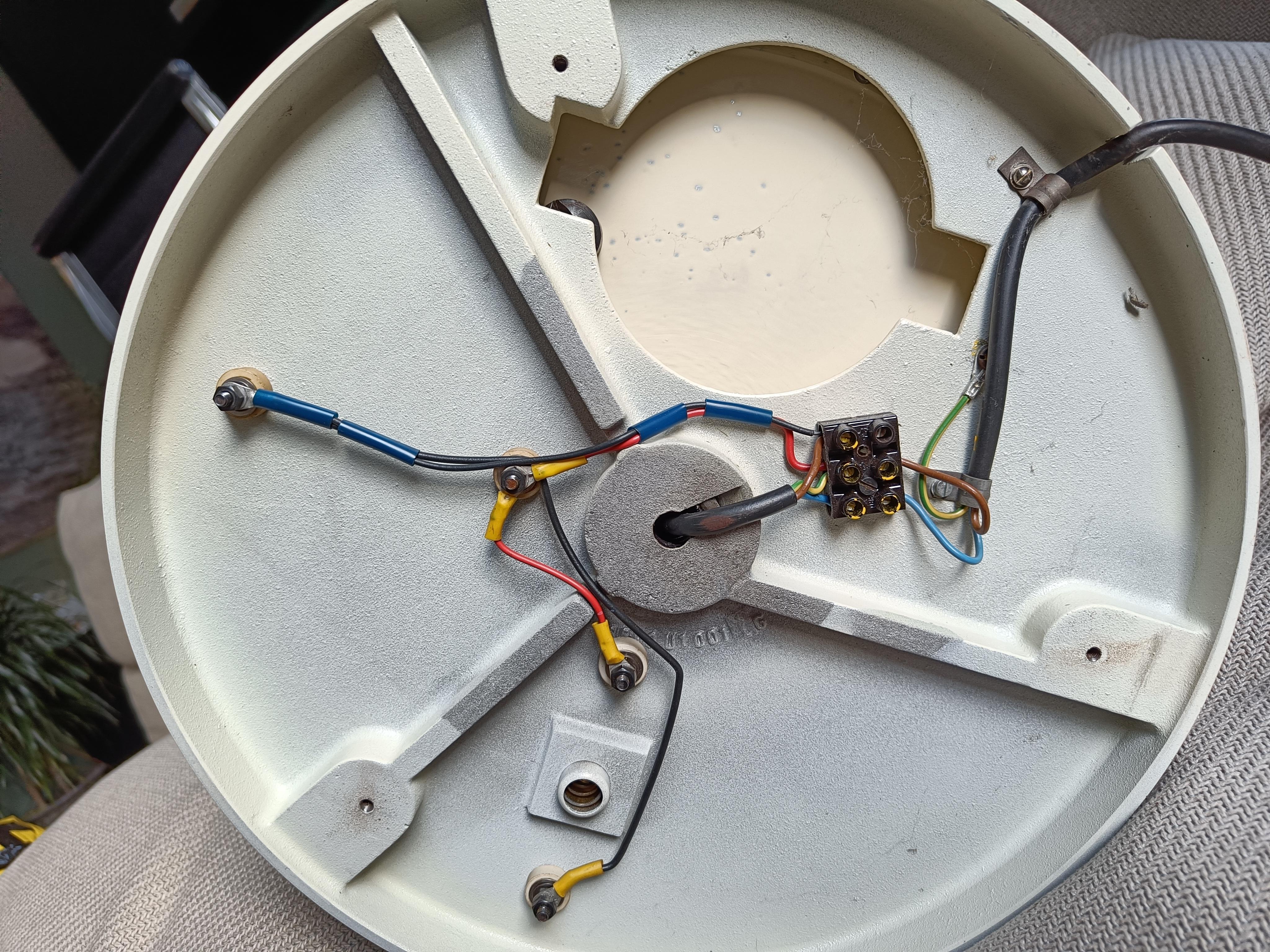

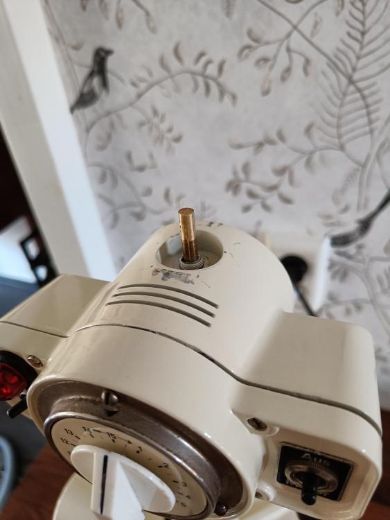

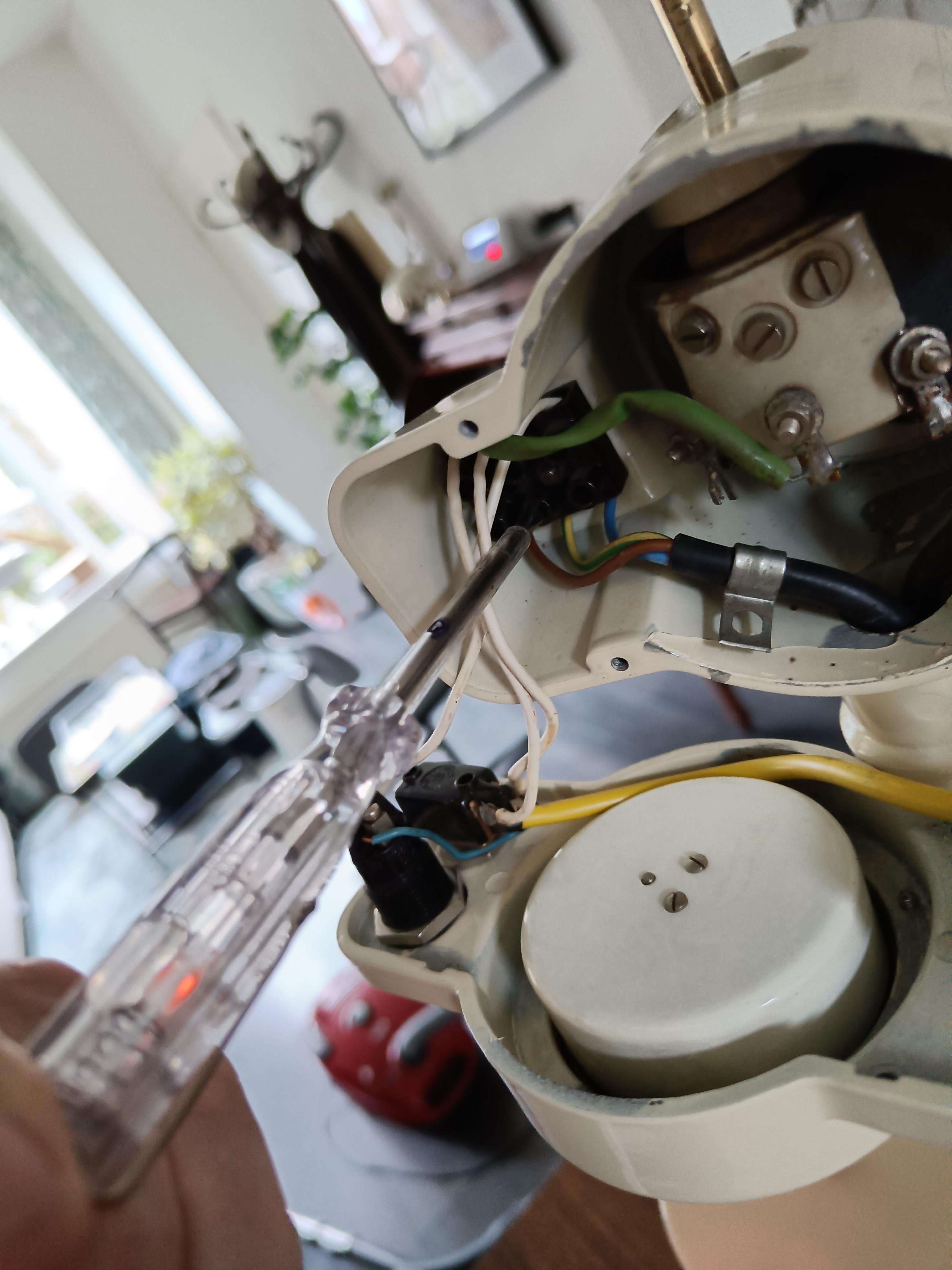

I'm hoping for some help with the Elma super Elite I just received.
The speed regulator of the potentiometer got shattered in transit, it seems to have received a blow from the top. The seller sid it worked fine before shipping and I have no reason to disbelieve him.
After plugging in the machine the heating worked fine, red light came on, but the motor did nothing, no sound or anything.
I accidentally pushed the axle of the speed regulator down, which blew a fuse in the fuse box.
I pulled the axle back up, and opened the housing of the regulator to re-seat the regulator contacts. I now found there's voltage on the neutral/green! I'm trying to figure out what's going on.
Thanks in advance!

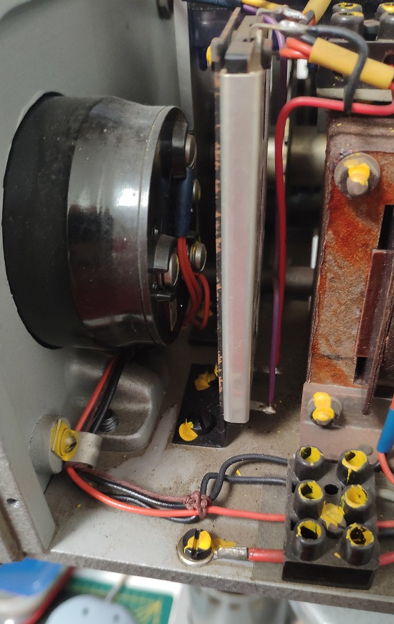

I need to see more pictures. There appears to be only two wires connected to the speed controller. Is that right?
The speed controller looks like a wire wound rheostat. It varies from 0 to R ohms. R is probably in the range of 500 to 2000 ohms SWAG. Lowest speed when R is dialed in and fastest when 0 is dialed in.
I am troubled by the fuse blowing. No setting on the rheostat should cause that, so even if it is damaged in some way causing 0 or R, it would not blow a fuse. However, if one of the wires is shorted to the case, then you might blow a fuse...and this is possible due to physical damage.
I would unplug power and remove the rheostat and inspect it...post pictures.
