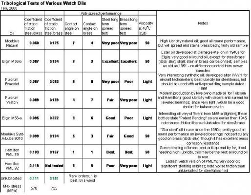

Horological lubrication properties somebody has done a test for us it's a shame they didn't test all of them or a bigger sampling. So the tests are basically friction the contact angle which has to do with spreading and spreading. Or simplistically we want are oiled to stay where every put it. So notice 9010 is on the list and it's spreading characteristics are not outstanding. Interesting one is Elgin M56-b which comes up on eBay from time to time and people are still using it. Is why made a reference to using a 50-year-old bottle of oil off of eBay because people are because it seems to work after 50 years. It's outstanding properties didn't go unnoticed Notice I have a couple links regarding Elgin oil it's being currently manufactured again. So modern equivalent looks quite interesting except I can only find it in big bottles which are expensive.
So at hobbyist level it probably really doesn't matter what you use. You accept that some things just aren't going to last as long but then you're not trying to push having a watch run every single day for the next five years. If you are doing this commercially then lubrication choices are different. It would make an interesting discussion with a customer five years from now explaining that you went with the cheapest oil possible and their watch has disintegrated because of that.
So first two links explain the evils of what happens if you don't service your watch properly and why you have to service it at regular intervals or else. Unfortunately it doesn't take into account whatever it was previously serviced with and I don't think all the answers are necessarily black-and-white..

Elgin oil the first is a link talking about it the second talking about why it was good enough to be reproduced today.
https://books.google.com/books?id=JQi0BwAAQBAJ&pg=PT17&lpg=PT17&dq=elgin+56-a&source=bl&ots=TeA_kUP6yz&sig=V8CWMQiI_GBFpdBMpyYE3xXACYE&hl=en&sa=X&ved=0ahUKEwillZaSg5bKAhUFxGMKHXDWCLcQ6AEILDAC#v=onepage&q=elgin%2056-a&f=false
http://www.dr-tillwich.com/index.php/en/informationen-8/interessantes/elgin-oil
This link is here because I've attached an image which comes from this link.
http://mb.nawcc.org/archive/index.php/t-39391.html
