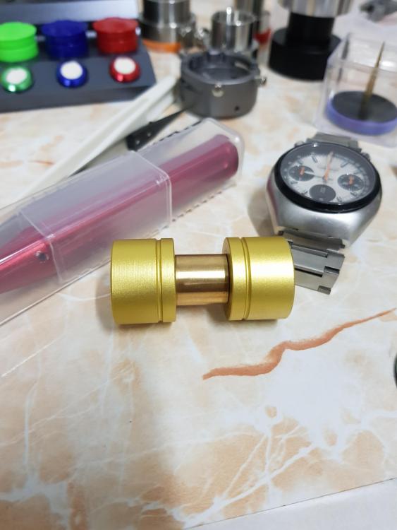

Are the two brass tubes identical to each other, or do they have different inside diameters?
The part of the winder you hold in your hand that has the plunger in it doesn't fit nicely inside the tube does it?
Just wondering if its somehow to make it easier to hold being it is so short compared to the Bergeon one
This is how they fit: loosely over either end. Bottom ring can't fit this way in use as the diameter on the barrels are too wide. Having it over the plunger end would be counter productive as well as the plunger doesn't come out far enough through the top of the ring. Also there are two nice cutouts on the included platter for these to fit in. From what I can tell with my relatively limited watchmaking experience this kit functions perfectly fine without them. But there has to be a reason for them to nicely machine out and anodize 2 pieces of aluminum as well as their respective cutouts on the display platter. Very intriguing.
