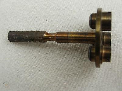

I just bought these K&D 123 mainspring winders (set of 3). I'm currently practicing on Chinese skeleton movements.
I also just finished the Level 2 course. So I'm curious, is it possible to use this on the 6498? I was told by the buyer that he has not tried it on the 6498 as it's a pocket watch movement. But what would happen if I use the biggest (11mm) winder? Will it damage the mainspring, or will it just not load in the winder entirely?
Thanks
What you have there are three differing sized holders that you wind the spring into, the button on the back then presses the wound spring into the barrel, there should be an accompanying winder handle which can be vice mounted with an arbor attachment.
