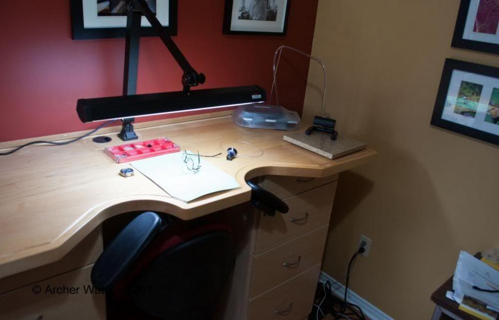

The light you use also needs to work with the surface you are going to work on. A green surface is very good, you don't want a light that throws out heat, you need something that doesn't give off a shadow but also flexible so you can adjust it. You also need good light in the room. I have strip lighting on the ceiling and around the side of some of the walls.
My preference was a green surface and a light like this type. Found this on the internet its not my bench
Agree with oldhippy heat is not what you want as you will find the hour's slip by when engrossed in watches and clocks. A movable light is best and many like the LED style.

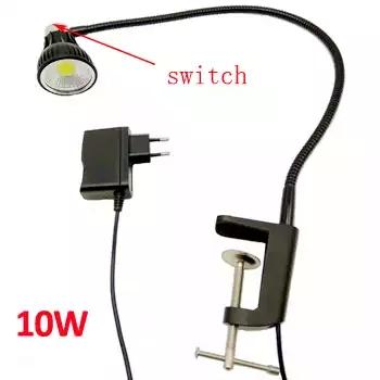

I use 2 LED lathe lights. It offers me more flexibility. I can tilt the light to get into every corner.
I can use it with the lathe, staking tool, jewelling tool... with 2 lights you can position them until you get a shadow free view. You can position them like a copy stand and get reflection free photos.
