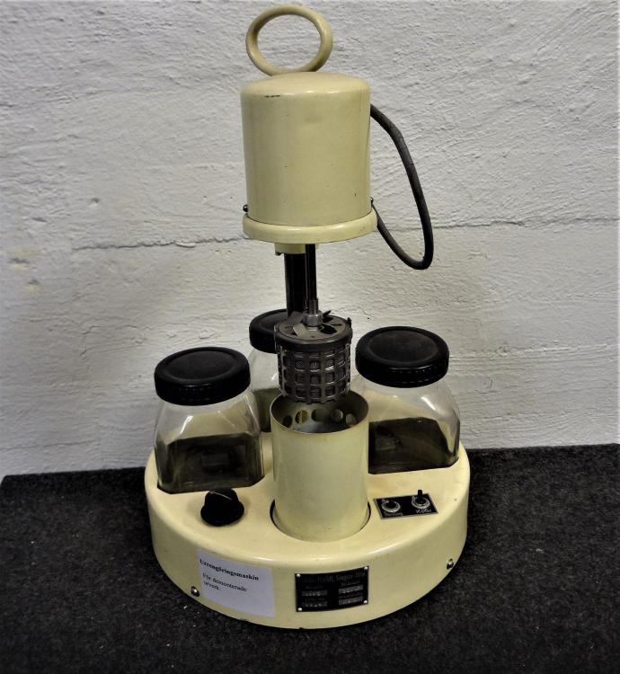

I got myself a used ELMA as well (manufactured 1952) with replaced wiring for about $150. It saves a lot of time and the cleaning result is good enough and makes all brass parts look really shiny. I still inspect all critical parts (jewel bearings, pivots, etc.) under strong magnification before reassembling and when needed I do some manual cleaning as well, like pegging out jewel bearings and removing rust and corrosion.
I use ELMA RED 9:1 for cleaning (5 min), deionized water for first rinse (1-2 minutes), and ELMA Suprol Pro (1-2 min) for the final rinse. Then into the heating chamber for about 5-10 minutes. Since these solutions are water based it's important to minimize the cleaning time. I tried with 10-15 minutes in each container (total 40-45 minutes) and the parts developed some rust and strange looking spots that I fortunately was able to remove manually using vinegar essence (12%) and IPA (Never again!)
