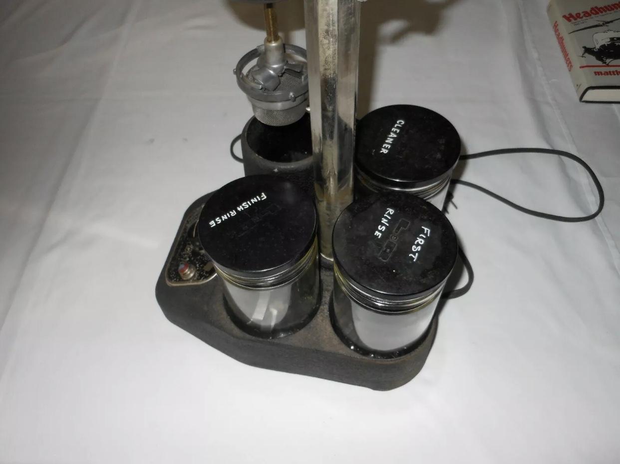

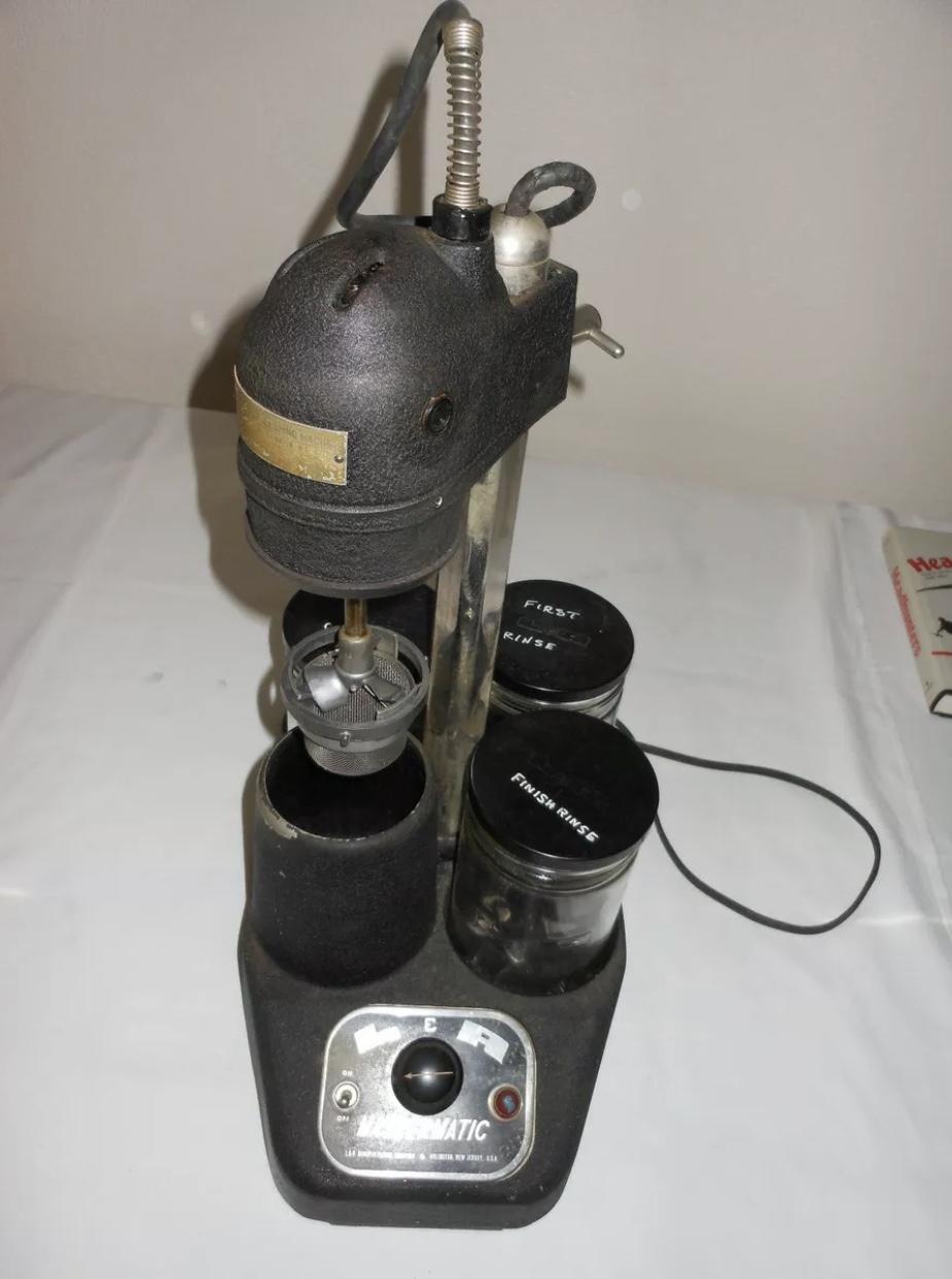

Question about watch cleaning and rinsing solutions, just got an old L&R watch part cleaning machine on eBay, nothing fancy(see photo), the photo is from the seller, didn’t have it on hand yet, I think I’m not using it a lot, because I'm only working on my own watches, but I would like to have the best results possible, like to work on some new Seiko movements, a old Russian Slava movement and more watches to come, need some recommendations for what products to use and where to get them with reasonable price.
If you have any tips, feel free to share too, there really not a lot of material out there on this topic, I mean what products to use, what different between products, what part do not put through the machine, I know plastic parts do not put through the machine so far.
Thanks a lot for your time.

Hi,
Few things worth mentioning is I live in WA, USA, I did watch Mark's video "How to clean watch parts and what solutions to use. Watch repair tutorials.", that's the most detailed video I had seen so far, but this video is made back in 2013 and some products are hard to get.
Have a look to the pinned topic on the subject:
BTW, I don't think that an old, non-ultrasonic machine will make much of a difference for an hobbist. Personal opinion from experience.
Edited by jdm
Hi Jdm,
Yes, I'm also following that post, thanks.
