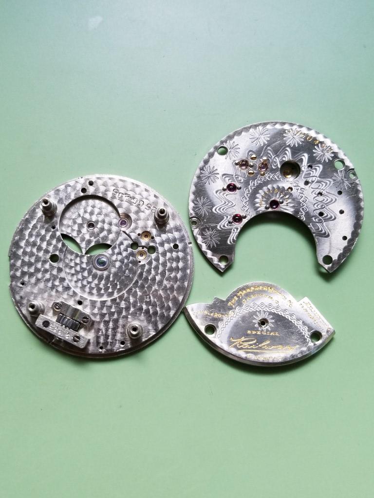

I cleaned a Hampden 18s P/W today with my solution and it was really dirty being 100 years old, and all. It turned out great as usual. I rinse with alcohol
Do you agree?

They look beautifully clean! A wonderfully crafted watch. I just love the ‘engining’ machine marks too.
