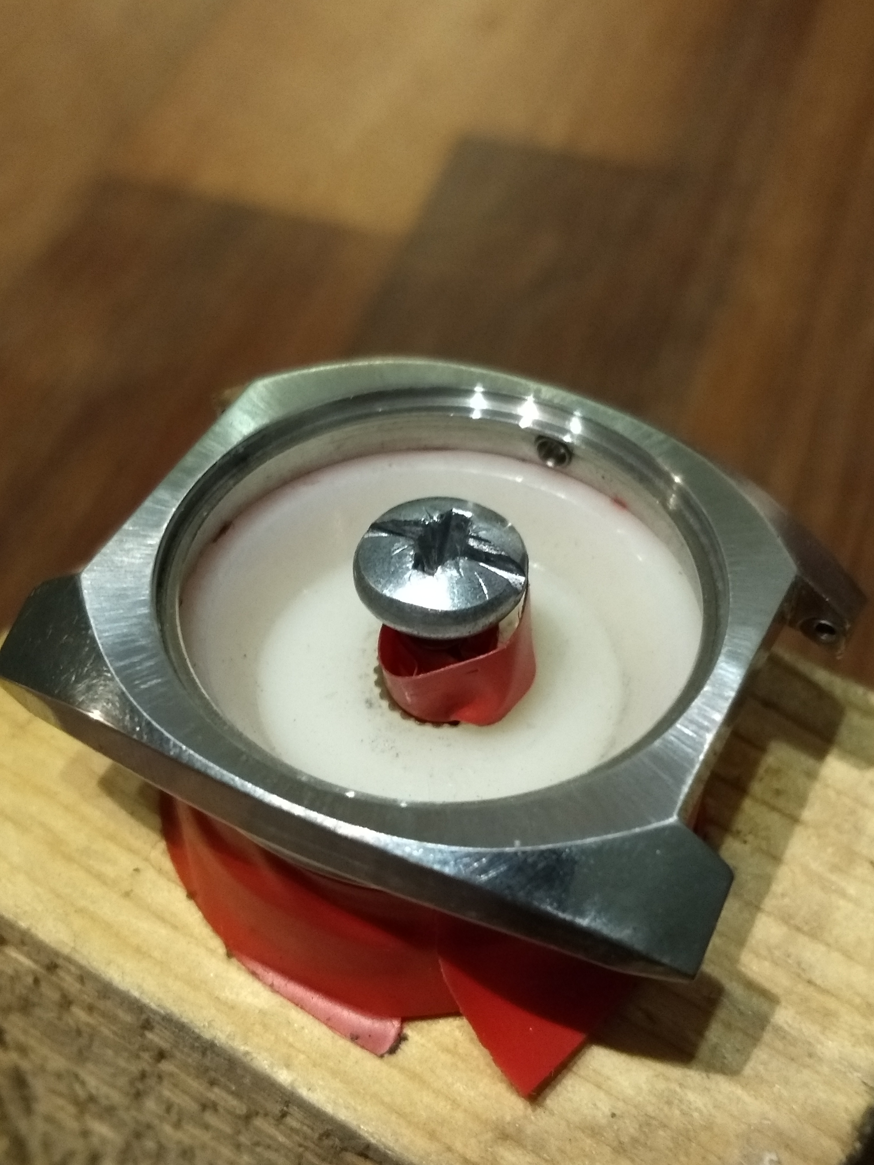

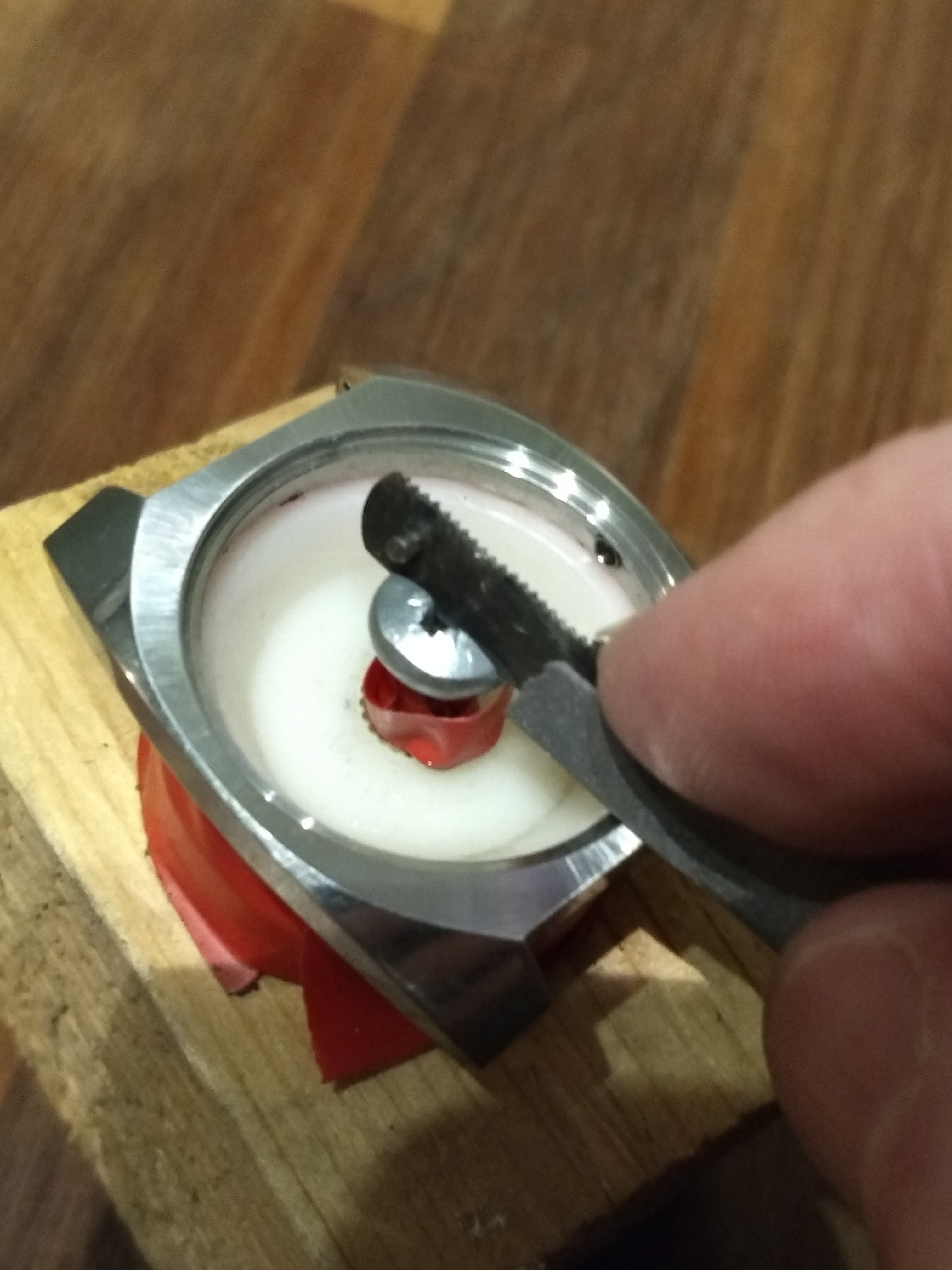

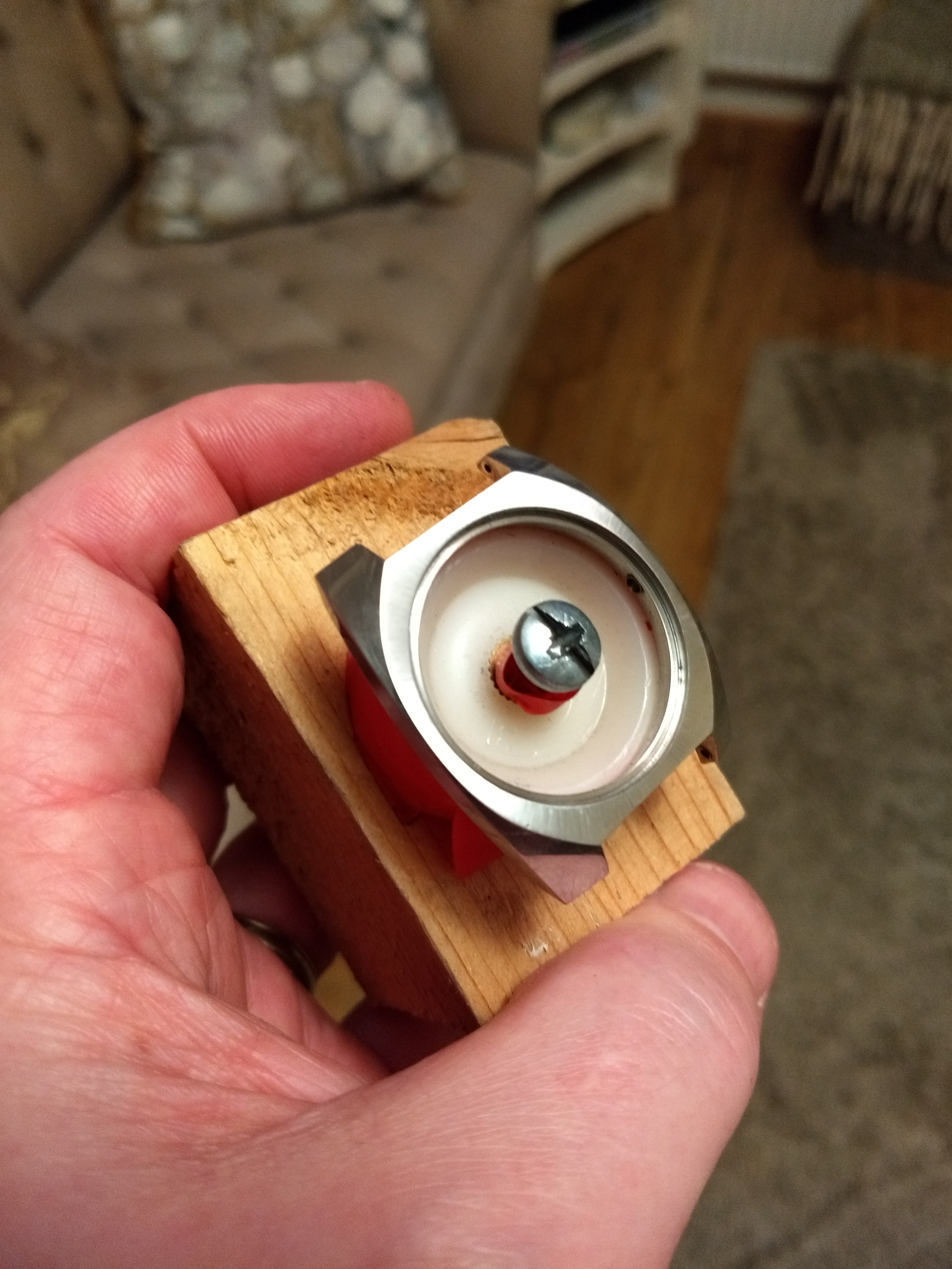

  2. Hi, Just wanted to share my experience of radial brushing on a Seiko 7005-8160P. I built a little jig using a block of wood, plastic case press, and Wood screw. I think the pictures are quite explanatory. The red tape was used just take up the slack. Using a junior Jigsaw blade with some 600 grit paper wrapped around it and short 5mm strokes back and forward as the case is rotated slowly. Using the long slot I made in the screw head as a guide. The height of the screw is adjusted so that the Jigsaw blade is flat against the case and not at an angle. It's working pretty well. Will post a picture of the finished case.
    2 points

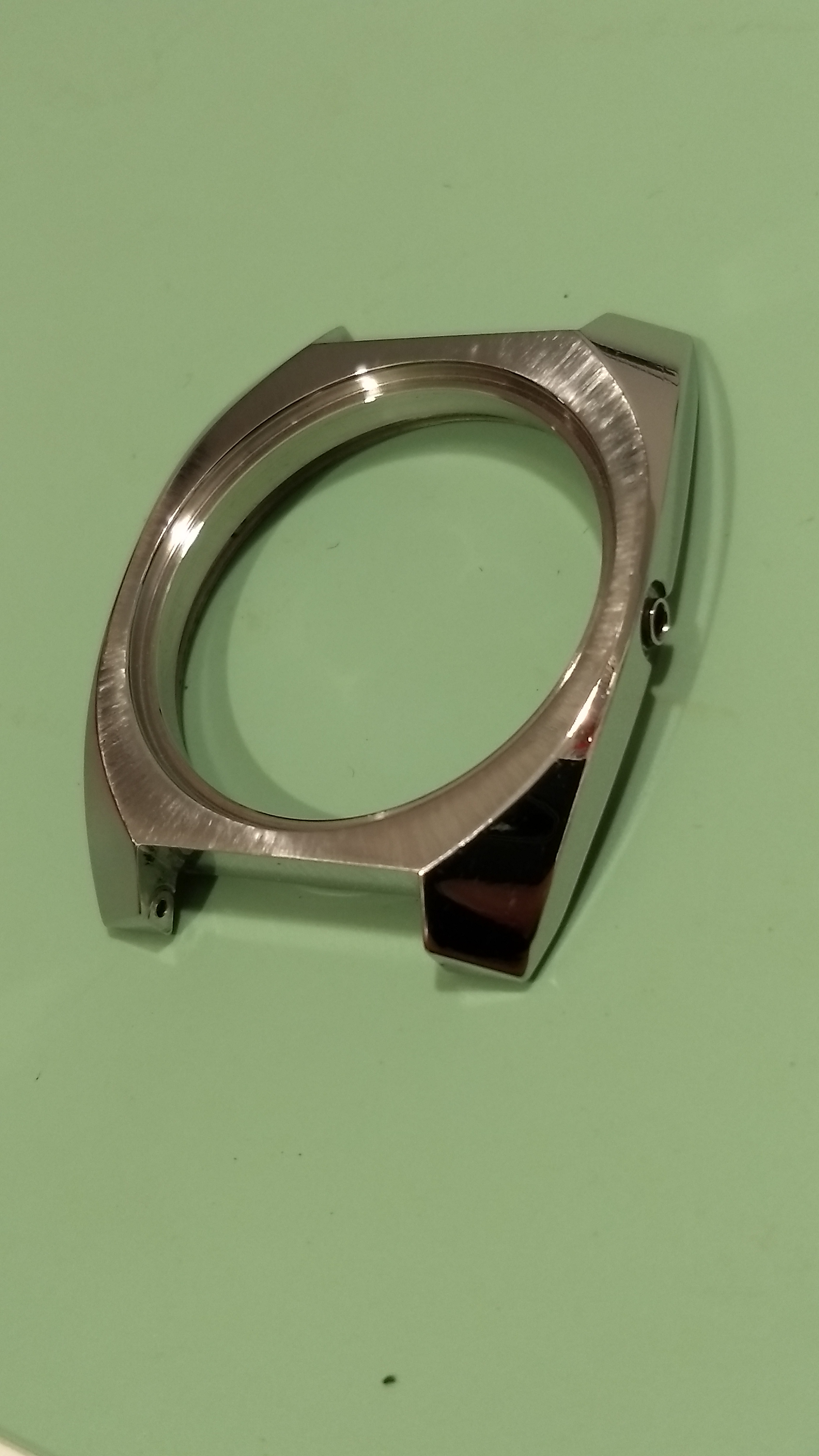

  13. Finished case. Still has a few minor marks but. I think if I went further then I would start losing the case lines and sweeps. In any case this watch is 50 years old so I don't want it absolutely pristine. VID_20201231_183617828.mp4
    1 point

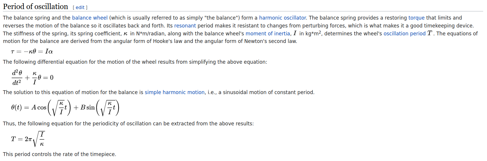

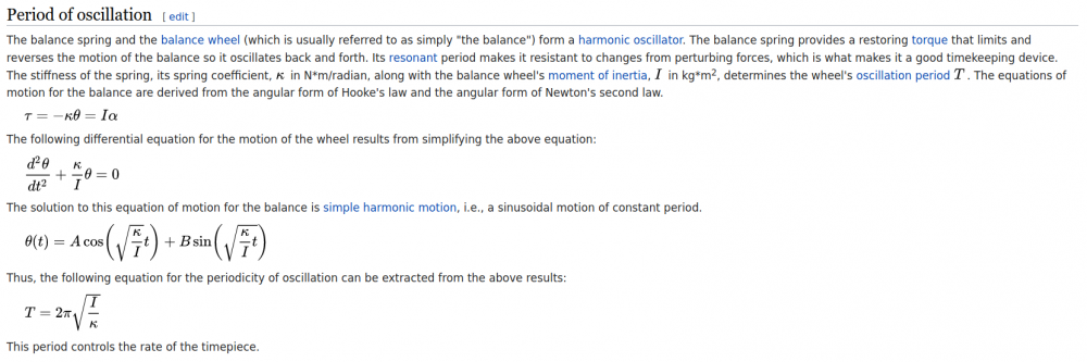

  19. If only it was that simple. Source https://en.wikipedia.org/wiki/Balance_spring
    1 point
