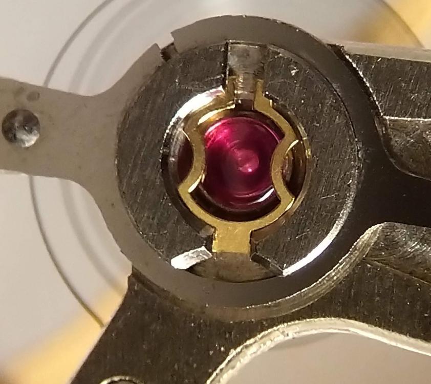

I use an Carl Zeiss Stemi DV4 Stereo Microscope to inspect the jewels with, before I used it as one is supposed to but nowadays I have become a bit lazy and put a cheap USB camera on the ocular. Took me 22 minutes to make it with a 3D printer.
One can get quite a nice picture on a computer screen with a setup like that and even take one odd picture on for example a cap jewel.
