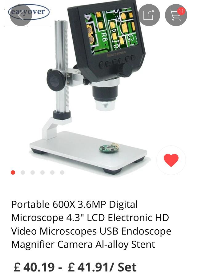

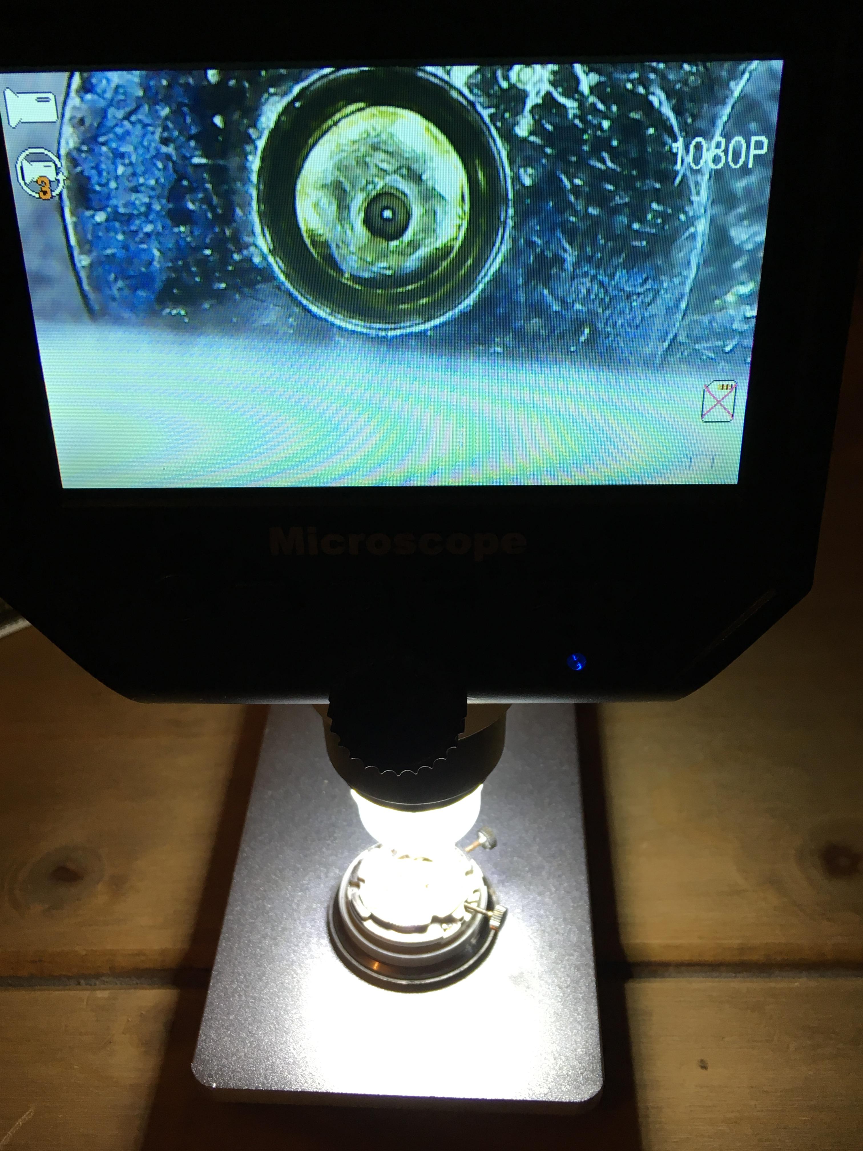

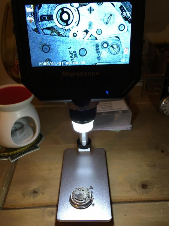

Well gents a couple of weeks ago I jumped on a post about microscopes, at the time I had just ordered from AliExpress one of these, a 600x mag with built in screen etc etc.
well it arrived and it’s great, it really is, the screen picture is very clear and the height of the screen and microscope are adjustable to the height where it is easy to manipulate hairsprings with tweezers in the vertical position. For jewel inspection etc you can lower it down to take advantage of that 600x mag and get a proper look at jewels and staffs etc etc.
all in  I’m very happy with this as it saves me having to have a laptop on the bench with leads etc getting in the way and also finding a program that works with the microscope.
This one accepts a memory card and will take stills and 1080p HD video aswell all in one unit so it’s ideal. It’s light and as you can see quite compact, it’s powered by its own internal battery that has a 6 hour life before charging is required , a plug ( albeit a Euro 2 pin one ) and a usb lead is included for charging purposes.
my only gripe is that you don’t seem to be able to turn off the led light when it’s switched on, but that is the only one so far. Well with the £40 and 3 week wait for it to arrive from China.
I got the exact same model recently to use for quick examinations, as it takes some time to set up my "proper" microscope as I want it. I find it a very useful bit of kit for this, although I don't use it for photos. It's also a lot easier to move around! I can't remember the exact price but it was less than £35 from a UK seller on Ebay, arrived within a few days. Listed as 600x 4.3" LCD 3.6MP.
Stephen
You won’t regret it mate, just been using mine on a job that I’d  wish I’d never taken on ( we all know that feeling I’m sure ) anyway, I quick update for you, I said on my last post that you can’t turn the LED light off, well I was wrong!! You can and you can adjust the brightness too, very handy, it’s on a control wheel on the side of the screen where you slot the SD card.
One thing I do do is place either a white bit of paper on the base, either that or a nice bit of green card that I use as a bench mat ( hobbycraft £2.50 for 20 A4 sheets ) this helps to emphasis what ever you are looking at making for a sharper image.

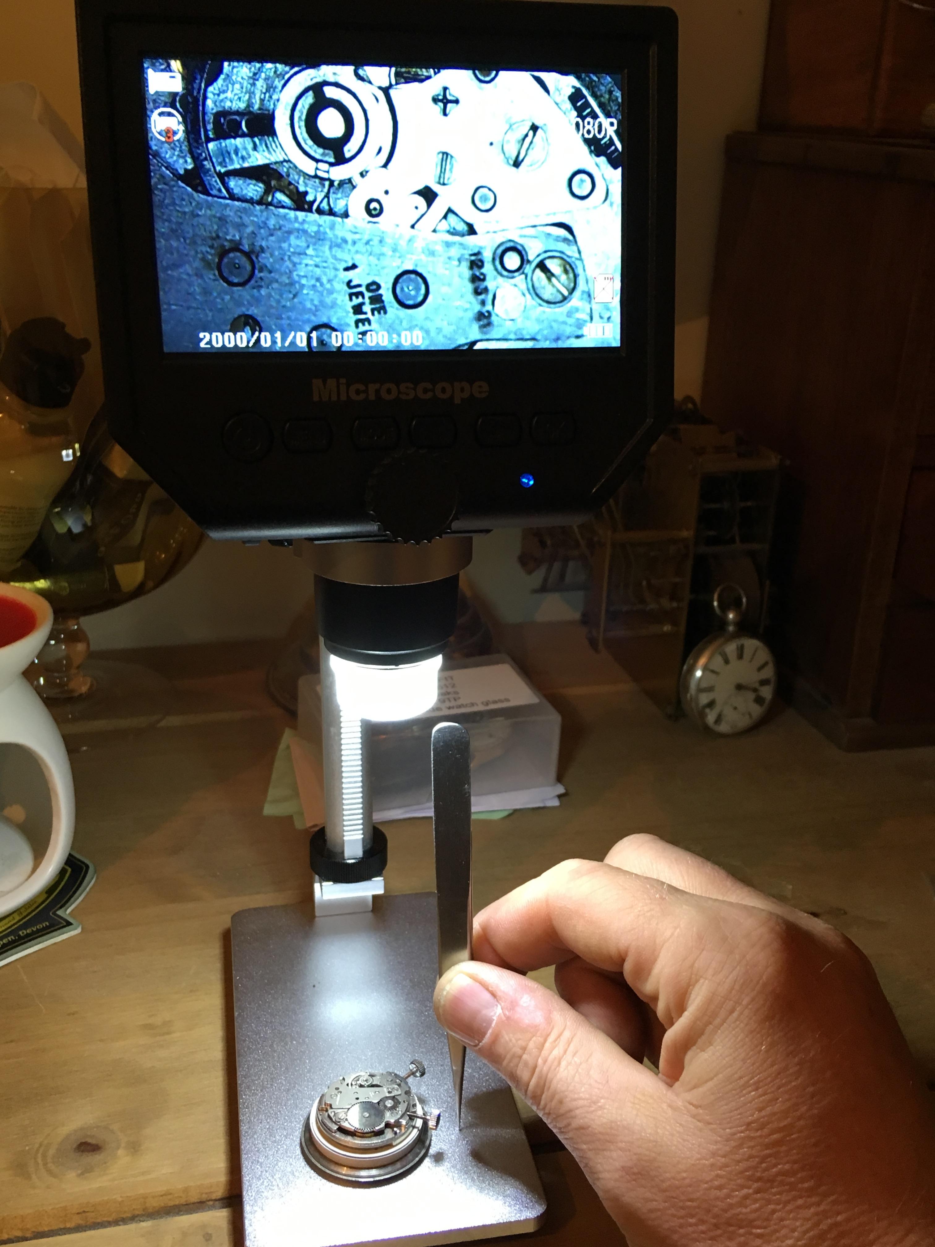

Yes that’s what I thought, they are are a long pair of tweezers there aswell, my dumonts have a lot of room which makes for easier work in hairsprings.
Great catch it seems.
Do you think it would be OK to use it for servicing a movement ?.. is there place enough
Another question I have is about the magnification ... is it possible to regulate it ?
Envoyé de mon Moto G (5) Plus en utilisant Tapatalk
To be fair guys nothing beats a  Loup and the eyeball but this can be used for servicing, the base is a bit slippy but attaching the aforementioned card will sort that, the camera cannot be angled so it’s vertical I’m afraid. The magnification is adjustable by moving it up or down, at the highest point it is more than acceptable to use for servicing.
