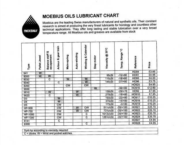

in watch repair we have an interesting problem related to technical documentation? In other words you can have a service guide from 20 years ago telling you how to lubricate a watch yet today the same company for a similar watch may have entirely different recommendations. So you will have people embracing the technical guide and not paying attention to when that technical guide was generated or whether there have been updates changes etc. This of course leads to confusions over lubrication and recommendations.
For instance let's look at Omega a  lubrication guide from 2006 and another one from 2018 let's see if there's any differences?
In 2006 the shelf life in the bottle is 2 years and 2 weeks in your oil cups. All the lubricants are synthetic except the 8200 for mainsprings and 8212 for automatic mainsprings. Both of these 8000 series lubricants are considered natural oils or have natural oils in them.
then the 2018 document shelf life is now 6 years and you need to change your oils every week. There no longer using any 8000 series lubricants. also they have a recommendation for lubrication storage of 22°C room temperature dark dry location.
then I'm attaching a lubrication technical data chart which does have the shelf life. you'll notice that synthetic lubricants are all 6 years and natural is between 2 and 3 years. This is probably why Omega's using 6 years they are using the recommendation from here.
then there is the more interesting question how long is lubricate going to function in the watch?
Moebius-Technical-Data-Chart.pdf
