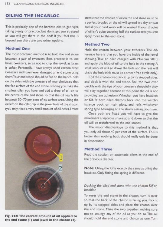

I’ve been following Mark’s course and he tells us that the oil should cover 30% of the end stone – that’s what I have been doing.
I have a book by Mark W. Wiles who states that the oil should be 50%-70%
What do you think?
His description isn't really clear. The oiled area should be around 60% of the surface when the jewels are assembled together.
With most Incablocs you'll need to oil the cap, then set the chaton on top. It's hard to predict what the end result will be without just doing it a bunch of times and getting a feel for what the initial oil spot will become once in contact with the hole jewel. There's no practical way of adding oil once assembled as the chimney is in the way (A Bergeon 1A auto oiler can do it*). No way to remove excess of course.
With Kif or old non-shock settings, assemble the jewels, oil the sink in the hole jewel, then insert a fine pin to carry the oil through to the cap. These are more forgiving as you can start small and add until it looks right.
*There's a risk with the auto oiler that some oil may touch the chimney and could possibly lead to oil wicking out of the jewel. It's also hard to be sure the tip is really clean. I got one in school but haven't used it in 20 years.
I found a BHI document online. It all depends whether the endstone has been treated with Epilame or not.
If treated, when assembled it should cover 2/3 of the diameter and if not treated it should cover ½ of the diameter when assembled.
The other two methods are as nickelsilver described, a fine pin and the 1A auto oiler.
Yep. I epilame them but didn't mention it as most folks don't. The end result is all that matters.
