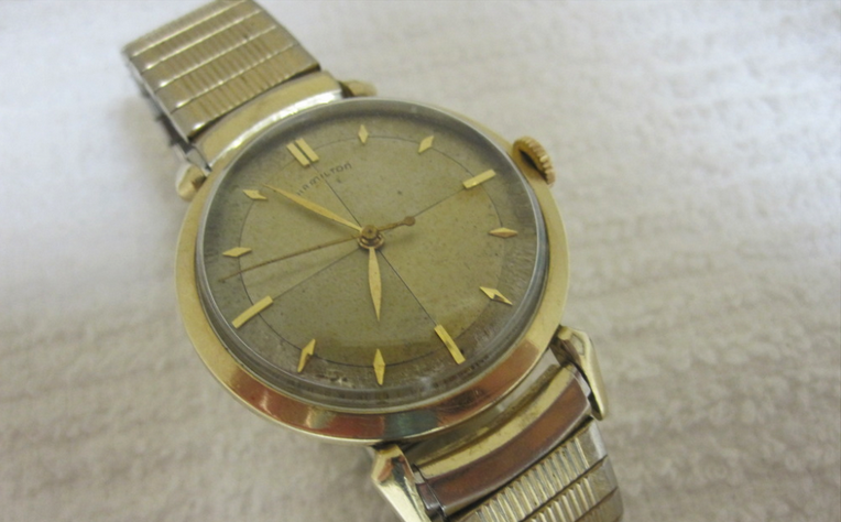

Probably been asked hear many times before but what are the do’s and dont’s   The reason for asking is I just restored a ladies 1930’s watch with a telephone dial that looks like a rolex dial. I used cotton buds soaked in window cleaner and rolled them over the face ( no rubbing) and i must say it came up like new. Tin hat now on
Just be careful with dials as some are transfers. If you mess with that type, you can end up in all sorts of trouble. If you can find a little test, spot that cannot be seen when the watch and its dial are cased that is where to start. Personally, in my days I would send it to someone who just repaired dials, these days it can be expensive.
Thanks for the reply, I was very cautious and only used warm water to start but that had little effect, I only payed £15 for her and felt she needed some tlc as she was In a terrible mess with her crystal broken and yellow, now she looks as an old girl once looked.
I have to say this forum has a wealth of info from some very talented people and I hope to learn a great deal.     It all started as a winter thing whilst there was little for me to do with my bees but I can now appreciate how addictive this watch stuff is.
Would you be kind enough to share some pics ?.. a newly cleaned dial is always nice
