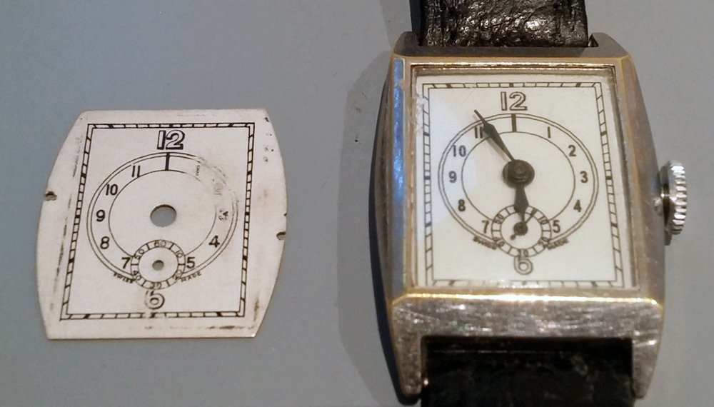

At another part of the spectrum, how about this one? I've silver-dipped it for about 10 minutes which has helped a bit. Anyone like to hazard a guess whether there's anything else that might work?
Roy
Tricky that one Roy. The print is starting to go so probably best left alone. I did do a similar one a while back by reprinting the dial using Adobe Indesign & an Epson P50 printer onto thick photo paper initially, but eventually used opaque white water slide paper onto the original brass dial as this supported the movement in the case (& forgot to take a picture of the final result). However the dial wasn't textured like yours, so may not work as well.20151005_175602r.jpg.d85e3be7ebe5a0e8a8138516f83db434.jpg
Great results..  I always seem to encounter dials with text/logo printed on top of the lacquer, and any attempt to clean it will damage the text. I don't really dare to touch dials anymore.
