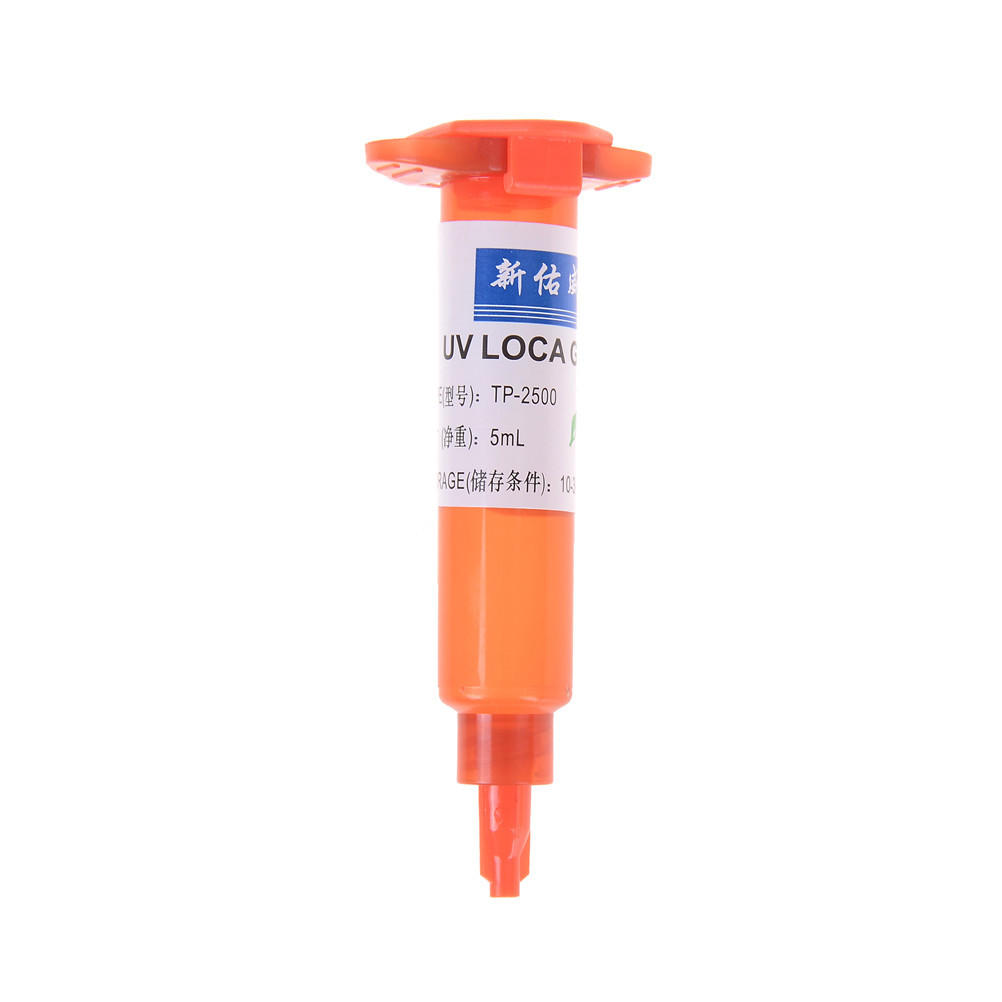

UV cure glues, like  LOCA Liquid Optical Clear Adhesive, often used for cellphone glass
https://www.ebay.co.uk/itm/TP-2500-UV-Glue-LOCA-Liquid-Optical-Clear-Adhesive-For-Cellphone-Glass-Lens-cu/283626728293?hash=item4209786b65:g:v2wAAOSwBChbXcWg
You would need a UV cure lamp for this, but there are lots of UV LED torches and UV cure nail polish devices to be had for a few dollars which will do the trick.
