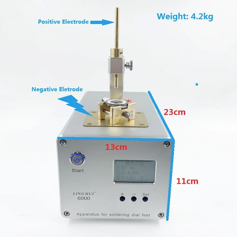

Does anyone have any experience with the type of dial feet soldering machine shown below? It’s from Aliexpress. It looks similar to (but also different from) the more commonly seen ones shown in this thread. I like that you can set the duration and current and it will then apply the exact current for the set amount of time. You can also weld broken mainspring bridles.
However, the Aliexpress one uses what appear to be steel feet in pre-cut sizes, not copper. I’m wondering if that is a requirement or if copper could be used instead. I would be worried about not being able to “bite” into the dial feet if using steel feet or not having the exact sized height to one of the supplied steel feet. Other than that the ease of use is appealing.

I've never used one, but what I can say is that in theory at lease, since it can spot weld steel, it should be able to spot weld copper, since steel has a higher (but broadly similar) melting point. Cooper melts around 1,084 C and carbon steels, somewhere in the range of 1,371-1,593 C. Stainless and other steels are a little higher. Also worth considering is that dials tend to be brass (except perhaps the really cheap ones, which are steel), so if it spot welds steel to brass, then spot welding copper to brass sounds possible.
You would probably need less current, or a shorter time to do copper vs steel feet to avoid over cooking them, thus possibly turning them into weld splatter.
That having been said, you would need to try it to be certain.
I was hoping someone else took the ~$250 gamble 🙂 I'll probably give it a pass as I don't think I'd have much luck returning it if it didn't, for some reason, work with copper wire.
EDIT: Actually, I just got a message back from one of the Aliexpress sellers saying they made a mistake and the feet are in fact copper, not steel. I wonder if maybe they are coated in tin or something? But that does make the device more tempting...

Probably nickel plated. Spot welded battery contact strips tend to be nickel plated, either steel, brass or copper, so with that in mind, I would say nickel plating is most likely, but silver, and possibly tin are maybe an option.
I suspect tin might oxidise or maybe even evaporate at the temperatures involved, since it would form a relatively thin layer on a very rapidly heated substrate. Tin's evaporation point (2602 °C) is a little lower than nickel (2730°C), but tin is more inclined to oxidise than nickel, and tin oxide might not bond well. Of course tin plated steel is pretty common too, since that is what most steel "tin cans" are made of, and some of those are indeed welded.

That link isn't coming up for me. I ended up ordering one of the units earlier today (along with a bunch of other stuff, I'll have to post in the Quality Chinese Tools thread once I get some hands on experience with the haul) and the one I got was this one, a Ling Hui 6000. Since your mentor had good success, hopefully I managed to snag the same one 🤞
