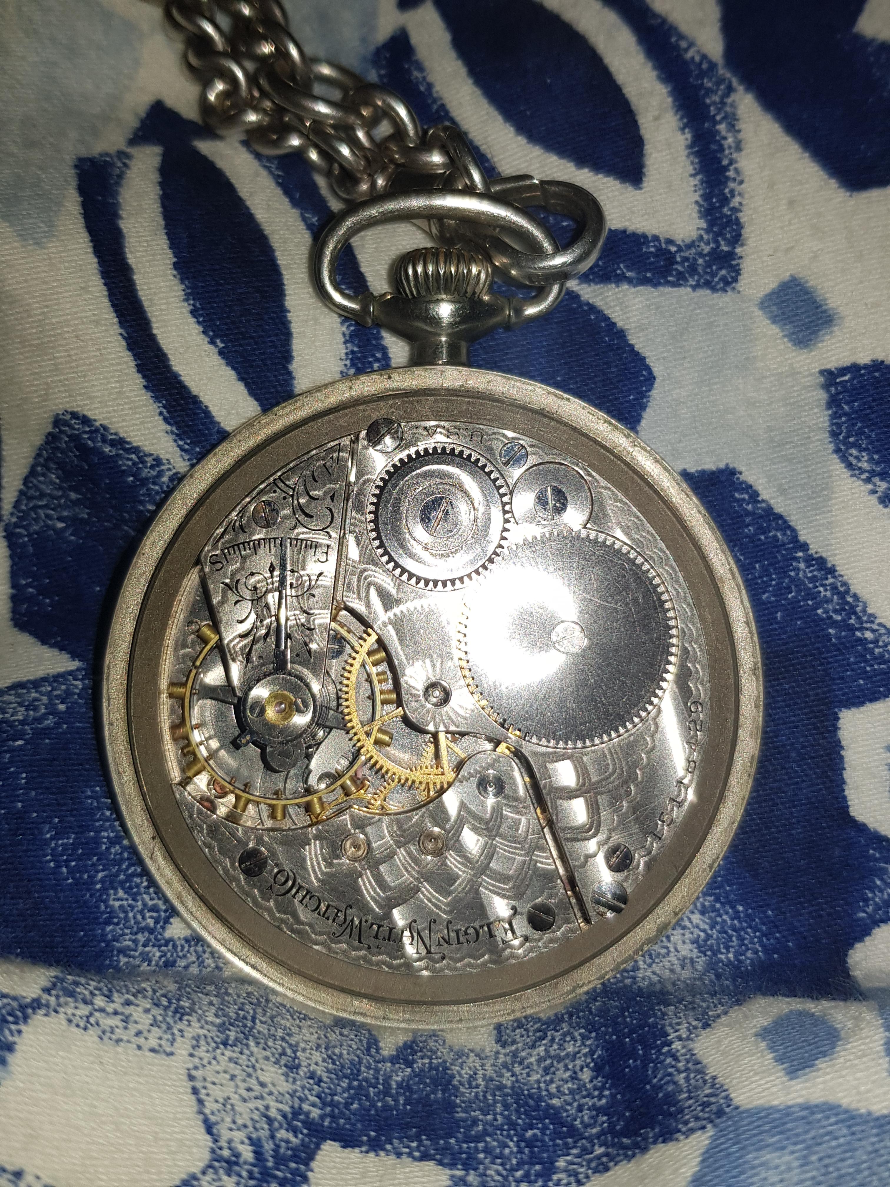

I own an old Elgin pocket watch and am trying to remove the screws to the main barrel and the stem but they are extremely tight to the point that I'm finding it impossible to remove them - even with a lot of force and pressure.
I do not want to damage my watch as it is an antique but at the same time do not want to send it to a professional if I can get it undone myself.
I've tried different sized screwdrivers to no avail, and understanding that it is a no-no, I've even used a cotton swab to apply WD-40 directly to the screw. I do not know if the screw has rusted or not - the watch itself is immaculate so I see no reason for the screws alone to rust.
Does anybody have experience removing stuck screws from their watches or pocket watches? These things are absolutely tiny!

I've also attached an image of the movement.
The topmost three screws (excluding the screw attaching the movement to the case) are all stuck. They are a nice blued steel colour.
One of these screws will be a reverse thread or are all of the screws tight. If they are all tight then maybe someone has used loctite.

I've tested all screws and they are all sufficiently loose enough to undo them except for the three stated. I've tried to reverse the three but am worried I will either tighten them more or break something. I'm reuploaded the image with the screws in particular circled in red and the good ones in green. I really hope that loctite is not the case...
The one on the small wheel ( crown wheel) is reverse threaded, opens in anticlock direction.
I would mix WD 40 and the oil you got to, apply generously and give at least 24hrs for the solution to penetrate.

Hi try applying the tip of a soldering iron to the two stuck screw heads for a wee while to warm up the screws If they are just stuck the heat will expand the screw hopefully breaking its hold be it loctite or rust.   As mentioned the crown wheel screw will be a left hand thread  and will undo clockwise, use a little wd40 on the screw but be sure to clean everything. and re lubricate.

That is a good practice with screws that work normally, but being able to impart more torque to a stuck screw it is not good, because it will make the screw to snap under the head. If it doesn't leave with normal force the something else must be done.
I have had this problem and loctight was the cause. I did exactly what watch weasel has suggested. I put the cleaned tip of a hot soldering iron on the screw head for 30 seconds - using the correct width screwdriver removed the screw. To see if this is your issue I would start with the bridge screw as you know it will be a standard thread and undo counter clockwise. If someone has used stud loc you will need t o heat for 60 seconds. Look for green deposits. Screw loc is pink, thread loc is red.

Edit: Yep! The bridge screw was indeed reverse threaded and applying a little force it came right out. I won't be tightening it as much as the previous owner. Only two to go tomorrow!

Update: I've gotten two of the three screws out now - the stem screw is still not budging. I have tried to use the tip of a soldering iron to heat it for 60 seconds with zero success. Will buy some penetrating oil tomorrow and give it a go. I'm starting to think this screw isn't locked but rusted :mellow:
I've bought some oil, applied it and waited a day and still nothing is working. I guess the last chance is mixing it with WD-40. Anybody have any other crazy ideas? I may just have to go get it serviced at this point...
