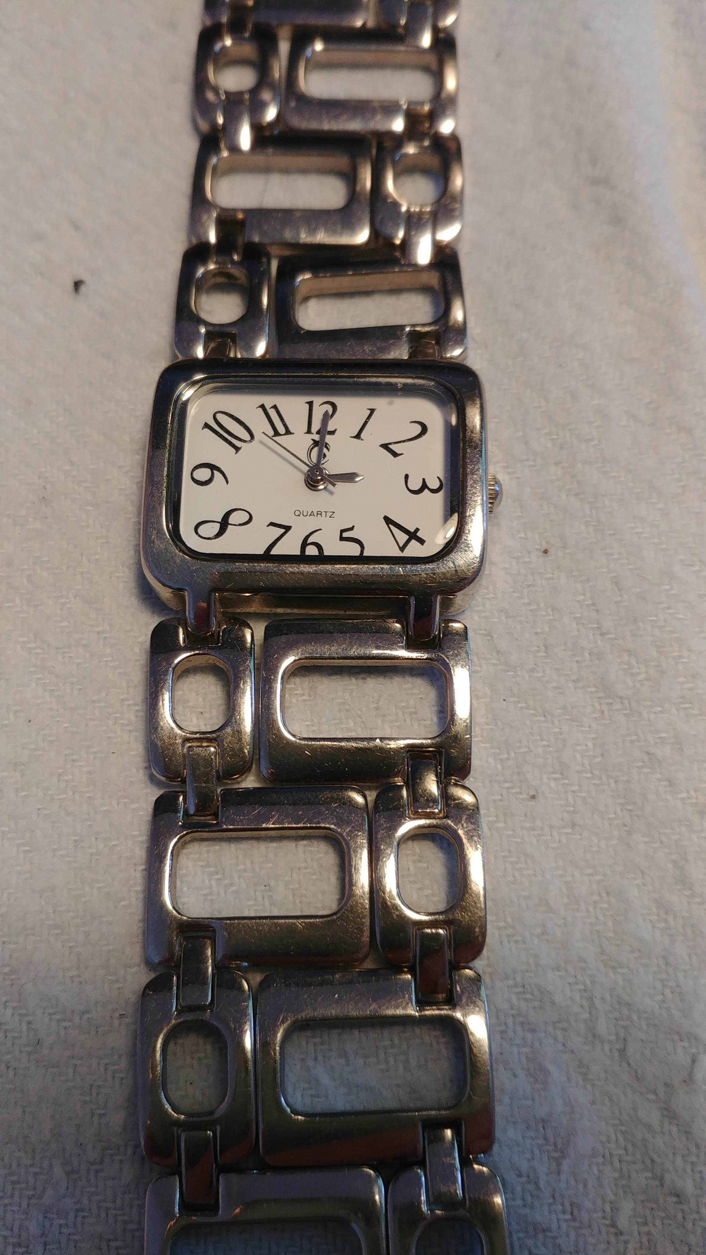

Hi there watch repair experts and fans! My first time here so please be gentle with me It concerns the ladies watch you see in the pics and, in particular, its rather unusual metal bracelet strap. I want to make the strap a few links shorter. Normally with metal bracelets it is, of course, all about pushing out the pins, taking out the bits of the bracelet you don't need and then putting it all back together. But THIS one has a weird-looking two-section bracelet which, as far as I can see, is held together by very small screws (?) from each side and no pins involved. Obviously I am wondering what to do to get the pins/screws out. Another thing of course i that I will have to take one link from either side of the bracelet. Anyone seen a bracelet like this before. HOW to do this adjustment?? I hope you can see what you need to in these photos.
