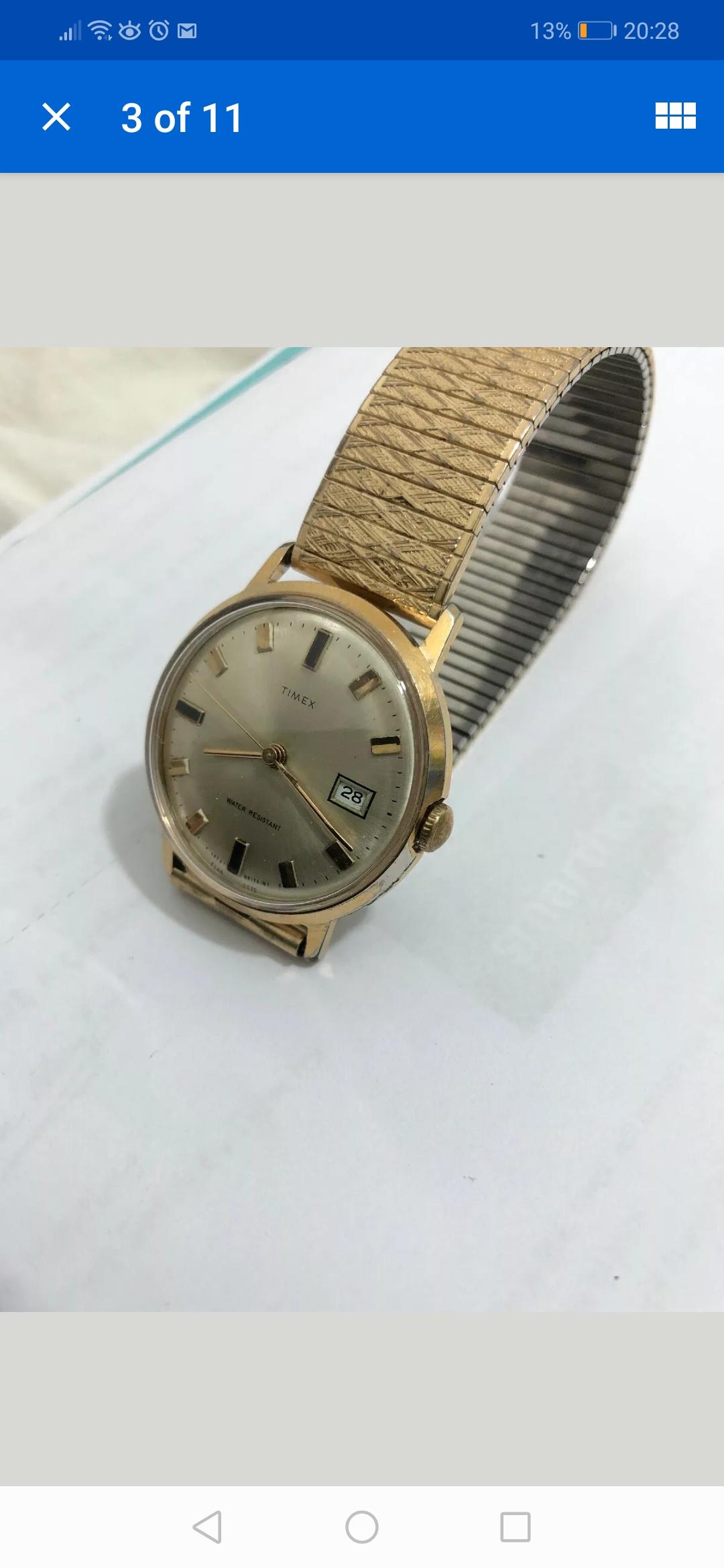

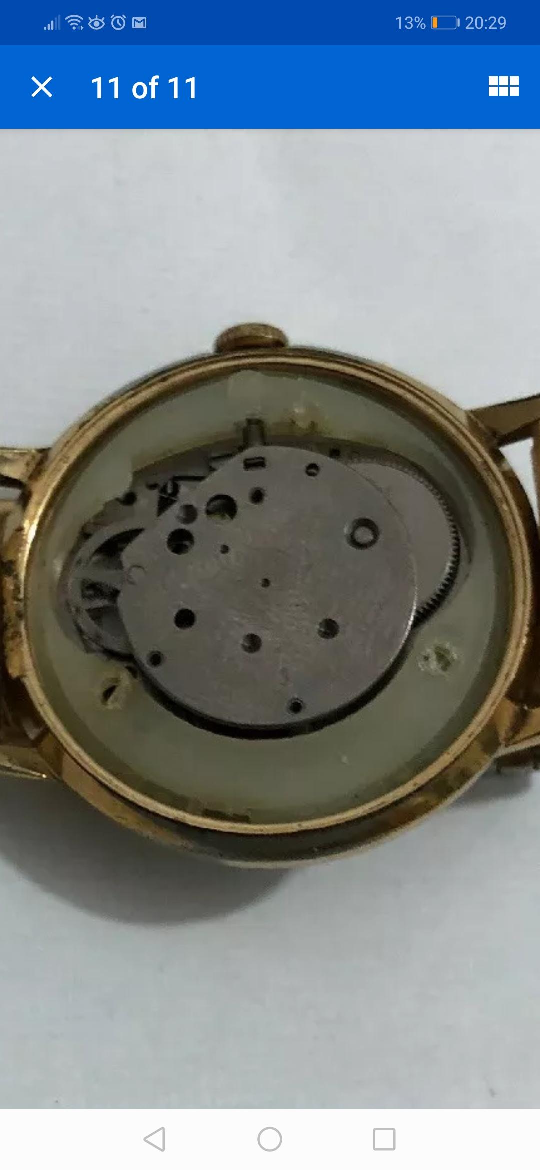

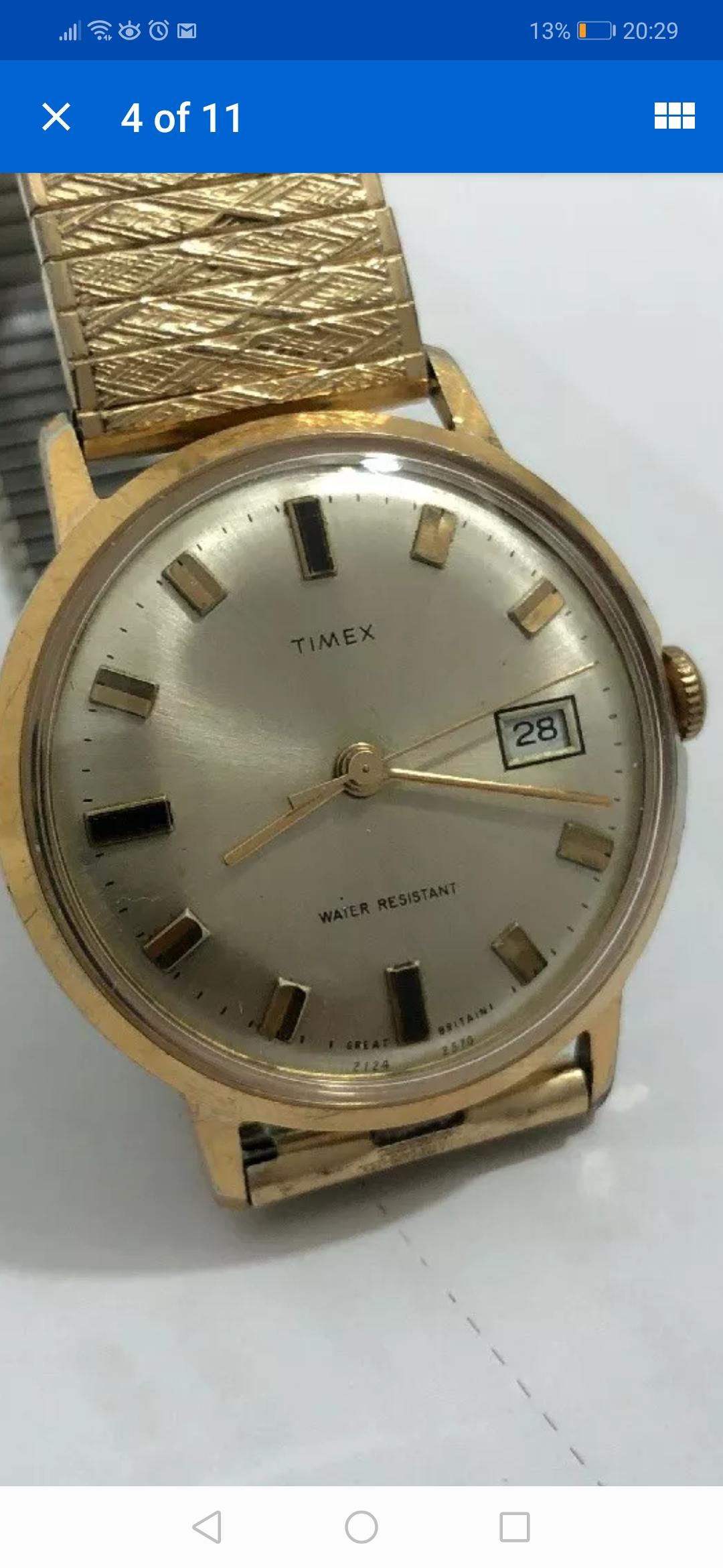

Instead of starting a new post hope it's OK to add to this one. I took delivery of a vintage Timex Marlin 1970 that I purchased on eBay. The stem seems to jiggle slightly even when it's pushed in. I also noticed that when the watch is upside down the second hand stopped ticking, I jiggle the stem and it starts ticking again. Any ideas what the problem could be. I did some research and what I read was that it could be the balance wheel to do with the second hand and the setting lever plate to do with the stem. It's such a lovely watch and ticking as I type, but for all I know it could stop working again. Is it worth keeping or would it be best to contact seller for refund.  Part of me wants to keep the watch. The champagne sunburst dial looks amazing. But the watch won't be any good if replacement parts are going to cost a fortune. Cheers
