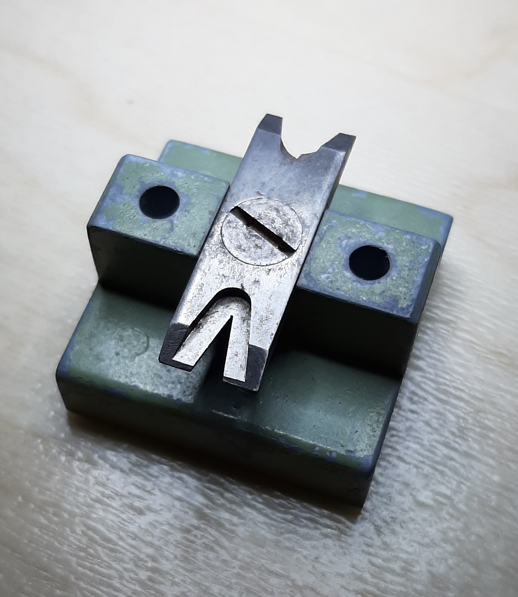

  3. Hello everyone, isn't it a great skill in its own right to be able to make precision watchmaking tools. This little beauty is a balance poising tool with a sliding base and spring loaded vice to hold balance wheel in different position while you remove material from the balance wheel underside or rim side. The hand held cutter is sharpened by hand. I have used it on pocket watch and vintage wrist watch to make new balance out of scrap parts. But only once combined with hairsping vibrating tool for 18000 bph watches. A lot of fiddly work, but can be done VID_20201129_094512.mp4

  4. Ok I didn't make a 3D model or anything, but laid out the most important part, the plate. The back piece is 40mm x40mm, the arm can be anything hinged any way just so that it comes down over the balance rim. The support piece for the inside of the rim can also be anything, on the old tools they were V shaped and pressed into a hole, on my friends it's a simple pin that has a notch filed in it. The notch/V permits whatever bit of screw that is sticking out inside the rim to be unharmed when working on it. The threaded holes for the pins are a 2mm thread, but anything near that would be fine. You can see in the pics that there were different ways to hinge the arm, either with a hole drilled all the way through the 40mm back plate and the arm recessed in, or with pressed in hinges, both would have been a test of the student's patience, not becuase they are necessary. A simple hinge from a hobby store for dollhouse work or whatever is fine. I don't know what the pin sticking out the front of the tool is for. They all have it, but?
