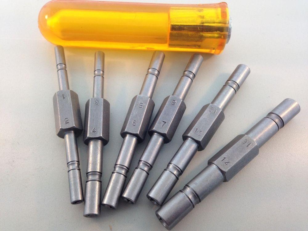

  18. they are about £20 a set the do get more expensive like the ones added by Old Hippy they are the best. They are the ones supplied with the Ollie Baker mainspring winder.
