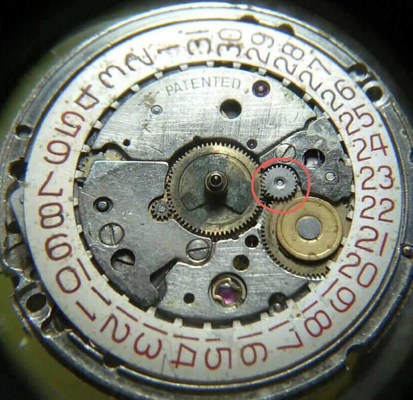

  3. Yes, I have been using this great topic below to service a 7750 and there is no washer included either:
    2 points
  4. I have 3 different tech guides for the 7750 and not 1 has it included. I have added the day function to many 7750s and have never had an issue. The movements with the day function that ive worked on did not have it either. Sent from my SM-G950U using Tapatalk
    2 points

  11. That's odd, all the ones with day function I have come across, 3 from Bulova, 2 from Victorinox, and 3 from Mido all have the dial washer.
