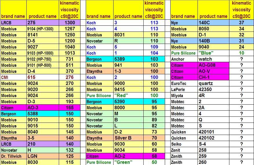

Some years ago there was a project at another forum to compile a viscosity chart containing all of the currently available lubricants. It wasn't entirely successful but did produce some useful data. Note that the use of the silicone oils on this chart is very controversial, particularly as being "pure" silicone it is questionable whether or not they spread over time. There's no data available on them other than what is on the label, which isn't much. Only a couple supply houses carry them.

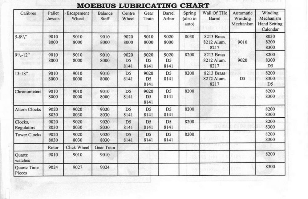

Greetings, gents. I recently made the change from my old Nye oils to some Moebius. Specifically, 9010 and 9415. I have been using 8200 for mainsprings for years. Anyway, the 9010 seems fine in most ways that I can visually figure, but it is a bit frustrating getting it to "stick" to the flat side of cap jewels. My old Nye used to take a couple of touches before it would release from my cheap oiler, but the 9010 takes numerous attempts. Sometimes I have to clean jewels off in naptha before I can get the oil to release.  Is it a surface tension thing, like what calls for epilame treatment? My eyes go haywire as I try to get the oil on the stone. Suggestions? Many thanks ahead of time. Cheers.
MrR
  • 4 weeks later...
If by "910" you mean Moebius 9010 I believe all you otherwise might want to have is a lubricant for the pallet impulse faces. I normally use Moebius 9415 but more often these days I've been using Dr. Tillwich Watch Oil 1-3 (less expensive) with good results. Anyway, I'm a hobbyist using extremely small volumes so price isn't all that important to me.
I believe I read somewhere @nickelsilver (professional) mentioned you can use 9010 for the pallets as well, but perhaps that was provided the pallets had been treated with FixoDrop!? Can't quite remember, but if that's the case (FixoDrop needed) it would be the most expensive option (FixoDrop doesn't come cheap).

7 hours ago, Tiny said:
I think I can use 9010 for the pallet
I think so too. Anyway, it would be interesting to know for sure if FixoDrop would be a prerequisite? I'd suspect 9010 to work truly well, but the big question is for how long. It's so thin that I fear it may wear out (spread) pretty quickly. We'll see if @nickelsilver or some other pro can chime in and enlighten us. That would be great!

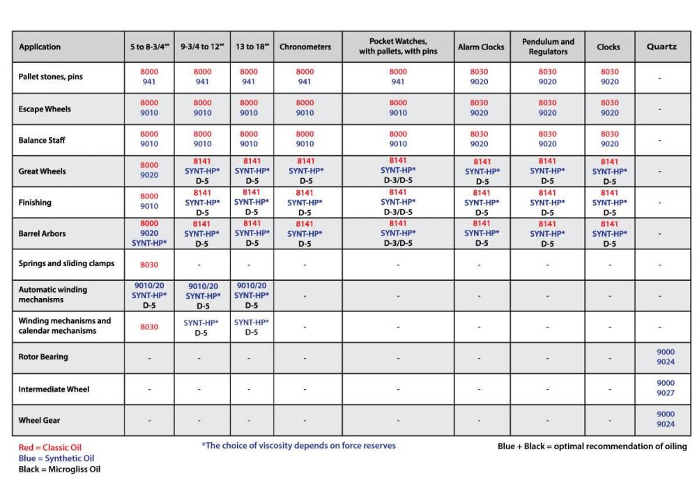

Your chart is rather old it would be better to get a new one. You can download the newer chart and Also you should get the product catalog at the link below. Yes you can use 9010 but 9415 would be better. Which is missing on your chart because of its age.

If you're not on a budget, put some Moebius 9415 pallet stone oil on the list as well. It still would be an advantage to apply FixoDrop to the pallet stone impulse surfaces. However, I believe it would be a bad idea to soak the entire pallet fork in FixoDrop. If you look around you'll find plenty of interesting information about FixoDrop.
