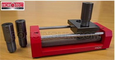

Just a quick review of the “Horotec Screwdriver sharper”  I have always tried to keep my screwdrivers sharp & in good condition but found that despite this I was still (on occasions) getting slips. Some of it this may well be my method of handling them but also I noticed that many pro,s use screwdrivers that have different shaped blades. After some research I found that this is because many use a “Horotec Screwdriver sharper” (or equivalent) but unfortunately the cost does carry a prohibitive price of £175. However feeling plush last month I purchased one & after waiting a few weeks for it to be in stock, today I have started to use my re-shaped screwdrivers.
My initial impression is that this tool offers a very quick method of shaping/reshaping your screwdrivers & it really does give them a round shape not the usual V shape.  see below:
This round shape defiantly gives more stability on the screw. There is however a few issues to be aware of.
First: It is adjustable for the different screwdriver blade widths via altering the distance between the two rollers. As yet I am not sure if this is necessary or at least a critical adjustment as the final de-burring & tip flattening of the screwdriver blade seems to be more than adequate to make a good stable tight fit on the screw head.
Secondly:The tool is supplied with three holders for the different screwdriver shaft diameters (4.3mm, 4.8mm,5.3mm) This works great for my most used screwdrivers which are Horotech. However my lager screwdrivers (from 1.6mm) are Swiss A*F & their shaft diameters is too large. So for now I will still use these with the old shaped blades but eventually I will change them for Horotech.
Finally: I suspect I will still also need conventional shaped screw drivers as well so this is pricey for an amateur but …… I do like tools.
Del
