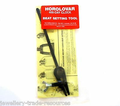

  11. The only way is re-gilding. Gold paint will make it look odd against the movement. We only need a photo of the back plate to id it. Get one of these to help you to set it in beat when it comes to clean and oil the movement. Because of its long handle it gives you better precision to enable you set the clock in beat.
