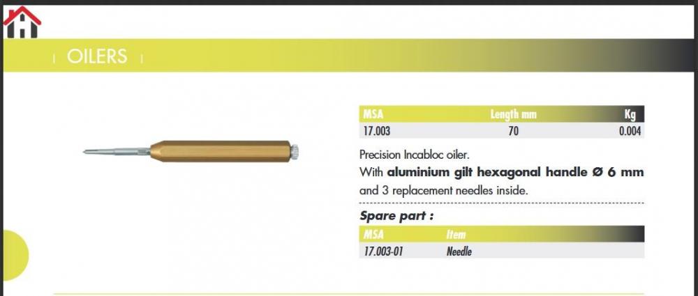

So, more than a year later I bought this "golden tool" and used it on a couple of diafix cap jewels (Orient movement). I first considered using my Bergeon 1A auto oiler. However, the jewel hole for the escape wheel pivot was too small for the auto oiler, so then I remembered your post.
As I didn’t know how much oil to apply, I used my smallest oiler and placed the drop right on the jewel hole (concave side, of course, as the other side has the cap jewel). I then poked the oil down to the cap jewel and it spread out really nicely. However, the amount of oil wasn’t enough, so I placed another drop on the hole. To my surprise, the capillary force that had already been established automatically drew the oil to the cap jewel making the circle the desired size.
So, basically just wanted to thank you again for tip and the instruction @nickelsilver. Much appreciated!

I've never had a need for these. Just leaving the oil on the concave space and assembling always worked for me. The oil always get sucked onto the cap jewel side. Just make sure the pivot finds its way into the hole smoothly (usually does) and not be allowed to wiggle around and spread the oil all over before connecting with the cap jewel.
It works, but when you check the oil quantity and it's lacking it's more of a pain than using a pin. Or you leave it lacking. When I was working in a trade shop while in school I did the way you describe but I was getting 10 USD for a manual wind, 11 for automatic, in 1998, not 1950 hahaha. Had to make some concessions.
The boss cleaned assembled, barrel out (opened but spring in), then pulled the balance and ran through a second machine with "lube" in the final rinse.
I skipped the second machine, disassembled all the movement (he'd leave cap jewels assembled too), did train freedom check etc. I didn't have one comeback. I'm sure the time he saved with the cut rate measures cost him more in his comebacks.
Not trying not harangue, it's an old school technique you describe, but pushing through with a pin is a tiny extra step to ensure proper oiling to get it on the cap correctly before assembling.
Well if that should happen I would take the bridge off and apply more. I dont remember that ever happening to me though. I always apply a big o heap. Hard to imagine the space between the jewels ever running out for how much ever you can fit in the concave before running off to the side.
