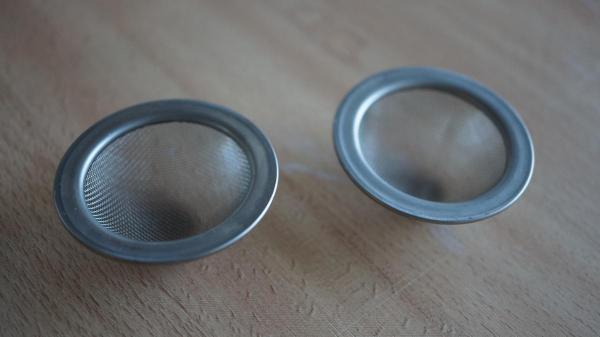

I use some small stainless steel cups . A little like a eggcup but bigger . Maybe for bigger eggs :) . In them i have a tea strainer that i have take apart .Fit is perfect inside the cup . I lay my parts like jewels and other small parts that are easy to misplace .
post-644-0-66990000-1433149500_thumb.jpgpost-644-0-58923100-1433149430_thumb.jpgpost-644-0-98191000-1433149445_thumb.jpg
