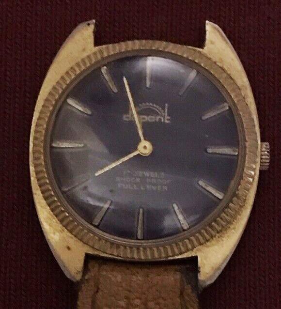

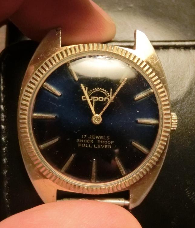

An S T Dupont - Paris - "Dupont" 17 Jewel small dress watch is on its way. Possibly gold plated, but.. who knows.
This is another 404 club candidate. Described as a non runner,  I have no idea what ails it, nor what makes it run, but the sub 404 club price means that finding this out wont be too fiscally painful.
The listing also states "..Japanese made with stainless steel back, shock proof and Full Lever movement foreign...", but this is after all an ebay listing, so some, all, or indeed none of this may be true. If true, then possibly a Seiko or Citizen movement. Time will tell.

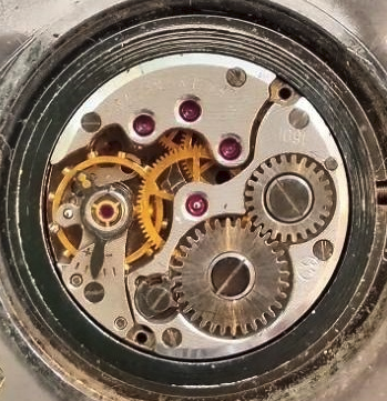

EDIT: I found a couple of steel/white metal cased versions, and this might be what is inside. Can anybody identify the movement from my terrible picture? It does look pretty familiar. Maybe a Bostok 2605
EDIT2: http://www.ranfft.de/ appears to be down at the moment, so my ability to check and compare is limited.

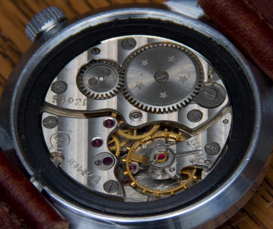

I’m no expert Andy but the B like symbol does look like the Bostock/Vostock logo.
Tom
I found a slightly better image from a different Dupont watch, which looks more like what you've got there to my eye:
Not sure if that's helpful--I can't read much on it beyond the serial number.
Edit: ah hah! I thought that said 1601. From here, listed as a "Tchaïka 1601".
And I feel like I've seen that hallmark before...yes! Here at Watchuseek forums, listed as a Soviet era Vostock
And here is some more info on a Chaika 1601A movement, which looks right to me.

Thanks. I thought it looked very familiar. The one I purchased hasn't arrived yet, but I'm pretty sure you have nailed the identification of the movement. Better still, I have some parts movements, so if there are any problems with it, I should have the parts.
Its interesting that a high end French jewellery chain should go for a USSR produced movement and not, for example a Lip or similar.  I guess they used them for the same reason that Sekonda in the UK did. They were relatively inexpensive but also relatively well made.
Speaking of Lip, the Chaika 1601/1601a and the Zim 2602 and the Bostok all appear to be derived from the Lip R-26
There is a discussion about this here -> https://www.watchuseek.com/threads/lip-r26-vs-pobeda.12673/

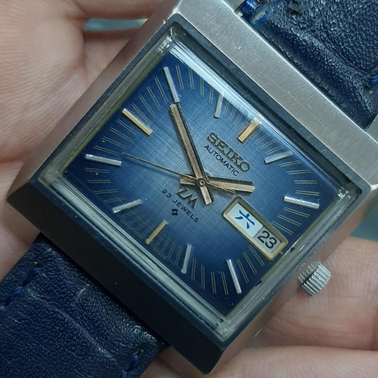

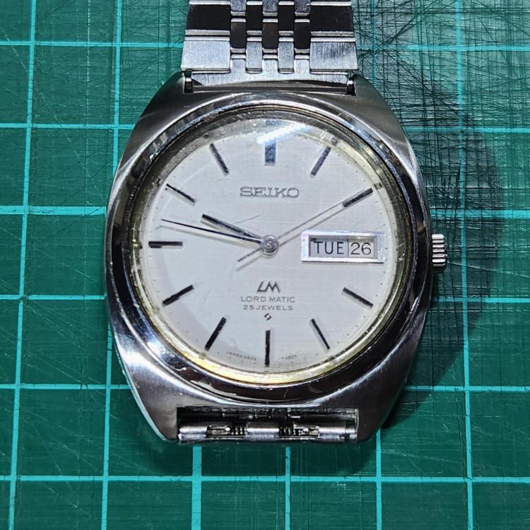

 Bought this today, liked the dial, have about ten Seiko LM now and be collecting more.
https://esam.ir/item/27209610/سیکو-ال-ام?idPurPayItem=4262277
Swiss watch this good of guality is expensive.
If you guys don't have one, you should look into Lord matic, probably end up buying yourself one.
pix in the following post
Edited by Nucejoe
I just got my first Lordmatic earlier this month. It was a non-runner from Japan. The movement lock ring was jammed so tight that I had a hard time getting it out. The previous watchmaker must have given up because the all the screws looked pristine.
The second wheel jewel was broken and by some miracle, I found an exact jewel in my collection of scrap jewels.
It's running again, although the positional variation in the amplitude and rate is not perfect.

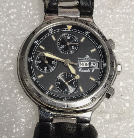

I seem to be on a chronograph binge. I just picked up two on eBay.  A Baume & Mercier formula S image.png.875c205eb089289f5baec4238960cc64.png

I especially like the look of this one, perhaps you could change out the bracelet for a grey metal one to match the dial (titanium/gun-metal etc)? I have a love-hate relationship with chronographs, I think they look great, but on my wrist they are too complicated for a quick glance to check the time, so for me they are impractical unless just for aesthetic value. I have tried to get used to them as, like I said, I really like the look of them, but just cant get over the mental hurdle and I'm a little jealous of those who can wear them as a daily driver.... we all have our crosses to bare...😄

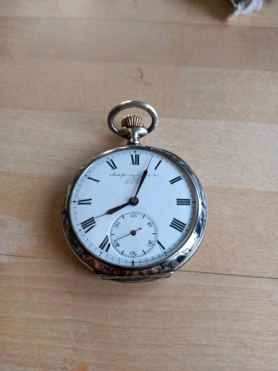

With some luck, this Tula-silver PW should arrive next week. Seller says it runs in all positions. Havila movement "B".
Curious & an exciting project ....... ☺️
Sellers pictures;
Havila movement "B";
https://watch-movements.eu/blog/en/2020/03/05/havila-a-nearly-unknown-movement-manufacturer/

A beautiful timepiece as always. I envy your ability to find these "gems". I'm not into pocket watches, but nevertheless. Oh BTW, really clever to ask the seller if it runs in all positions. If it doesn't run in a certain position it likely has a broken staff, and broken staff on these old watches is of course very common.

I finally got a chance to take a quick look at this watch.
CleanedDialSide.thumb.jpg.9a4b7482102b99a11643fa324f45c47b.jpgA
What wasn't apparent from the listing is that it has a very nice deep blue dial, which of course the camera entirely fails to do justice to.
It is indeed a Chaika 1601A furthermore it actually runs. It keeps time, but the amplitude is low.
It is in dire need of a service, and possibly a mainspring.
I'm pretty sure I have a few other Chaika 1601A scrap movements in my box of USSR spares, so I should have everything I need to get it running well.
I'm not sure if the case is gold plated or not. Quite a few of the USSR watches I have, are.  I suspect if it is GP, it has barely a sniff of gold on it.  I'm very pleased with it, especially since it is a 404 club watch.
