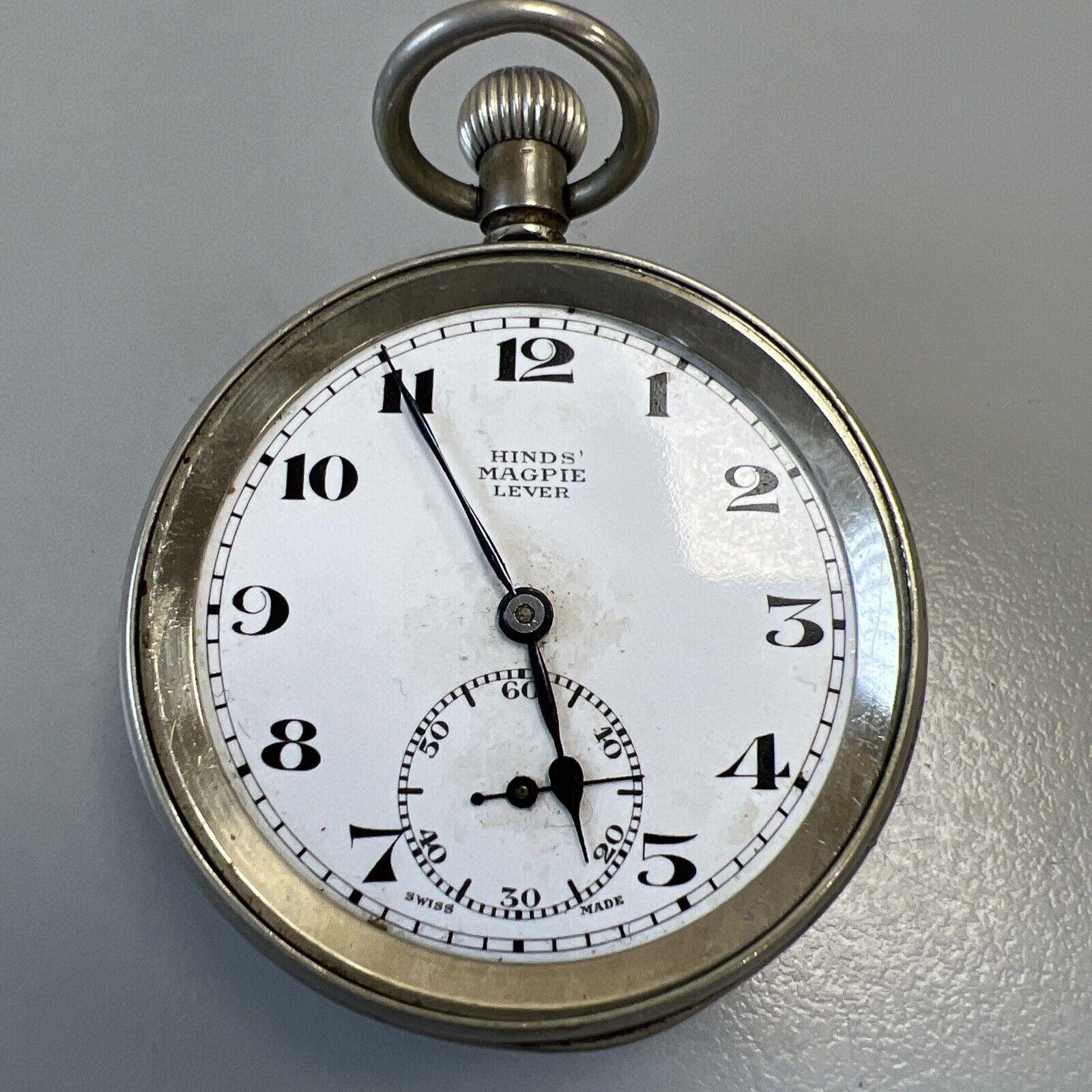

Something a little more traditional this time. A "Hinds Magpie" nickel cased pocket watch.
Not sure of the age, possibly late 1920s or later.
AsPurchased3-l1600.thumb.jpg.956c7066dd4de957f02befb7060178cb.jpgAsPurchased3-l1600.thumb.jpg.956c7066dd4de957f02befb7060178cb.jpg
I might be able to be a little more precise once I know what is inside it. A non runner, but the listing was a little vague, so I have no idea what ails it. Needs a crystal too, but other than that it looks to be in good cosmetic condition.

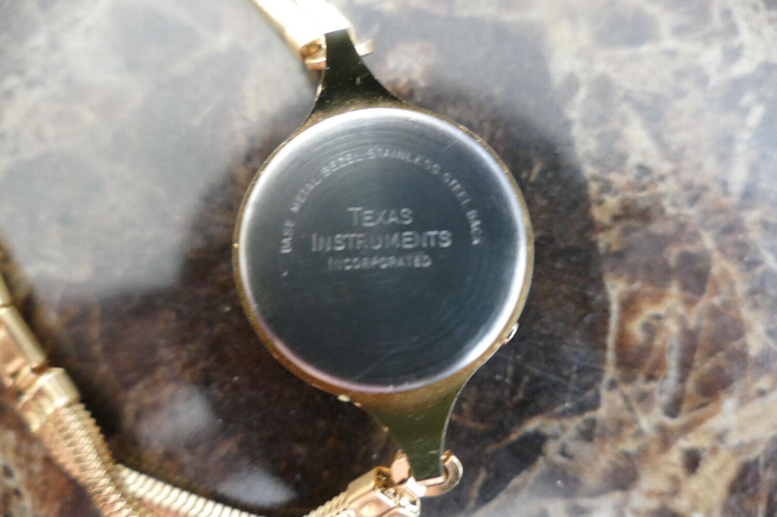

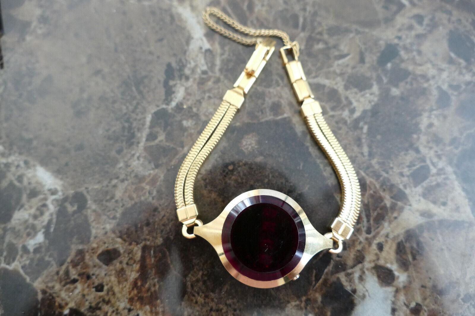

Another trinket for the 404 club. This time in the form of a Texas Instruments LED watch from the mid 1970s
This one is a less common ladies model, and looks to be in pristine cosmetic condition.
The module looks to be relatively corrosion free, so there is a reasonable chance that I can get it working without having to resort to too much brain surgery.
At 0.99p its no great loss if it does prove unfixable.

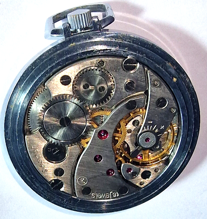

A Molnija (Молния) 15 jewel October Revolution (Октябрьская революция) USSR era pocket watch is on its way to the 404 club.
The Molnija 36xx movements are basically a copy of a Cortébert movement used in Swiss watches from around 1940.
In a working condition, these are fairly popular, but this one appears to be missing the top balance jewel, as well as the bow. It was described as "Balance is not working", so the price was a bargain bin £1.99
Almost certainly needs the balance jewel, and may need a balance staff too. I think I have a scrap movement with the jewel, but it too needs the balance staff, so I may have to go hunting for some of those.
I found a complete movement for this project. The seller claims it is working, and as you can see it has a higher standard of finish, so hopefully the finished article will be presentable. It even appears to have a bow which may work to replace the one that is missing. If not, I do have quite a good stash of bows so I should be able to come up with something. I can always fabricate one if necessary.
One final bonus was that it was cheaper than a balance staff, and saves me the chore of replacing that.

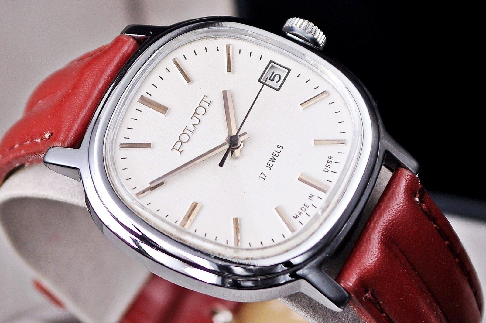

Another 0.99 pence unwisely spent on a Soviet era basket case. This time a Poljot cal 2614.2H based Sekonda with signs of having endured a hard life. There appears to be rust on the hands, and some flaking of the dial. I am quietly confident that if the rust is superficial, then there is a pretty good chance of this running without too much effort.
Here are a couple of  much nicer examples, without the optional crusties.

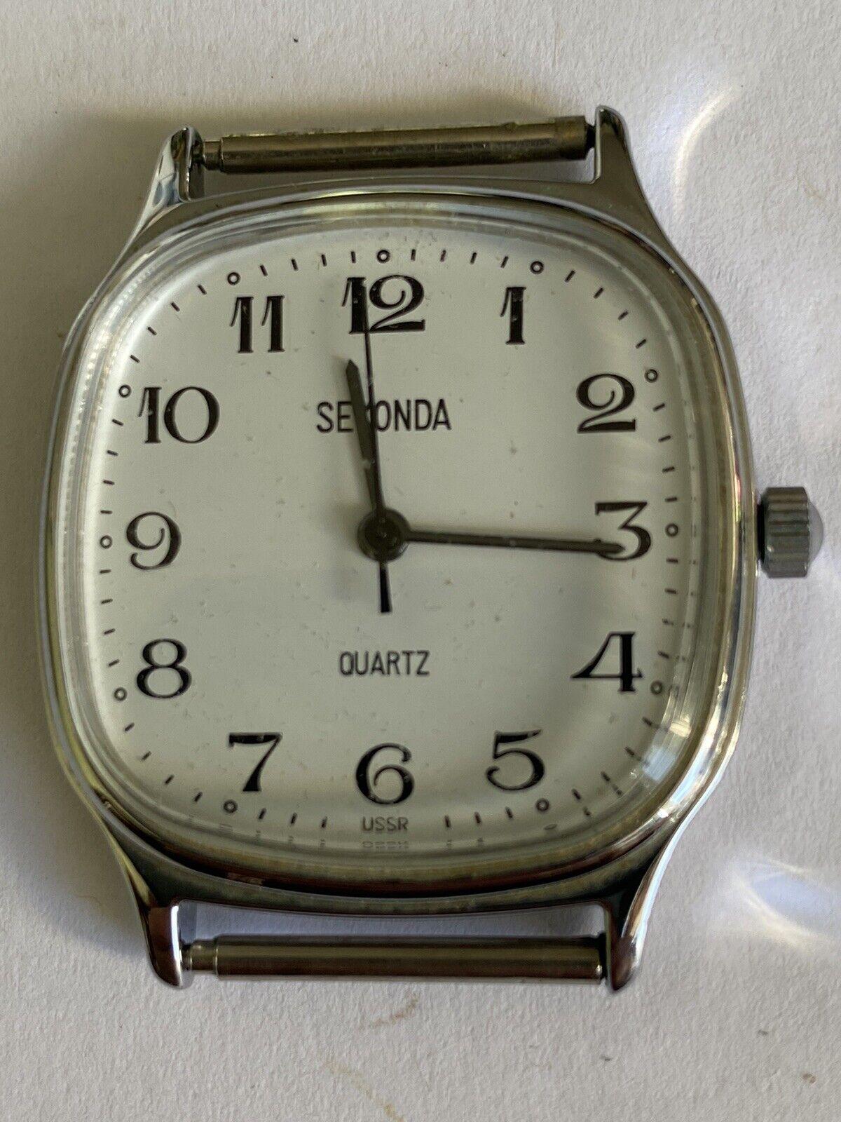

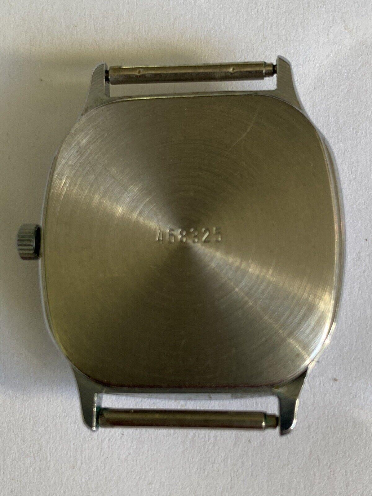

On 11/2/2023 at 5:59 PM, oldhippy said:
Russian Sekonda gold plated 😂
I'm a bit cynical about how much gold there might be, but some of the USSR era watches are stamped Au10
Whether they *actually* are plated with 10 microns of gold, or perhaps someone just had a handy Au10 stamper is another matter, however since these watches were probably conceived for the communist elite and the export market, they may well have a snifter of gold on them. 10 micron plating is such an insignificant amount that it probably adds less than £4.04 to their value. A micron is 0.001 of a millimetre.
EDIT: Just for the record, anything plated with less than a micron of plating is considered "flashed" with gold, and this typically is done on items where there will be very little wear. On the other hand anything with one micron or more is considered to be plated. The thicker the plating, the longer it will typically last.
Watches, since they experience high wear should be plated with 10 microns or more (40 microns or more for a quality piece). Obviously this does not translate to very much gold by weight, so a gold plated watch is not really worth significantly more than an equivalent un-plated item, except of course for the aesthetic value of the gold.
A 9ct or more  gold watch is worth at least its weight in gold at the percentage rate for the particular carat value, or to be more accurate,  worth the weight of those parts of the watch that are actually made of gold.
Unfortunately this of course means that a lot of historically interesting watches have been destroyed to recover the gold from their cases. In summary, a USSR era Raketa, Pljot etc. with Au10 plating is not going to contribute significantly to your pension fund, unless it is a particularly rare or interesting watch, and I don't think our 404 club candidates quite fall into that category unfortunately.

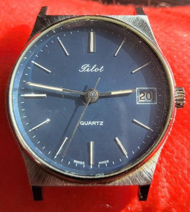

Early no name Swiss quartz blue dialled "Pilot".
I have no idea what potential horrors are lurking in side. Hopefully it will contain some interesting early quartz mechanism and not be too crusty. What more can I say about it.. .did I mention it has a blue dial.. Oh.. yes I do believe I did.

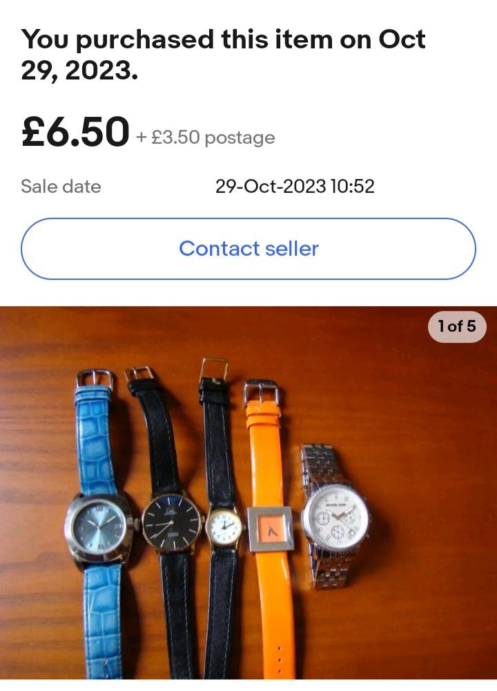

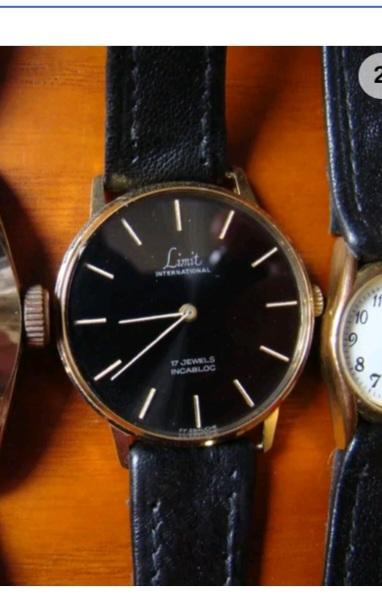

Haven't posted a 404 for a while, but i snatched these up last week for a measly £6.50 for 5 watches. Technically £1.30 each, i feel like a cheat as 3 of them are garbage, well 4 really but i need at least 2 to get within the specified.  So i would have to pick the Limit and the Michael Kors ( yes shock horror 😲 a fashion watch ). The Limit visually case and dial is in perfect condition,  inside i suspect a broken click spring as the click isn't engaging the ratchet also the timesetting is extremely sensitive so possibly the cannon pinion needs a little tighten. The MK i thought might just have been a fake but it is actually genuine, inside is quite wet , not totally sure if its water or battery leakage, seems too much for acid but there is no rust either. New movement is around 12 quid, not bad for a 150 quid watch 😄. The mineral glass is scratched up and the bevel edge is chipped in places, so that also needs changing, but i fancy a go at dressing out the scratches and re-shaping the bevel if anyone has an idea. Not sure how i managed to post this in the wrong thread but I'm not writing all that again 😆
