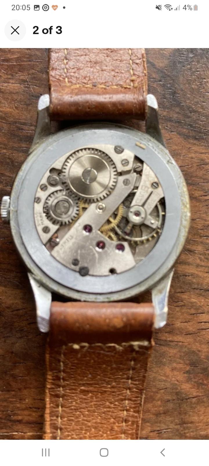

Just sneaked this a few quid under my maximum bid. Just the style of watch i love ,  raised numerals, a minute track which also looks raised ( nice to keep clean and no worries over loosing any  print,  simple hands , sub dial , lovely patination with that and contrast against the cream dial and horned lugs my favourite and it look fairly big. Any guess as to the movement, the brand Tell seems familiar,  I think ive  seen TellTime before.
14 minutes ago, RichardHarris123 said:
Working?
The seller says the balance swings but overwound. As we know there is really no such thing as overwound, broken from overwinding yes, i think he means fully wound and not unwinding. We'll see, i just really liked it, not super cheap but ok if i can make it run accurately. The movement has me thinking KF for some reason?
Hopefully just a  service.  You've lost me with KF?
Eyup Rich. So kf is kurth freres or kurth brothers. Also known as kfg that would be kurth freres grenchen, Grenchen a place in Switzerland near the jura mountains this is were the brothers began watchmaking.  Also the Certina brand and the Grana brand.

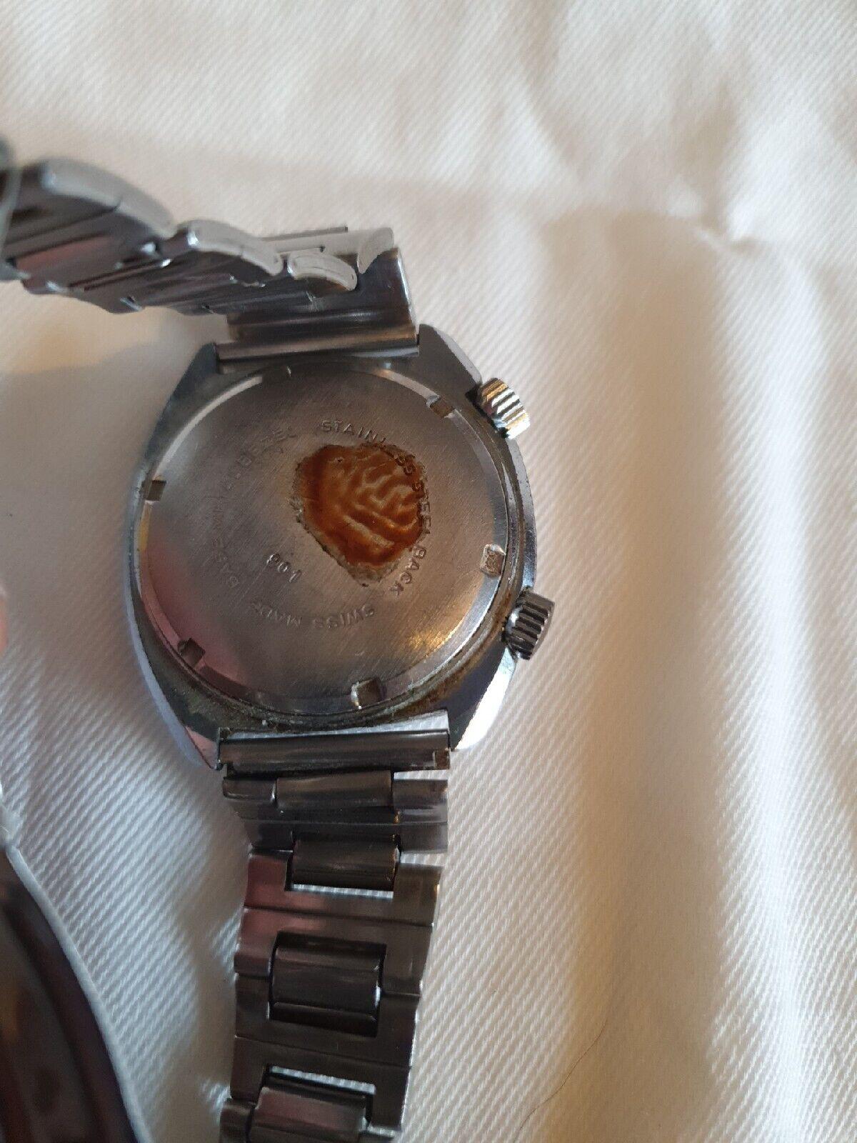

On 7/9/2023 at 3:52 AM, AndyHull said:
The 404 club recruiter has chased so many Ronda 1223-21 17 Jewel Memocalls, always without success, that I finally admitted defeat and stumped up a little more than the rules allowed (but not much more), for this "slightly chipped" version.
There are quite a few variants of this watch, including some rather nice blue dialled ones, which I'm still keen to pick up.
Other than the damaged crystal, it looks complete, and in reasonably good (if somewhat grubby) condition.
These were not particularly high end, or complex watches, back in the day, but the quirky alarm movement scratches an itch for me.
Next problem will be sourcing a crystal for it. I'll keep you posted on progress when it arrives.
This one arrived a while back, and I finally got a chance to look at it tonight.
It was a bit of a mess unfortunately. However the 1223-21 17 shares a lot of parts with the other movements in the Ronda 12xx -xx series and I happened to have a suitable donor, so parts were not an issue. Fortunately the damaged parts were not part of the alarm mechanism, but rather, two of the train of wheels and the mainspring.
Initially when I first tried to wind it, I thought it just had a broken mainspring, however it appears that when it let go, it must have done so rather violently as the train wheels were sitting askew.
It has been a while since I worked on a 12xx Ronda, and I had forgotten that the barrel doesn't actually have a lid. When I popped the mainspring out, I dropped it, and  just for a second I thought I'd lost the lid on the floor. 😳
I have it all back together and it is running nicely. I'll let it run for 24 hrs just to be certain that nothing else is amiss, then do the final adjust and regulate probably tomorrow. I've still to look through my stash of "fancy" crystals to see if I have a replacement.
Either way I'll post a few pictures of the finished article soon. I'm not sure the alarm would be sufficiently loud and obtrusive to wake me up in the morning however, so I may have to stick with my alarm clock.
if you're lucky this translates to just needs servicing. In other words the balance wheels swings hopefully both pivots are still intact. The watch is wound up tight and it doesn't run. In the olden days of organic oils that we used to love because they would get sticky with time it just means sticky and dirty oil. Unfortunately with modern synthetic oils it means they just quit working and the watch grinds itself to dust with time especially if you can throw in a little rust for grinding compound. so basically if it's wound up tight the staff is broken it's probably just a cleaning. Which is why a lot of times the sellers will spray it with lighter fluid the universal hobby is cleaning fluid and see if they can free things up so it can at least run then they'll sell it as a running watch even if it only runs for a few minutes before it comes to a stop.
