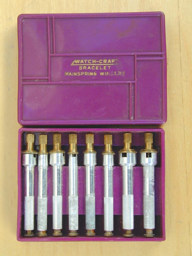

I ended up buying a Watch-Craft winder set like the one shown below.  I should be trying it out in the next week or so.  I know the learning curve is rather steep.  Fingers crossed...
Cheers.
Roger
I have a very similar winding set as this. These winders are great once you get used to using them. The issue to be aware of is unlike the Bergeon mainspring winder (which has a winding handle) it's a bit more tricky when winding & keeping the winding arbour flush with the rest of the unit. Also the same issue as the Bergeon the removing of the arbour after winding is the most critical part. Absolutely make sure it has released & withdraw the winding arbour slowly making sure the centre of the spring does not travel out with the arbour. If it does (which is common) Use a fine pair of tweezers to push the centre of the spring back as you go. I suggest you practice first with an old scrap spring/arbour.
Will most vintage watch mainspring winder sets suffice for most average watches? I dont want to buy a full burgeon set, at least not at this time.
are there things I need to be aware of before buying a set off of ebay?
