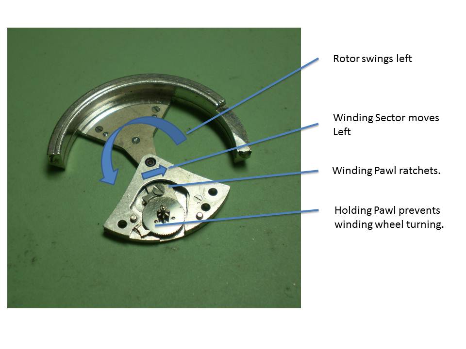

My Elgin bumper 607 has some weird stuff going on with possible over-stressing the small "ratchet wheel lever" (I don't know what to call it because I can't find a part number)
Here is a picture...My guess is when the watch is almost fully wound, the rotor just moves back and forth over a few teeth and doesn't swing the whole way OR there isn't enough slip to keep from over stressing the mechanism.
My thought is I might want a bit more slip in the winding spring....Any ideas?

1 hour ago, SuspectDevice said:
So how much slip are we talking about here if I use 8200 rather than a 8217 on an automatic?
You might find the link below interesting. On modern watches with modern automatic mainsprings breaking grease is required. They're designed specifically to use breaking grease. But in the discussion below the documentation is in reference to an earlier system for automatic watch mainsprings. It's conceivable with the older mainsprings that they're holding much much tighter. This means that using 8200 which would be unacceptable today because he would slip prematurely and slipped too much may be suitable for the older watches if you have the older mainspring.
You also notice in the discussion that Omega has a test to tell if it's holding enough. Strangely enough they don't have a test of its holding to well. For instance I saw Seiko watch were somebody used to much of one of the modern breaking greases and when it was manually wound up and hit the end it slept but it had way way too much force there is definitely a danger of damaging the automatic. This is where the application of some of the breaking greases is critical.

22 hours ago, JohnR725 said:
Excellent link...Thank you
The article uses "mainspring and slipping attachment" rather than the what has been referred to now as a "2 piece mainspring."
It older terminology is more useful regarding oil selection. 8200 appears to be the correct choice for possibly all bumper automatics assuming they all use slipping attachments.
Also known as bridle.
When some watch part has not been invented in England (the automatic watch actually was, but first produced in Switzerland) then you have all kinds of funny translations from French or German.
In the absence of any other data the above is probably correct if you still pass the test of being able to hold the winding up to a certain point before it slips. As long as the outer part is strong enough to hold and does not require breaking grease then it would be acceptable. But any of the newer watches I think unified you'd never build a hold any power at all once it slips it would release all of its power.
I don't think that a mainspring can behave like that.
With the MS unwound there is no torque on the barrel, but much force pressing it to the wall, because all the coils are outward wanting to expand more.
As you start winding, the coiling starts moving toward the arbor. Torque available on the barrel quickly increases, but pressure (friction) decrease between the outer coil and the wall.
At almost full winding not even a full coil contacts the wall, but just an arc of it. Here the function of the bridle becomes important. Its tip is in the opposite direction and punts against the wall, effectively braking, while the above happens. Unlike the end of the main part, that would be dragged along. Some barrels (e.g. Sellita) also have notches on the wall to positively engage the tip of the bridle into the wall.
At some point an equilibrium is found and even if the auto winding (which is, by nature, relatively weak) is able still turn the arbor, the MS will slip a corresponding tiny bit to avoid excessive stress on the innermost coil, which could snap over a long time.
The braking grease is there just to move the equilibrium of forces futher toward building a larger power reserve, delaying slipping. Its total absence does not prevent an automatic MS to be wound anyway to a significant portion of its full potential.
