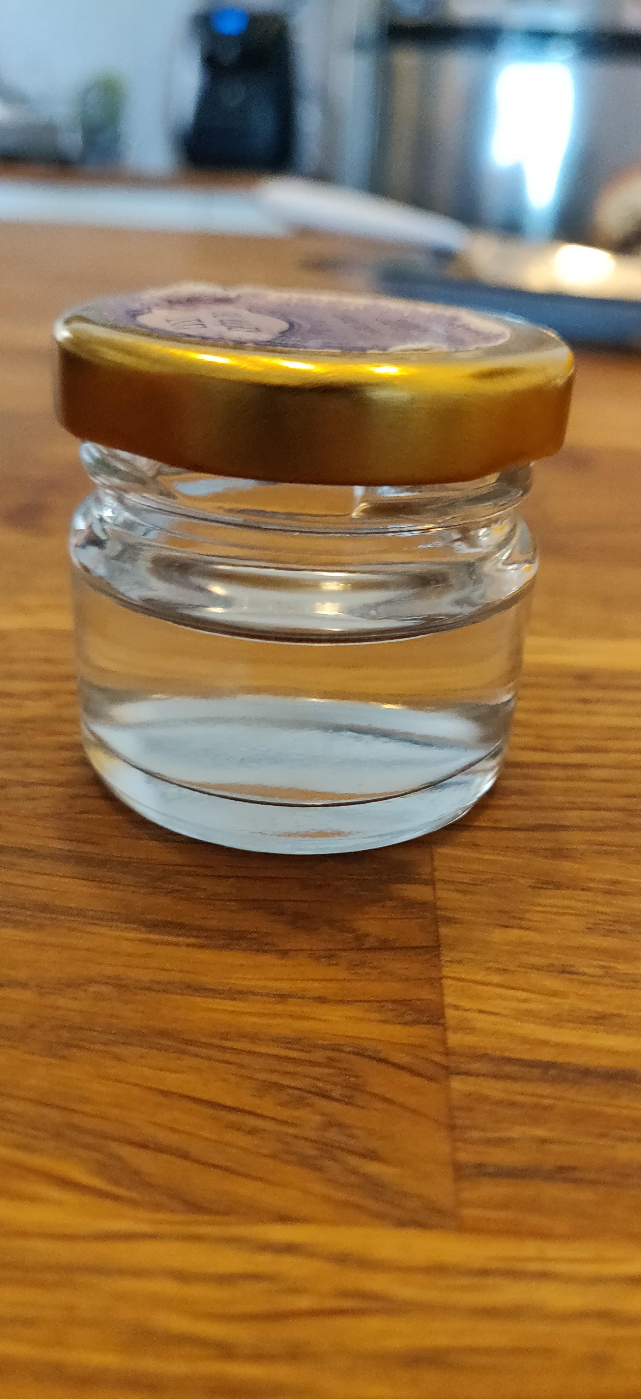

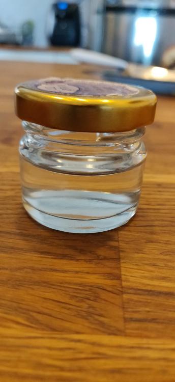

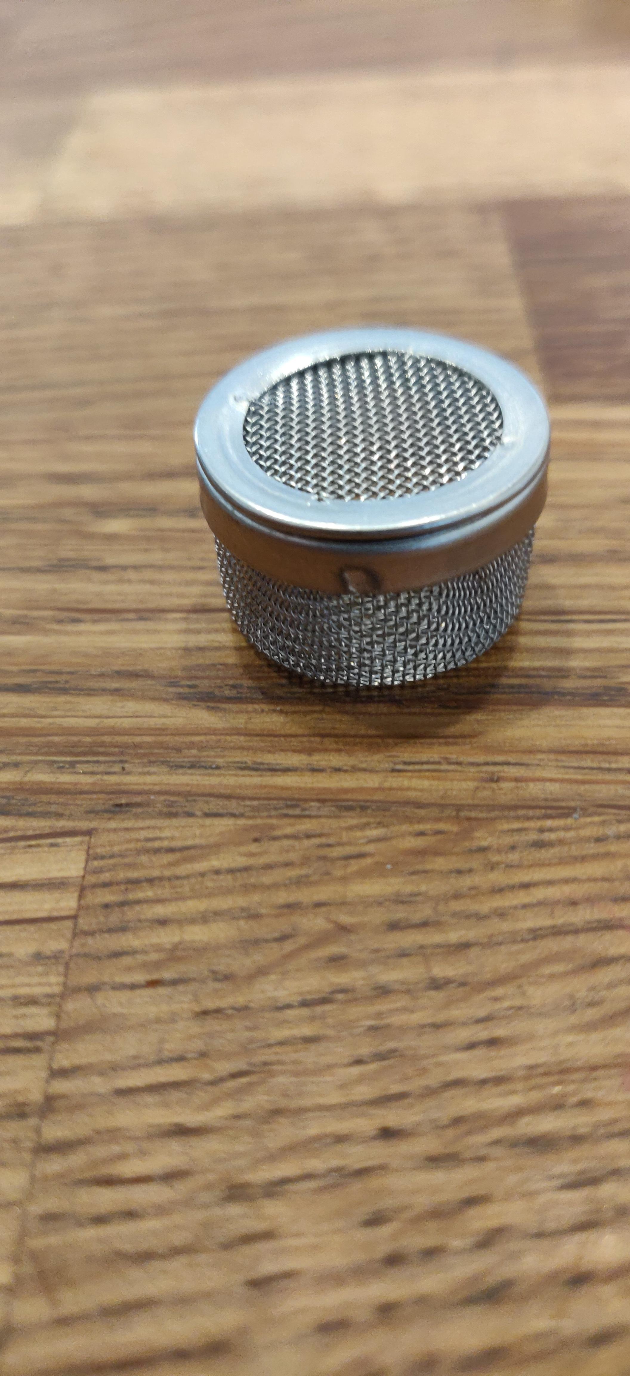

So after reading multiple proposition I've elaborate this procedure and I would like to know what do you think about it (am I completely out of mind ?)
Never ever use this for balance and pallet fork (only very gentle manual cleaning for these parts)
  1. Put all part in tiny mesh basket the same used in standard cleaning machine (I've posted a picture)
  2. Put in Ultrasonic cleaning machine the baskets with the parts
  3. I use ELMA RED 1:9 for cleaning phase (very effective do not even try to compare with soap it's not) 10 minutes 50W power no heating
  4. First rinsing with tap water 10 minutes 50W no heating
  5. Second rinsing distilled water 5 minutes
  6. Then I transfer the baskets in tiny jars (I've posted a picture)
  7. fill the jars with IPA Alcohol 99% close the lids
  8. Put the jar in Ultrasonic water 5 minutes (keep the water below the lid of course you don't water inside the jars)
  9. Dry the part with air blower
It's giving very good results but I'm afraid about long term may this procedure induce rust with time I really don't know
 Thanks for your comments
