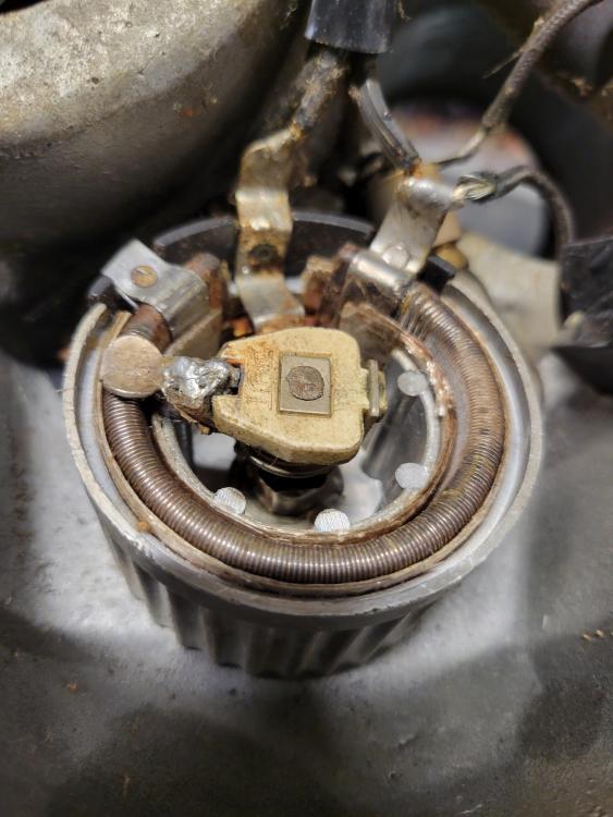

Hello guys.  I have a L&R watch cleaning machine that works but the speed control rheostat knob doesn't work well.  Does anyone know of a replacement part for this?  or a good substitute?  I found one by Allied a RHS25RE.  It's a 1 amp 25 Ohm and good to 550 volts.  I know the Master machines are 115 volt at 75 cycles.  Would this work?
I would like to get my machine back up and running again.

If it is a wire wound rheostat, you don't have to replace it. Just spray it with contact cleaner and work the knob a few times to grind away the oxide layer on the wire coils and it will be fine.

Yes, I agree that a wire-wound rheostat should work perfectly fine after spraying with contact cleaner spray.  There is, of course, the possibility that the wiper is mechanically compromised...in which case cleaner will not solve the problem.

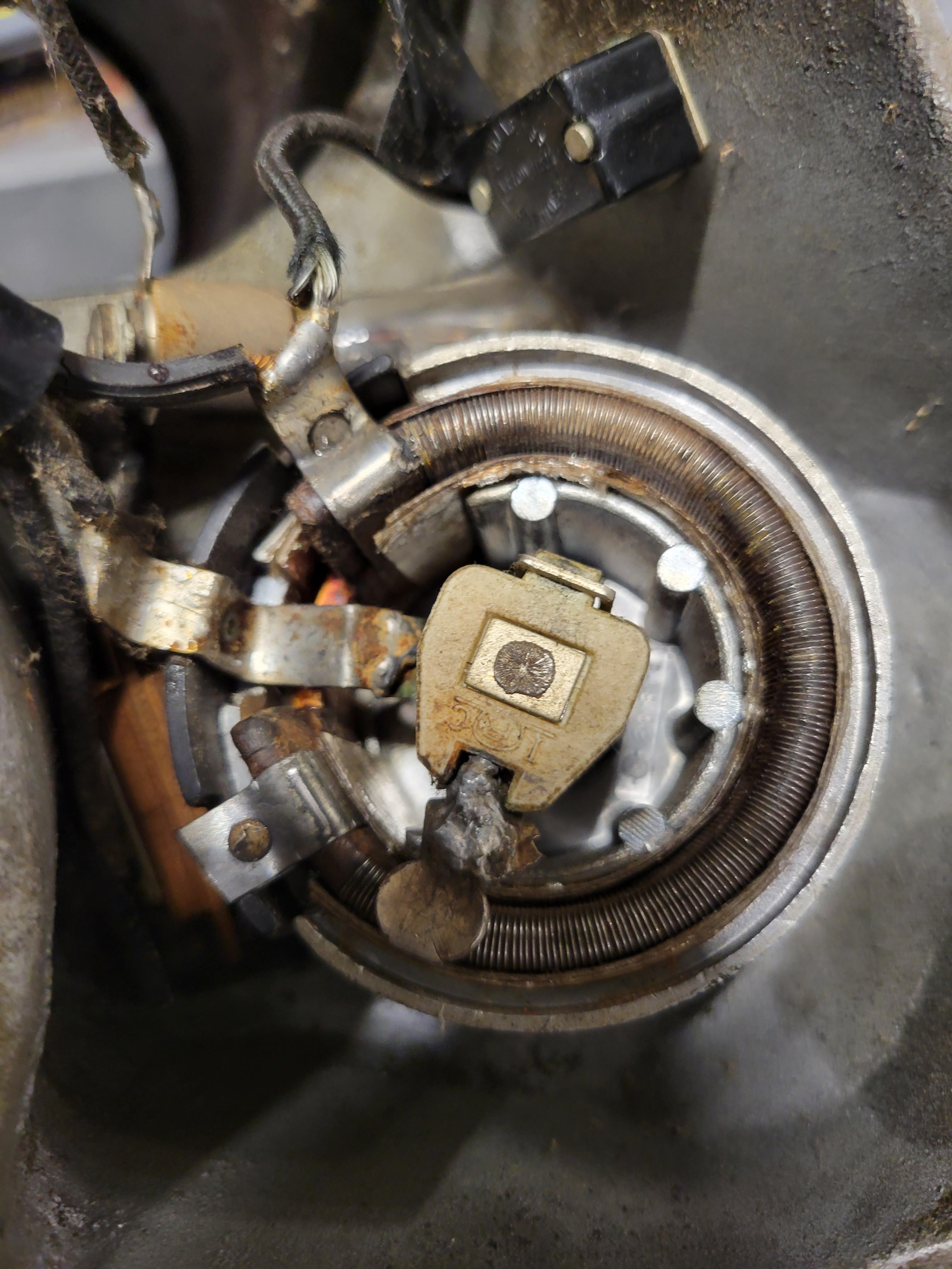

Here is the Rheostat.  I can get the machine at work if more pics are needed. I'm an electrician for a hospital so I have it at work for the repair.  There seems to be a brass ribbon soldered to the wiper that is wrapped around the shaft.  You can't see it well in these pics.  I was concerned about creating a short if it touches the wire.
I haven't tried cleaning it yet and I won't mess with it until I solder on a new cord.  All the old rubber insulation has vulcanized and falls off if you breathe near it.

Yes, that's a wire wound rheostat. Looks frightening doesn't it. The coils are only insulated from the metal body by one piece of phenolic paper!
The coils look very oxidized. You might need to sand it lightly before using the contact cleaner.
