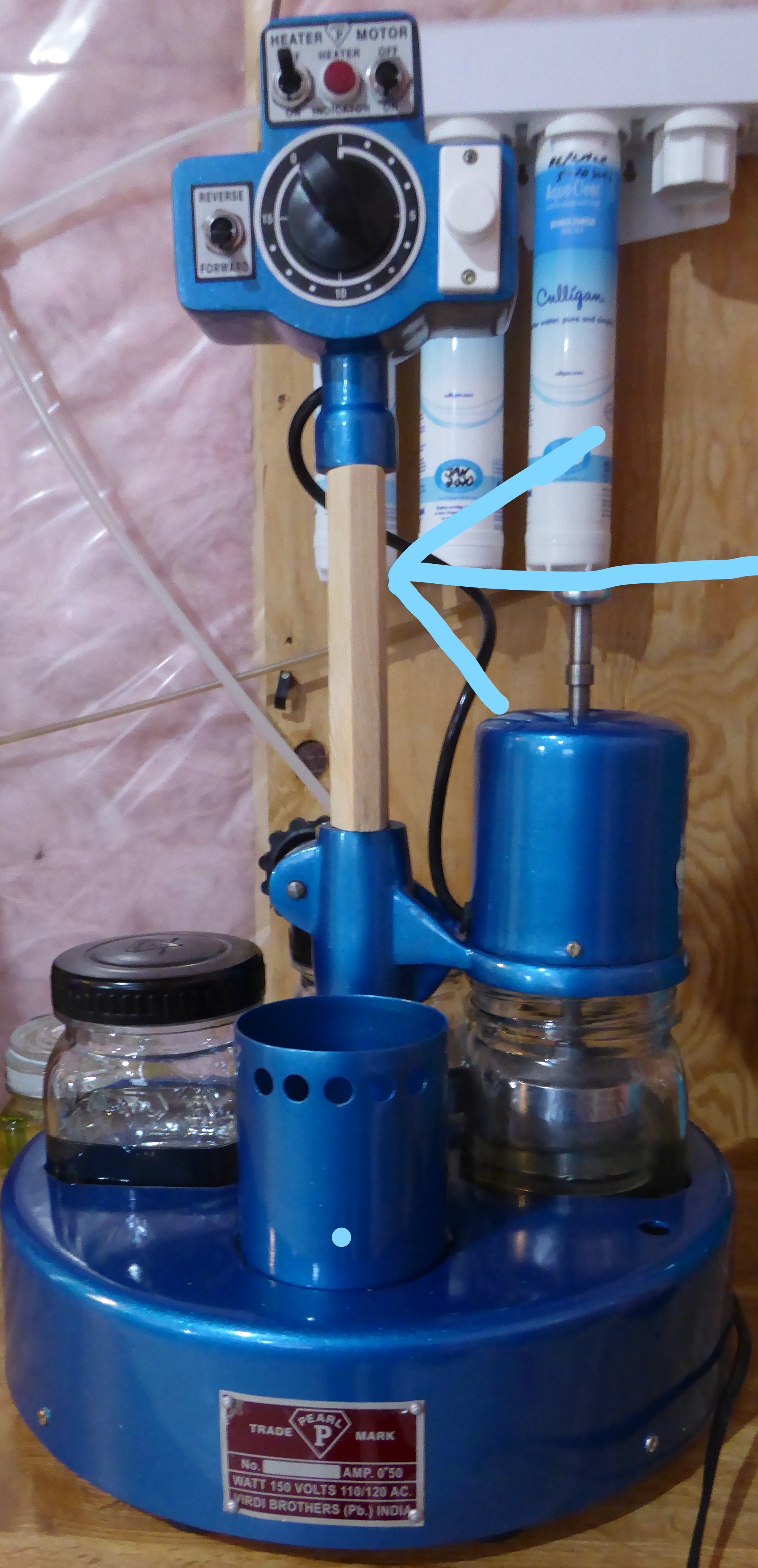

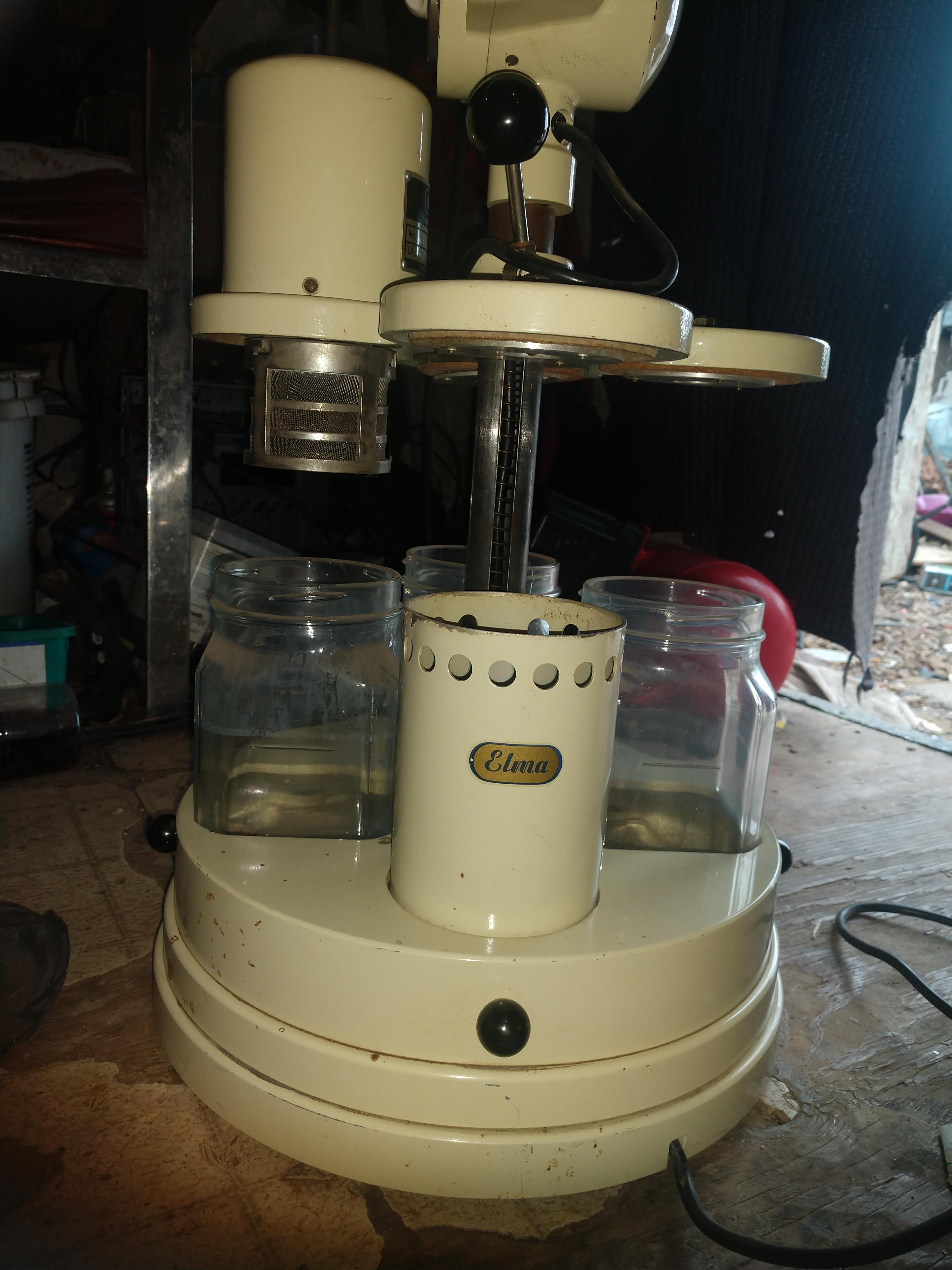

If you can find a supplier the "Pearl"  sometimes named "Janta" which are copies of the Elma. I have been using the "Janta" for over a year now and can not fault it. It is manual in all respects including for the very basic model which I use which has no timer so I use a kitchen timer. Mine was supplied with 4 jars (1 spare) + a basket. See pic which is the exact model I have. PS I paid under £500 including delivery.

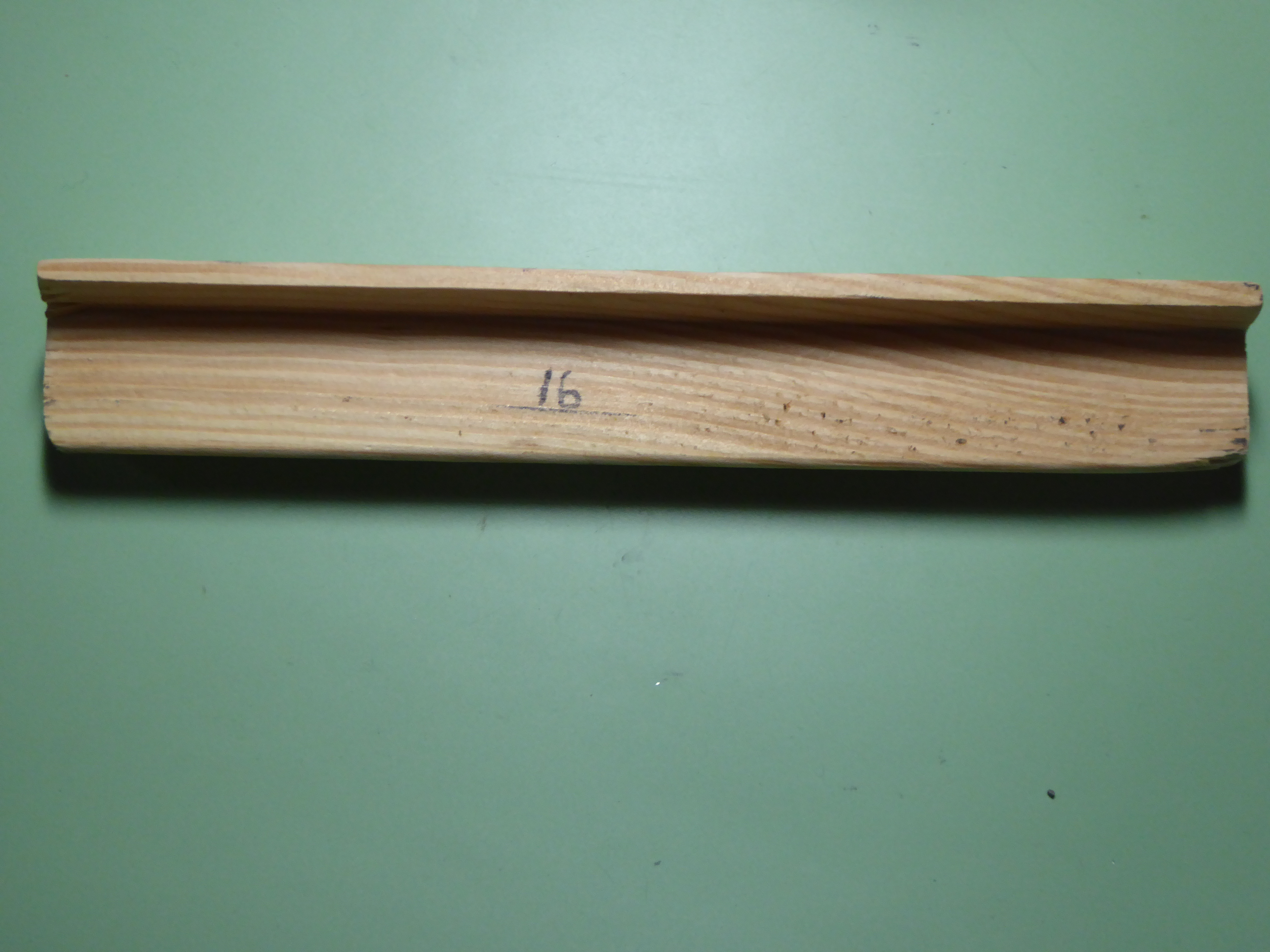

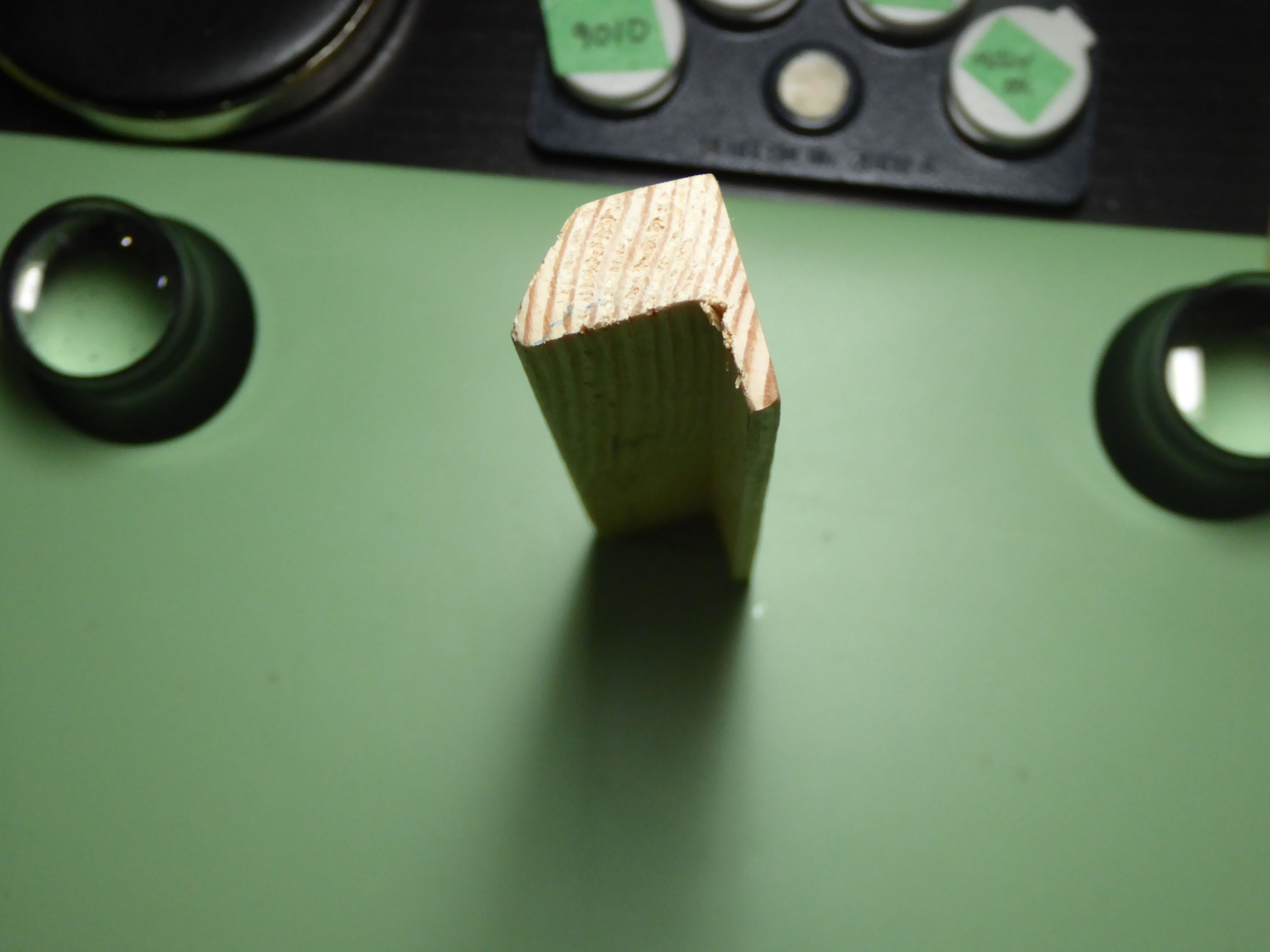

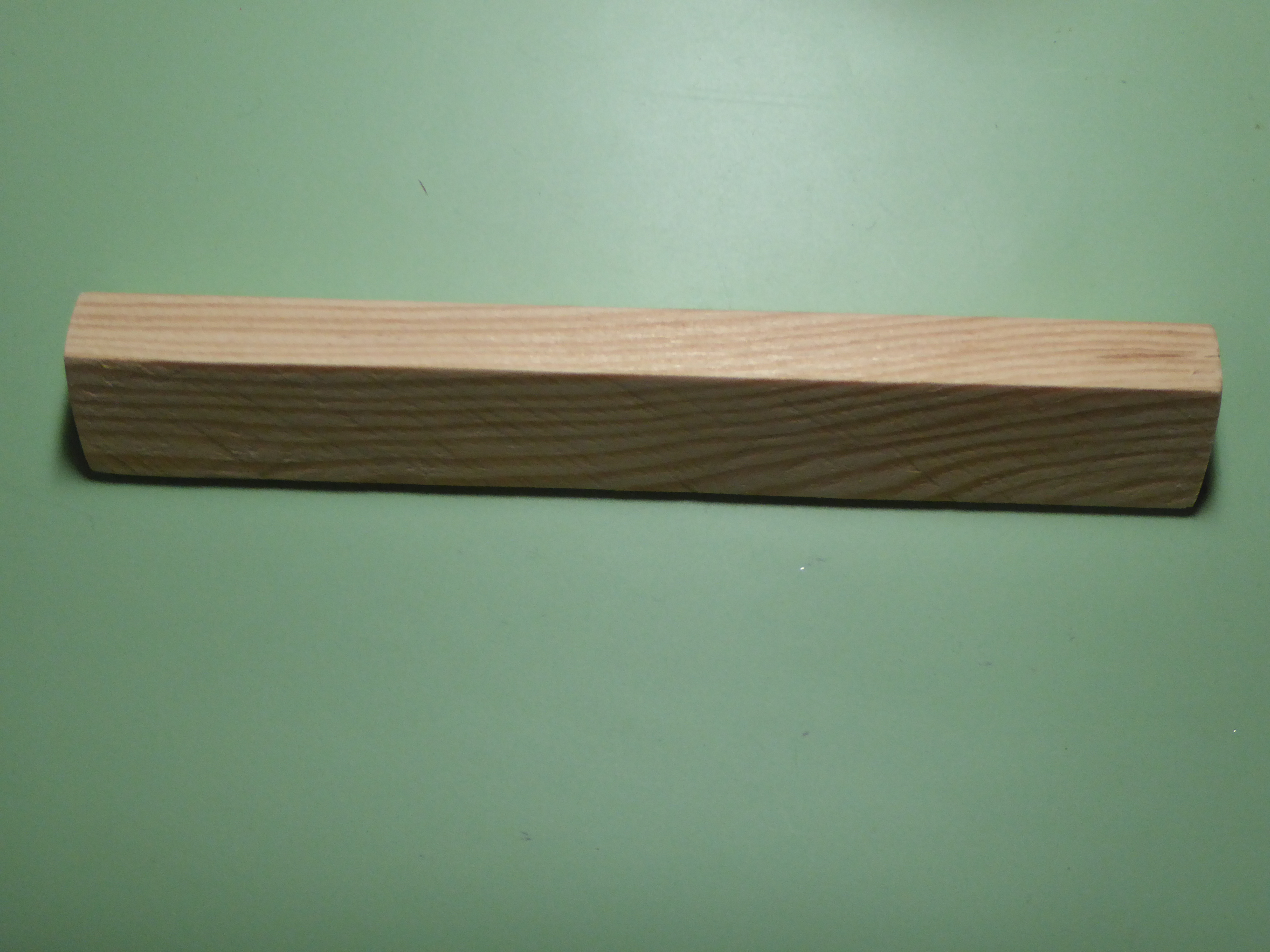

Recently I bought a knock off, old style Elma watch cleaning machine. Love it. The spring that controls the motor going up and down the support shaft is quite firm and the tension knob can be a killer on the hands. So I found a scrap piece of wooden corner trim and cut it down to 16 cm to make a brace or stop. Works great!

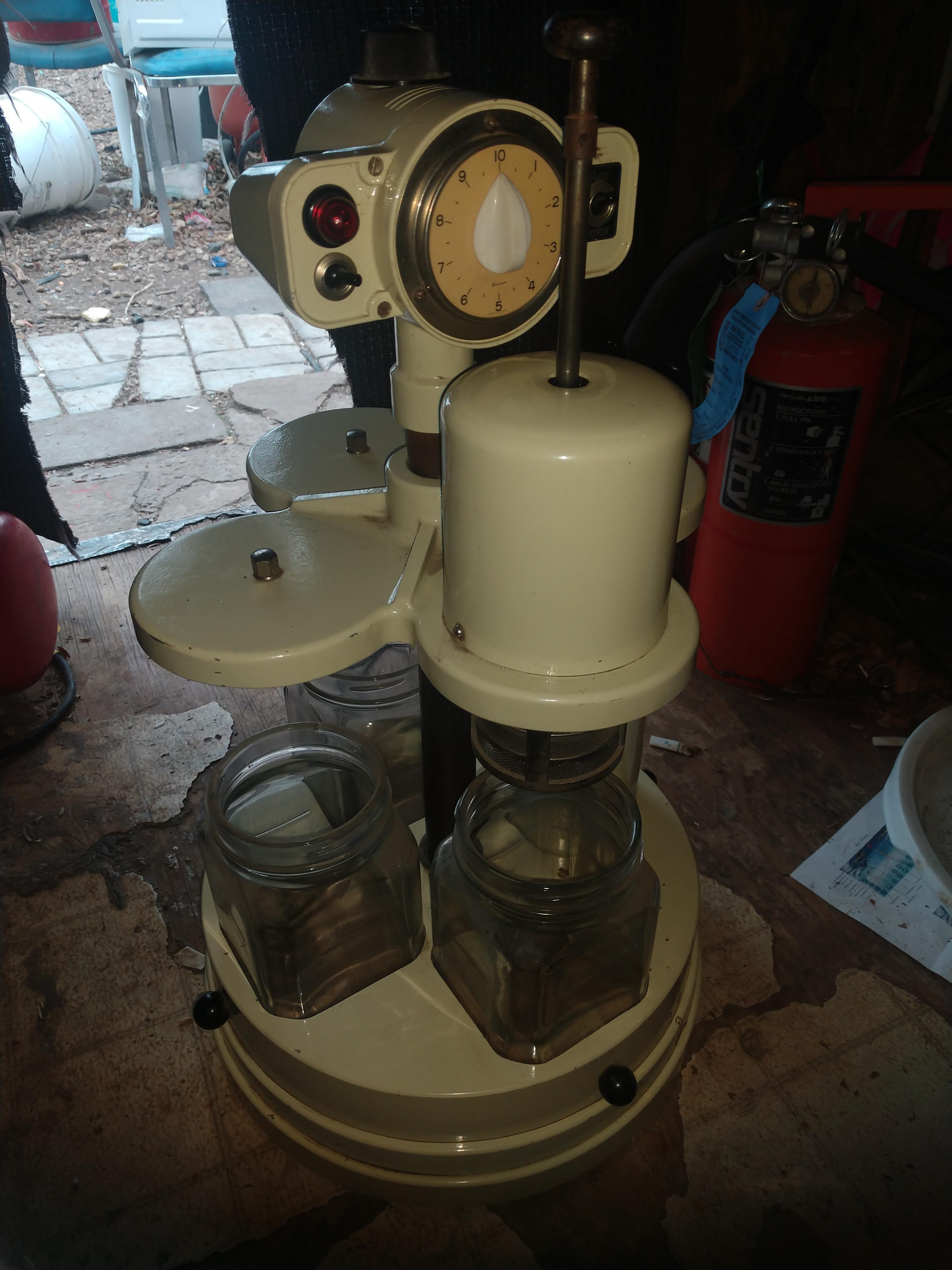

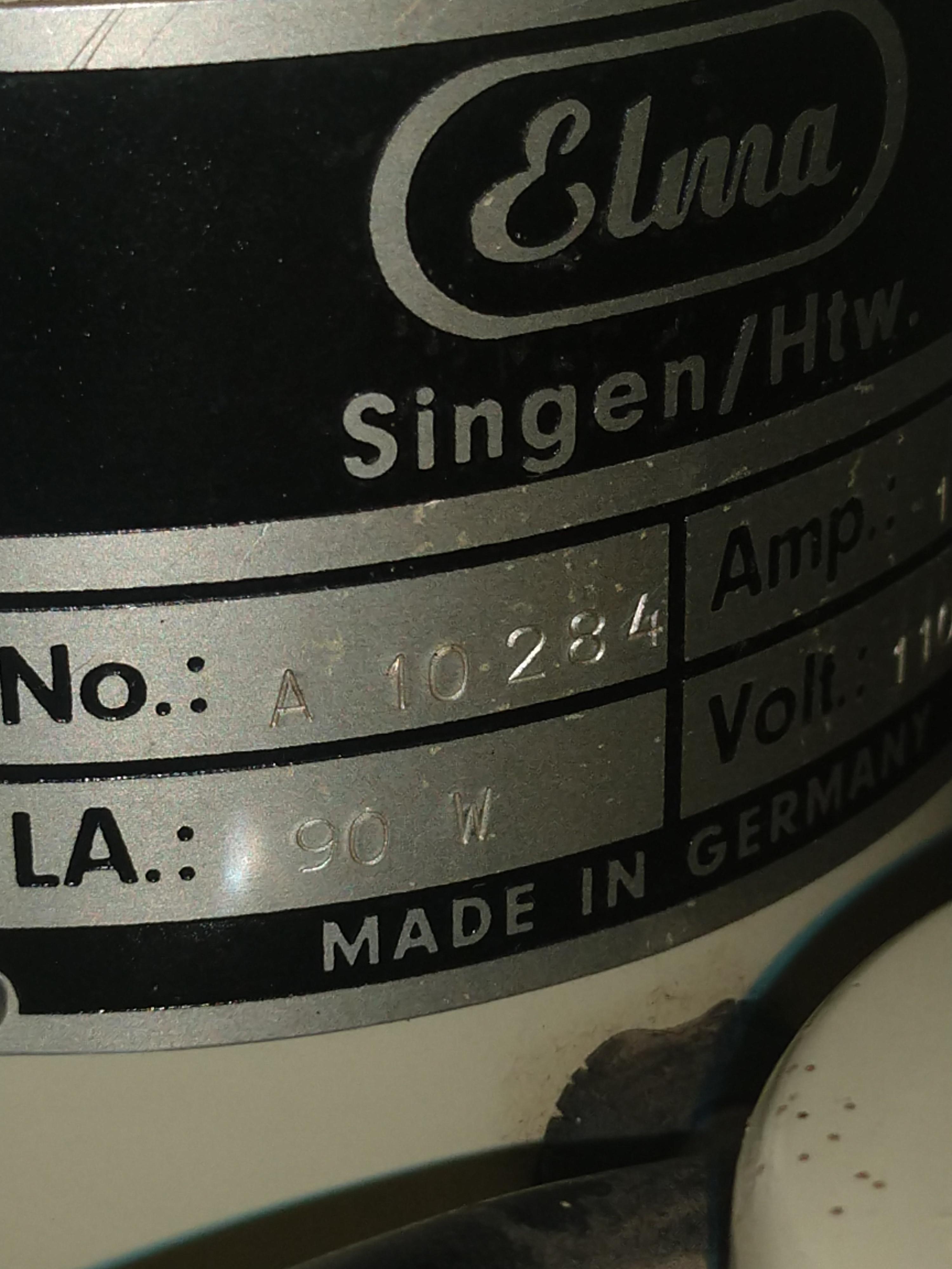

Ok, so, to start off... I am well out of my element here.. I'm more of a blacksmith than a watch and watch repair guy... That being said, I happen to come into ownership of an Elma watch parts cleaner after helping a friend clear out his great aunt's property after the estate sell. I have had one hell of a time trying to find out what exactly it is, much less any information on it. And what I have found has been minimal to say the least. I've seen several Super Elites sold on eBay, yet I have not seen one exactly like mine. I'm fishing for a some sort of insight as to what I have, and what I should do with it. I am not much of a forum kind of guy, and I am definitely not tech savvy, so I apologize for my unpreparedness with this.
