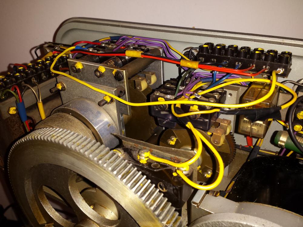

Rafal .Thanks again for the information most informative, i am posting some pictures for you to study, when i removed the cover the red wire on the right of the terminal block on top of the transformer ( 1st picture) was not connected, i have put it into the last connection on the right is this the same as yours? Regards atkinson.
Rafal, I have been observing the machine again this afternoon and i believe i now know what the problem may be, it would seem that although the small motor next to the transformer is spinning forwards and backwards the gears do not move at all, consequently the cams do not move.When you have time can you let me know at what stage the gears/cams move and is the red wire in the terminal block in the correct position? Thanks atkinson.
Im sorry for late response, but I just got back home. At first glance your machine looks like re-wired or upgraded version, connector to transformer doesnt match mine setup. Also yours have 2 starting resistors where mine has only one (big green resistors which sliding part - it gives a kind of soft start for motors).
Small motor next to transformer is a sync motor, it rotates with certain speed to measure time (when you use timer it will stop, to spin bucket for longer time), on same axis you have those disks with tooth's which move end switches on and off  -  one is connected to relay switch which is responsible for changing direction on which bucket spins, second end switch moves procedure forward -  next stage/jar.

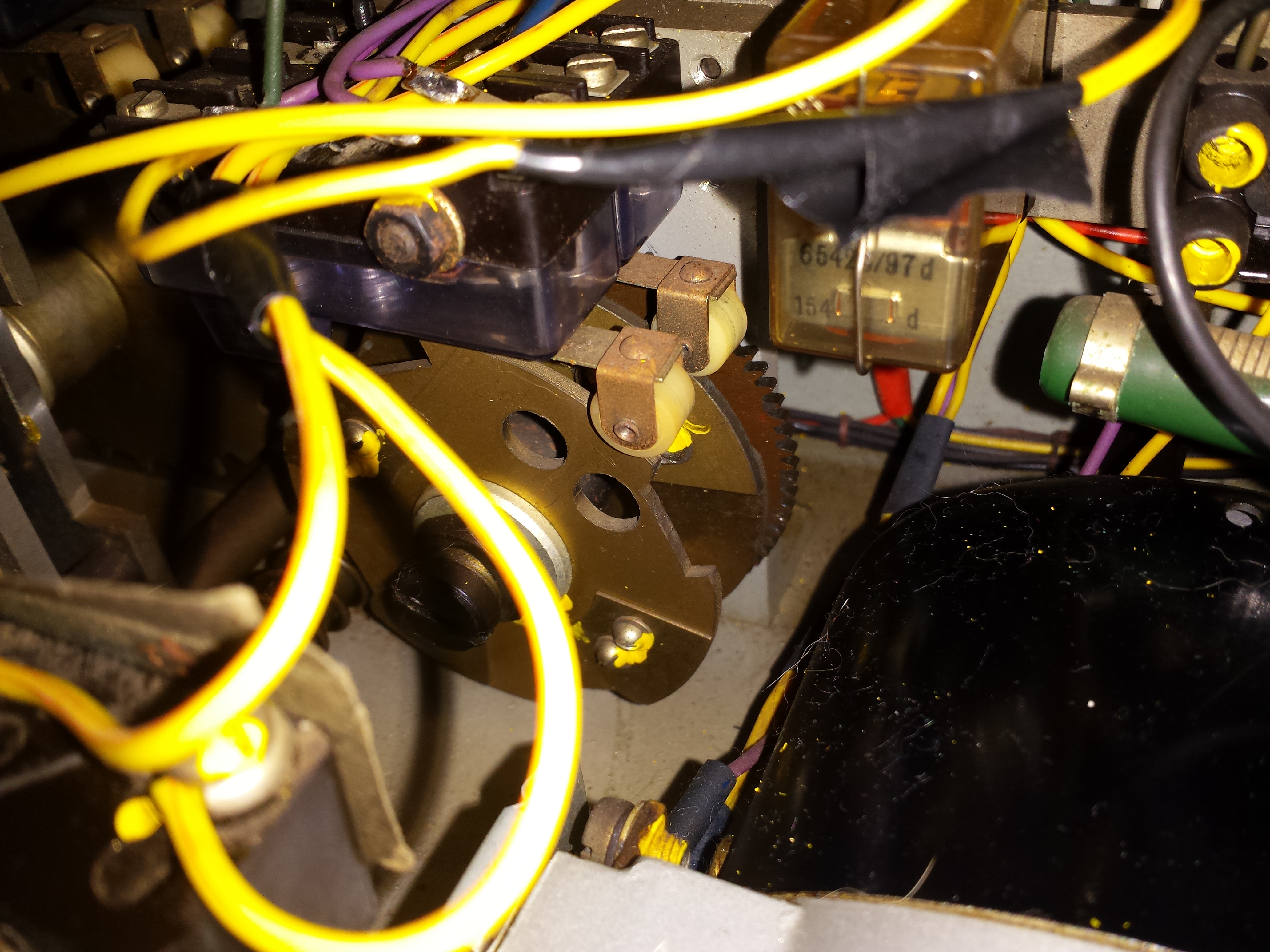

Thank you Rafal for your reply, i managed to realign the gears on the sync motor last night and the cams go backwards and forwards now, i still however find that the machine does not start on the first jar and end on the heater stage, can you Rafal when you find time to post a photo please of the position of the cams on the first stage before starting the machine, Thank you,Atkinson
Hi Atkinson,
I finally manage to take pictures for you:
2 end switches on left hand side are in ON position, ones form right hand side - first is in ON position and 2nd is in OFF state. Machine just stopped and red light is on, so it possible to lift bucket a bit without starting new cycle (easier to remove bucket). And close up picture:
second set close up:
Edited by Rafal
Thanks once again Rafal for your message, i am posting some pictures taken this morning of the machine after the heater stage, i have now got the machine to complete a full cycle up to this stage but unfortunately i now find that the heater is not switching on, just wondering if perhaps the cams are out of sync or the worst possible outcome that the heater is kaput.The total cycle time from switch on to the end of the heater stage is approximately 18minutes.
Well i have finally got everything working, the heater you are probably aware is connected by two sets of fixed contacts so the stage before the main  heater stage brings the heater on to gently warm up before the main heater stage, when i was testing the machine one of the knucle joints came off and the top of the machine came down heavily onto the heater tube causing the roller cams to be out of alignment, once realigned contact is now made on both stages of the heater. I have run the machine for eight cycles and it seems fine so my next trial after i have replaced one of the knucles will be with fluids.Thanks Again for your help. Atkinson.

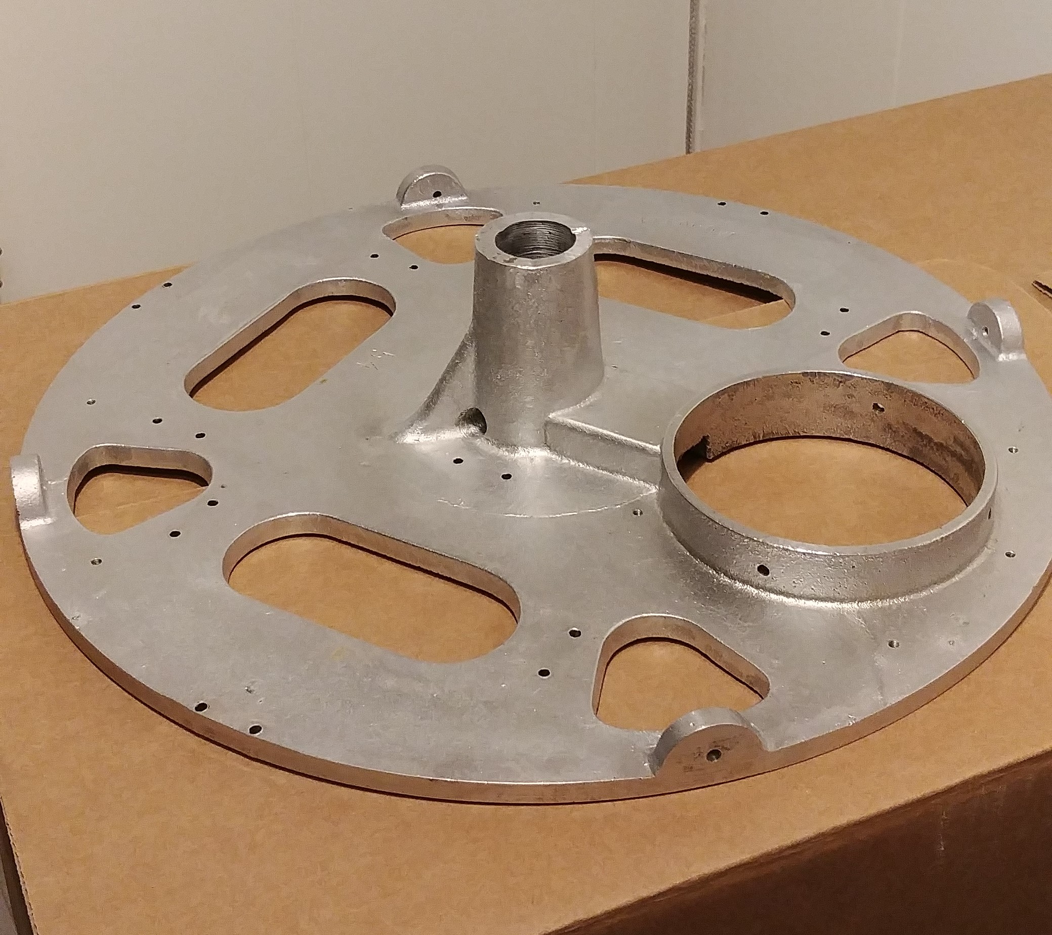

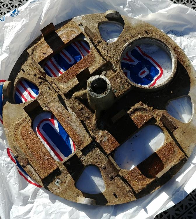

I'm working on mine at the moment. Man, it was dirty.
Here is the progress on the baseplate. A big thanks to SSTEEL for the tip on removing the jar holding springs before cleaning.
