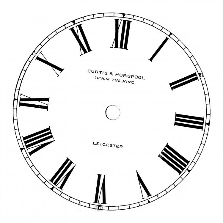

GIMP is an image transformation tool with very poor technical drawing features. One needs Illustrator, or Inkscape to work on dial blueprints.
I've used Gimp quite a lot for flat dials, just scan the original and edit out the defects, the beauty of this you can lay the new dial over the top of the old, so if in the future you decide you want a dial restorer to work on it you have preserved it for future restoration.
You can print on off white paper or card to make the dial look aged.IMG_20190613_0002.thumb.jpg.5c53cdbaba9a4b407a94892b6dde0966.jpg1300016454_clockdial.thumb.jpg.11226ab0a0458e9e042a24b15be8e406.jpg

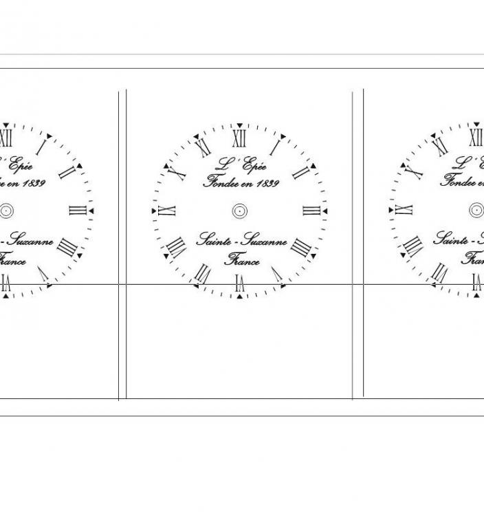

Also got me thinking, you may recall I wanted to get an Epee dial restored, but to expensive, I love what Mark did in his video, I was wondering if I could do the same, does it have to be printed with laser printer? or would normal printing be OK on the special paper??
Thanks Len
1 hour ago, Lenj said:
Can anyone tell me name of printing paper used??
Happy New Year to you ALL..
Thx Len
Open the video in youtube and in the description field you will find a link to the "paper".
I've used all sorts of paper a high gloss photo paper printed on a inkjet does a good job of looking like an enamel dial. I use a canon inkjet there is a setting on it that puts more ink onto the paper for the blacks, Epson heavy weight matte paper is fantastic for  non glossy printed dials it has a very fine surface finish to the paper.
