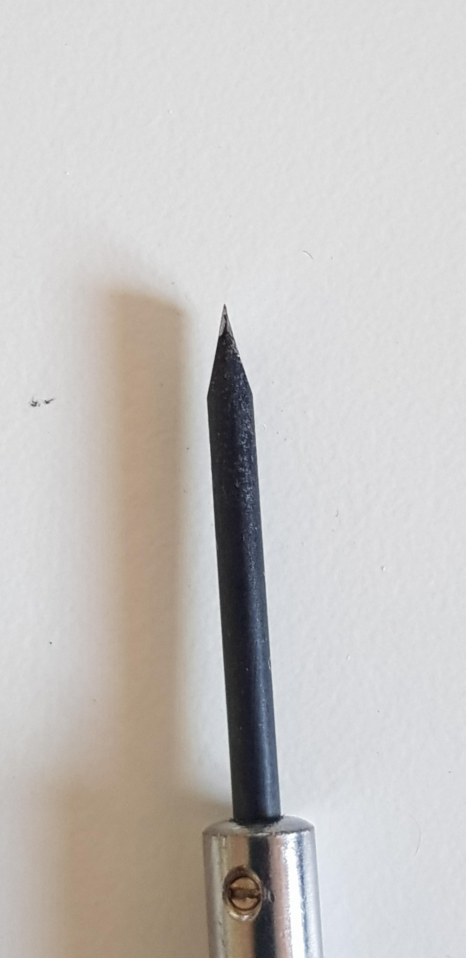

Hi,
    I'm just starting out repairing watches and have found an old set of screwdrivers that I'd like to use. However, a couple of them have chips in the tips. Is it possible to repair the screwdriver tips using a grind stone or should I just buy a set of new tips? I've attached a couple of pictures that show the damage.
Thanks
PJ

Your blades have been hollow ground on a tool like this.
If you use the tool illustrated by nad you will have to flatten each side of the tip. You should replace the blades or buy the hollow ground sharpener.
  • Confused 1
Hi Watcher
OP's pic's of his blades don't look to me to be hollow ground.
Perhaps you could enlighten us with your observation of the need for that particular tool?
Thank you.
Sent from my moto g(6) play using Tapatalk

Thanks for all the information. I've ordered a grindstone and one of the tools in the video above. Will have a go at repairing the tip once evreything arrives.
PJ

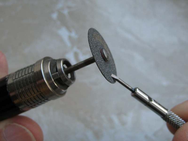

Maintaining screwdriver tips was traditionally basic maintenance of tools. Usually new sets come with spares, and separate spares can often be bought.. I usually swap then occasionally have a session touching up a few of them. With non-magnetic screwdrivers the tips can last until there's a stubborn screw.
On 5/13/2020 at 1:37 PM, praezis said:
Screwdriver sharpener tool, type "Quick Action":
Blade angle and thickness are continuously adjustable… :)
Do remember that excessive heat will potentially turn your blue steel into softer steel!
They don't get hot at all with these discs.
I have to touch up tips nearly daily and no time for ruminant sharpening...
Frank
Frank
daily? are you repairing 24/7?...:rolleyes:
Almost, it's my job.
3 hours ago, praezis said:
nearly daily
Frank
On 5/13/2020 at 11:21 AM, nad said:
Hi Watcher
Thank you.
Here is OP's blade shown with one of mine sharpened with the Horotec tool. To me they look alike. It takes just 5 seconds to sharpen a blade and then another ten seconds to deburr (a most important operation).
