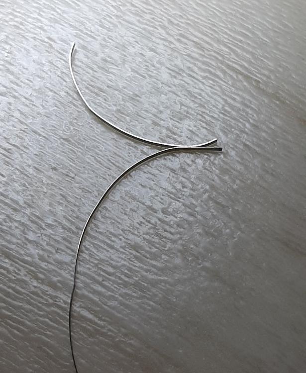

By "soft" I assume you mean a shallow angle between bridle and spring?
This is the old spring, I'll check the new one when I take it out.
PS I changed the spring because of that kink !
No, just gently compare by hand the force needed to bend it to an half circle or so.
