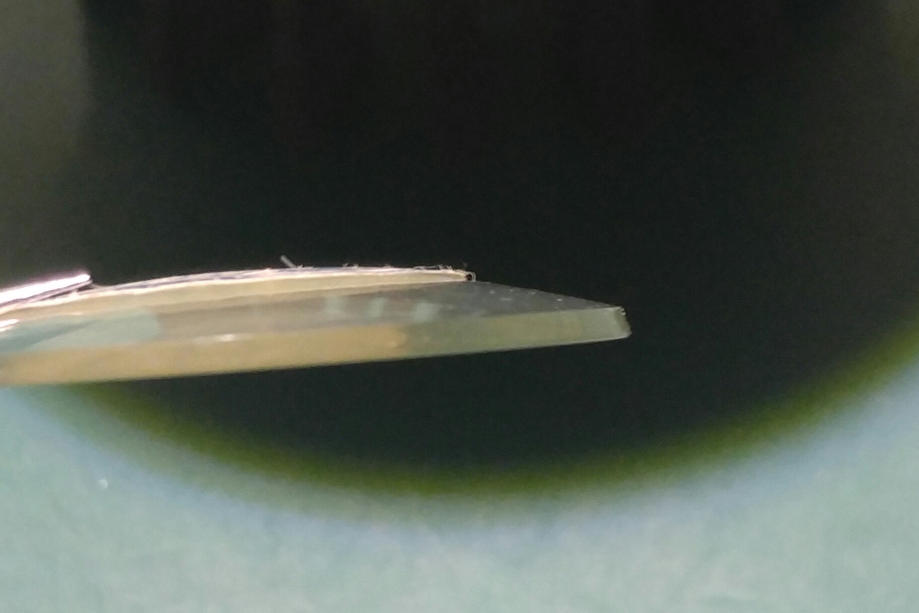

So... There is no way putting my glasses with my tool into place. The mounting device is too high, the glass doesn't stand high enough for gripping.
But even when picked up from a flat surface, the tool always slips from the glass. The glass has a tilted border (see photos).
Wrong tool / wrong glass /wrong technique?

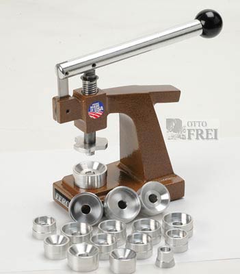

Why have you only flat dyes ? Even inexpensive case and glass press tools come with a selection of dyes, including concave dyes suitable for domed crystals. The problem today will be obtaining jumbo dyes for the modern larger watch but they do come up for sale on various sites.

Yes, this was just what I was thinking! I only have flat dies because I have not bought a better set yet :) hence my question, which one to buy. Perhaps I misinterpreted the above suggestions for my crystal-tool.

old hippy is right, but for clarification high dome acrylics = crystal lift, low domes = press, but the method is different from pressing a mineral/sapphire/tension ring, with a low dome acrylic you basically have to use the dies to make the crystal curl in on itself slightly, then slip the case/bezel into position and then release the pressure so that it locks in place to the bezel/case. It's probably been properly demonstrated or explained somewhere around the forum before, but i could just imagine someone trying to puzzle that out from scratch.

Often what makes the difference is having the correct dies in terms of shape, size and material.

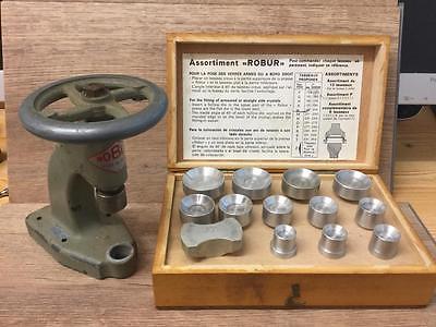

This is one type I had. https://www.cousinsuk.com/category/press-dies-robur   expensive used for fitting tension ring glasses
As near as I can find of another type I had for tension ring and flat

I don't recommend that one, because the pressing force is not in between the pillars, so it tends to flex. Better to have cast strong body as others that were featured before.
