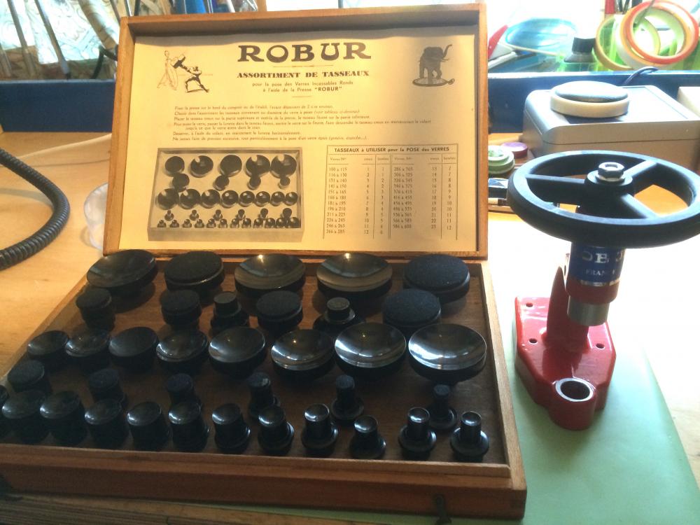

I have been looking for a good set of these for a while & arrived a few days ago a almost complete set of Robur dies for a Robur press. Had to replace couple that were damaged & also a couple to complete the set. The replacements however are marginally smaller but should work OK.. I will try and repair the damaged dies on my lathe but it might be a difficult task but worth a try. Anyway see pic below.
Very nice. I have one myself I picked up some time ago although the press is much older - yours looks pretty new. Some of the bakelite dies with my press were chipped as well but I find I don't often use them , I use the the metal dies instead. I was fortunate enough to get both the straight and curved metal dies for a good price.

Hi Rog
I've got one of those myself, it's very good I think - very expensive new as well. You are missing the square and rectangular dies from along the top and the attachment for pressing crystals out that goes in the bottom left. These were missing from mine as well. You can either buy them new or look for some coming up for sale, which is how I found mine.
Stephen
Edit: just found the post and photos I made for this. I can take another photo of what it looks like now if you want.
http://www.watchrepairtalk.com/topic/2726-new-toy/#comment-26728

Wow . Yours look to be in a slightly better condition then mine. But nevertheless i think i got a really nice price. Paid only about £170 or $240 for the lot.  I didn't dare to wait? So i just buy it now price. Instead of risking missing it. The small dies for pressing out i am sure i can do without or find something else to press out with. Square dies i seldom use.
