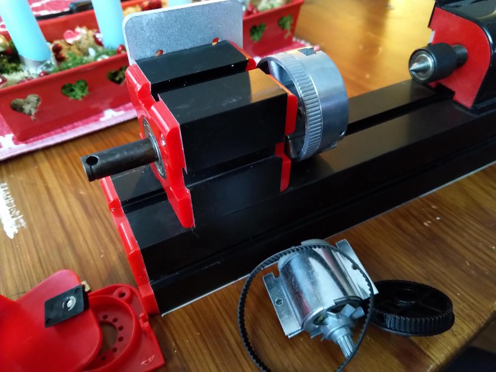

Mini Lathe, do you mean these ones? (See pictures)
I've  been experimenting with these small ones for a different purpose but haven't thought about using them for watchmaking.
One might be able to do some small gadgets and rings in brass and plastic with them since they usually have a small weak 12V motor which are belt driven.
To do something else requires you to modify them heavily with new motors, a better XYZ table with micrometers and so on, the cost of this probably reaches way beyond the price of a used watchmakers lathe so I doubt it is worth it. But as an interesting project just for the kicks  it would be a fun project.
