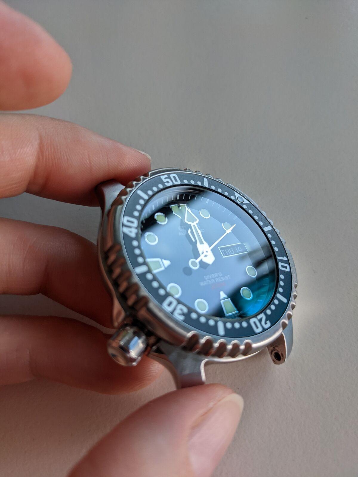

Any ideas on opening this critter? It doesn't seem to have a separate bezel (some of these required you to pop the bezel and remove the movement through the front). I can't seem to find a spot along the case back that is enlarged for a case knife. Pressure with a ball isn't doing me any good. Suggestions?
18 hours ago, grsnovi said:
Suggestions?
Without the luxury of having a closer look, it seems to be a press-on cover (?)
If that's the case, I've had many times suc6 with a surgical knife in the grove (housing / back cover) and drive it carefully in using a small hammer. Once to gap opens, you can insert your case knife.
There is a risk that you may damage the case-cover O-ring and for sure you will blunt the small scalpel.
So far I held myself away from Seiko & Citizen movements, but according to some forum-members these movements aren't as bad as I thought. Parts availability was my biggest concern, but as a member pointed out, these watches / movements are made in the "trillions" 😉

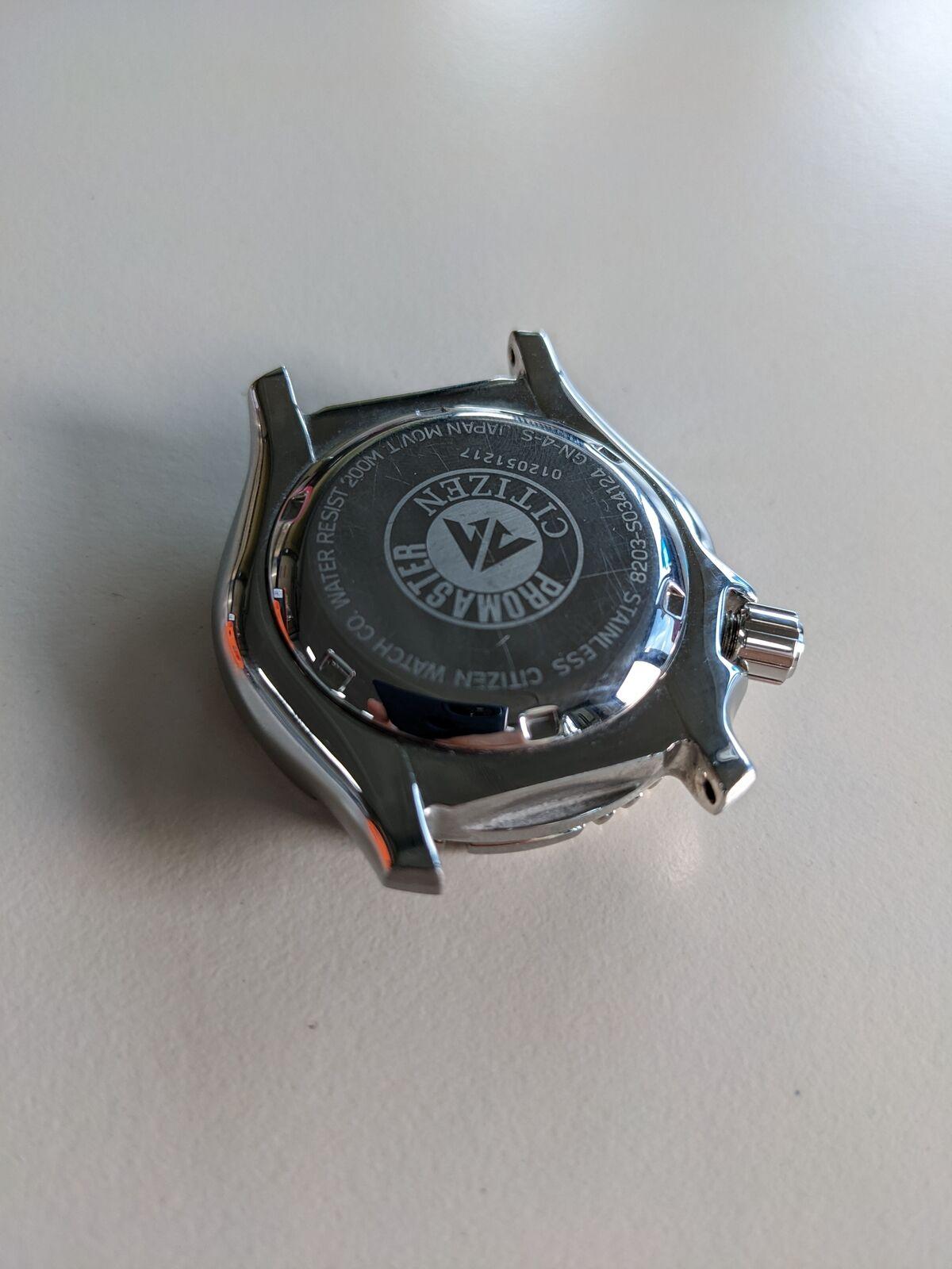

So today I threw myself in the deep with this relative cheap (€110) Citizen Promaster NY0040-09EE equipped with an automatic Miyota 8203 movement. The watch was described as used with some signs of wear, no papers and with no watch-strap. On the pictures it didn't look too bad and compared to some (beaten-up) Seiko's divers in that price-range, it looks exquisite.
We'll see what comes in the package 🤗
I have limited experience with the Miyota movements. I've only serviced a 9015, but it was a joy. Lots of parts but not a single little spring to ping as the springs are integrated into the parts, also, unlike the Seiko 7snn movements, no tiny cap jewels to handle. I don't know anything about the 8203 but I wouldn't be surprised if turns out to be a joy to work on. Let us know!
Really nice watch BTW😃👍

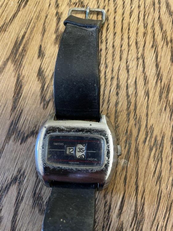

The Citizen has via a D-tour (Germany-Denmark-Sweden-Denmark) arrived. First impressions are that the watch is nearly as new. No scratches on the crystal, hardly any on the bezel and no signs of ever been opened. The movement looks untouched. However, the movement runs but has a tendency to stop. Perhaps no wonder if you see the "heavy snow in Switzerland" picture on the timegrapher ...... but this is the reason why we are here 😁
Edited by Endeavor
Here's a beautiful super-seventies Favre Leuba inbound from India. It would be entertaining to restore it but the truth is that I only picked it up for the mainspring barrel. It should (fingers crossed) be a fit for a Zodiac project I'm working on as the FL 1164 shares parts with the Zodiac 72- we'll se how it goes though.
Oh wow. Yes the old digtal snow globe 👍. Are you playing heavy rock music in the next room or living alongside a train track i wonder 🤔

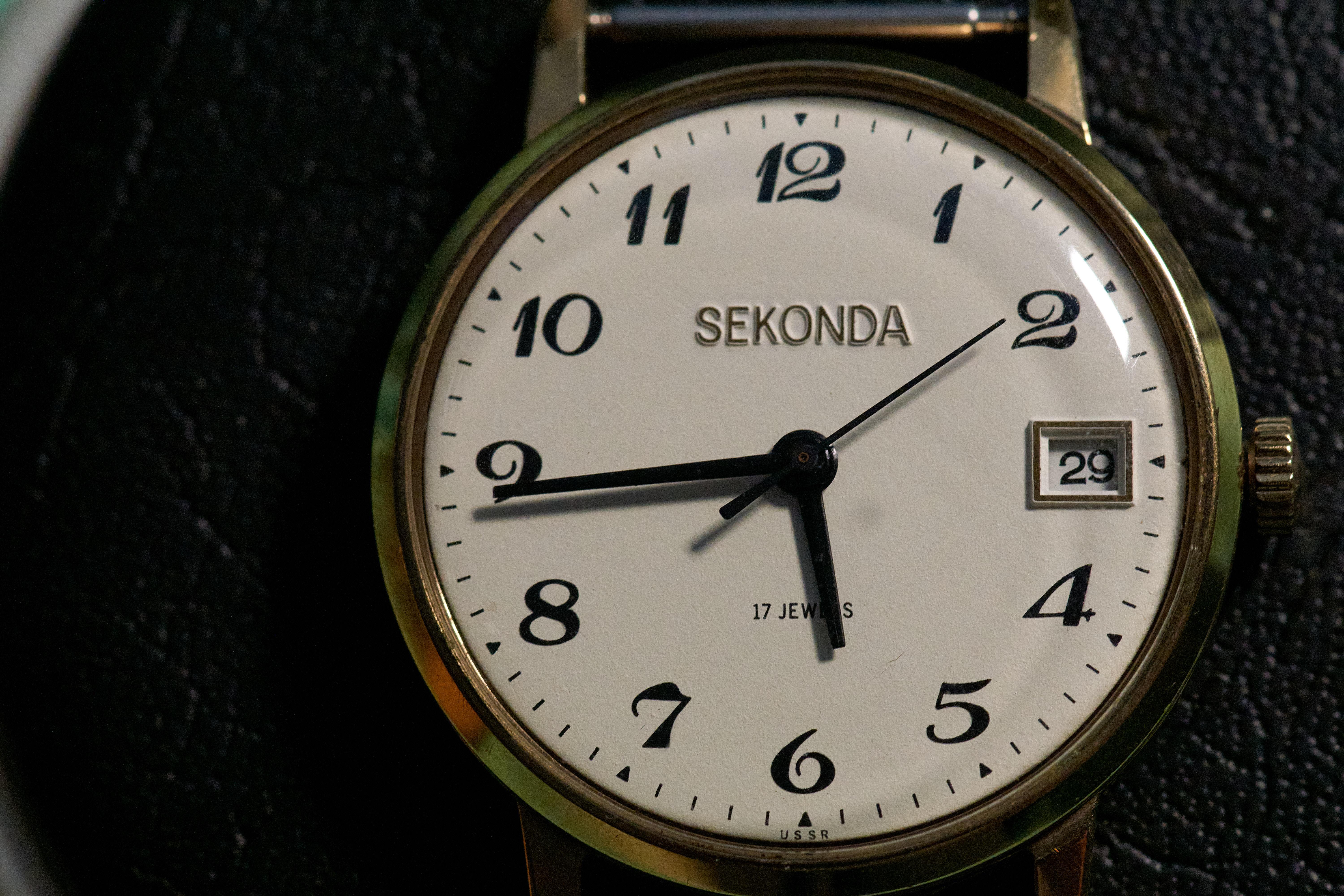

A job lot of 5  watches arrived today which I bought mainly for a Nivada and a very old Vertex.
Surprise number 1 - 4 out of five are running and keeping good time. The 5th one looks like it was given away in a lucky bag.
Surprise number 2 - This Sekonda is a minter. Not a mark on it, dial is very clean, 35mm excluding crown and it runs very well. The movement is a 2614 and it does appear to have been stuck in a drawer and unworn for many years.
There is also an unfortunately named 'Tempex' watch, which is also in very good cosmetic condition and a really nice case design which I will definitely be wearing once cleaned and serviced.
Pictures to follow of them all but, for now, here's the Sekonda.
