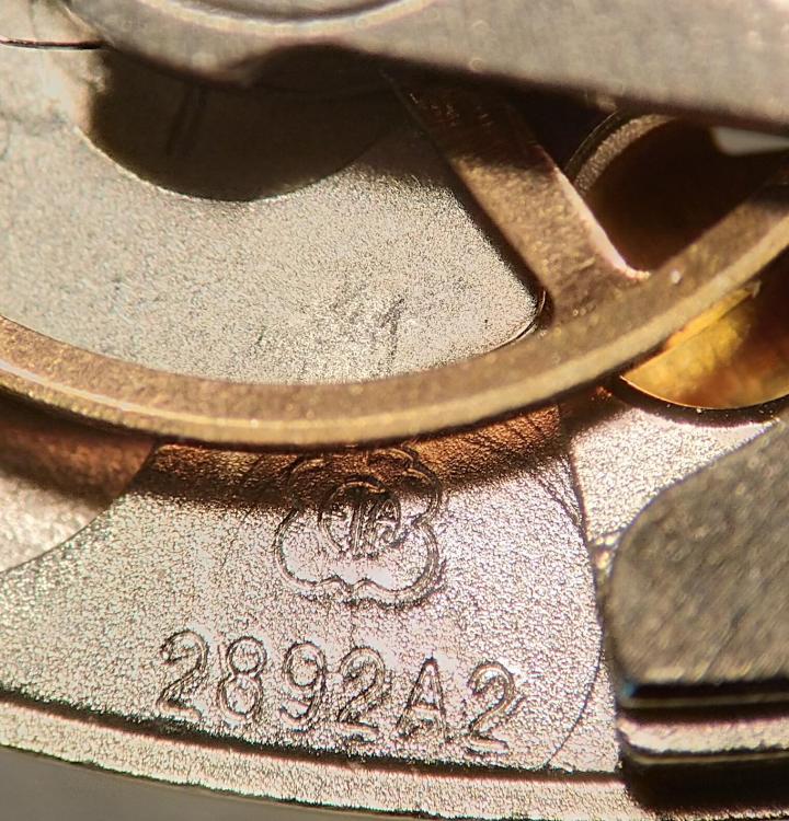

Changing the working distance will change the magnification.
116267560_Test1x45.thumb.jpg.9a08b724f5f1592e198f65f65415f61d.jpgThis first image has been taken by an Amscope 10 megapixel camera at 45 magnification, with a distance of 160 mm from the bottom of the x 0.5 Barlow lens.
1547791733_Test2.thumb.jpg.0e0157c352918144b40fe353a5f3ead0.jpgThis second image is at a distance of 180 mm. So I have only moved the microscope height 20 mm from full x 45 magnification to x 2 magnification. If I fitted the x 2 Barlow lens to the bottom of the microscope the magnification would go up to x 90, but the 'working distance' (from the bottom of the microscope to the work) would reduce down to about 20 - 30 mm, which is too little to actually work under with tweezers and screwdrivers. It is more for detailed work. I never use this more powerful Barlow lens (x 2) as the x 0.5 Barlow lens coupled with the x 10 eyepiece lens' gives me more than enough magnification I need for watchmaking, especially with hairspring manipulation. I now do all my oiling using this microscope from Amscope.

I just have a quick question out of quriosity, it appears the picture is mirror imaged is this how it appears in all these types?
I use a zwiss one and the  lens quality of course is better but even the picture shows up with the text as it should be..
(Magnification = X20)

That was my fault, as I has it flipped for some odd reason.

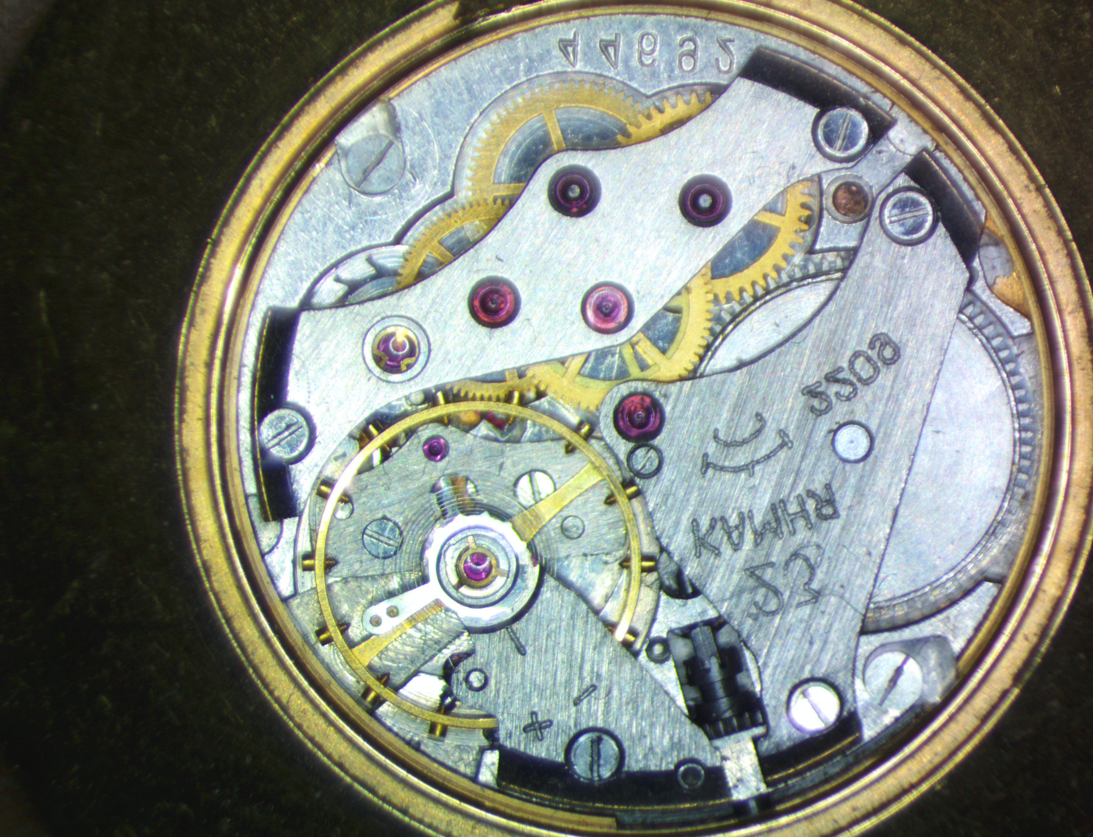

Here's a picture of the stamped in number on this Luch 2209

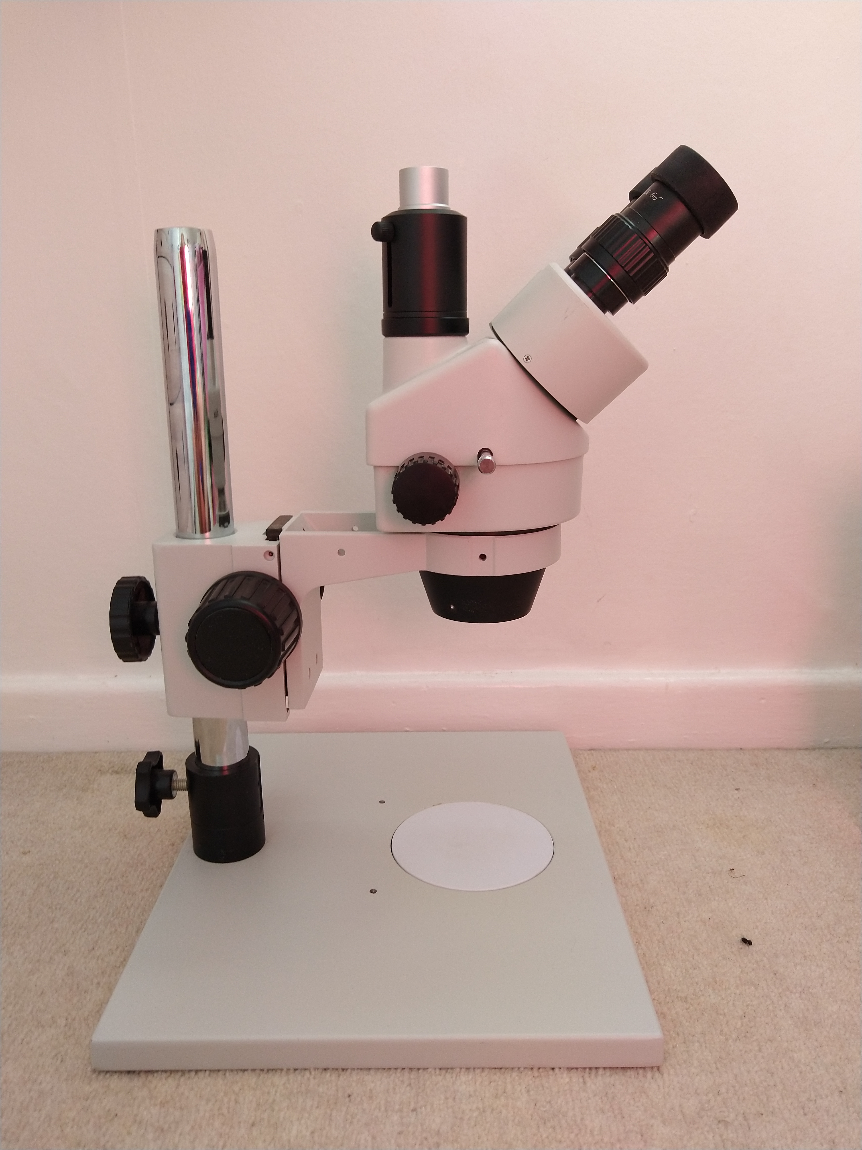

The AmScope SM-1T I own:

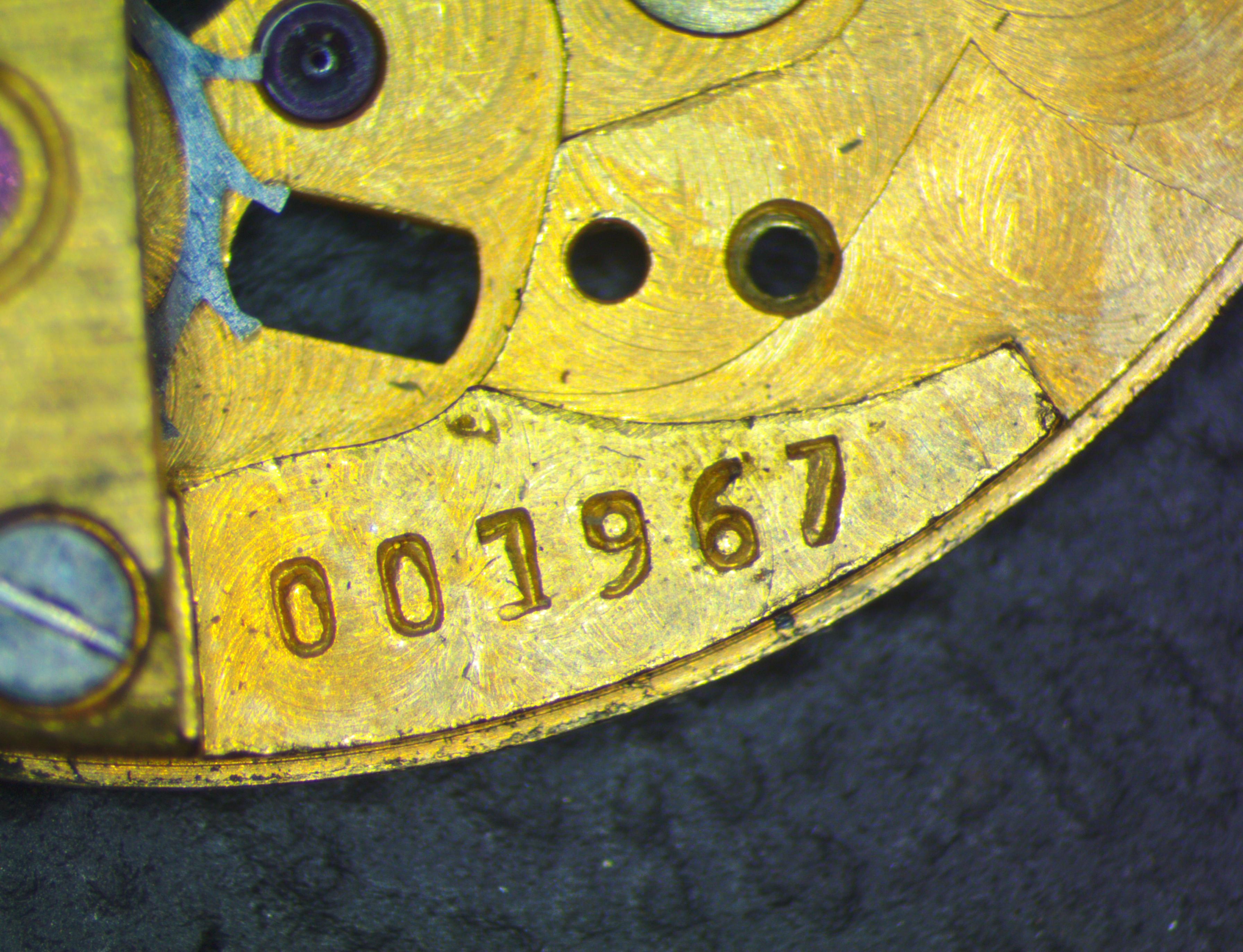

I am happy with this/ fully zoomed in:
Still happy, fully zoomed out:

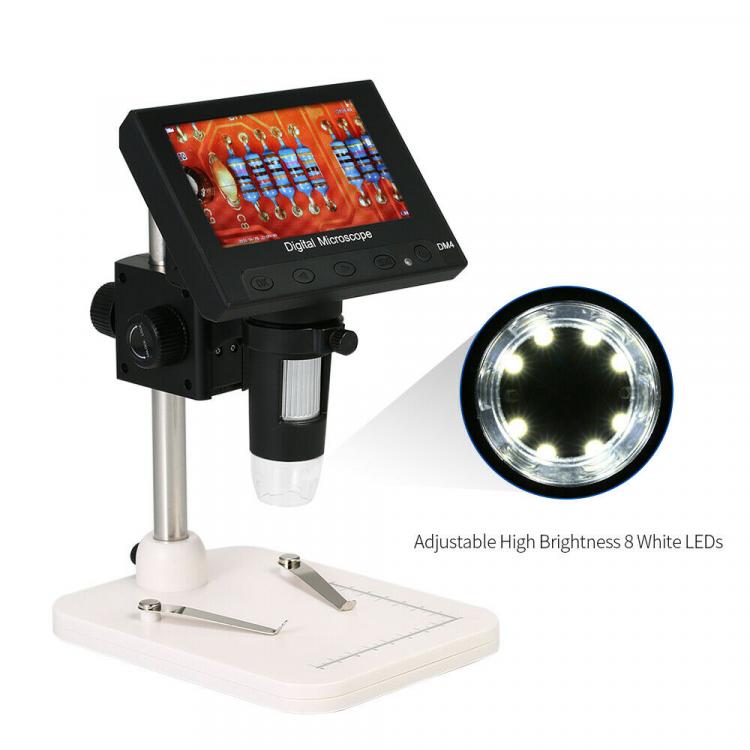

Hi there are electronic microscopes on ebay for example which are adequate for inspection purposes, The binocular type come a little more expensive. The problem is if you intend to use one to work under is getting one of the correct focal length to give you the room to work such as the electronic repair type which have a distance of up to a foot but they don't  come cheap as they specialist tools. So its a case of doing a little research into the availability of what you require and the relative cost.  I don't think there is an exact answer. I dare say that some of the forum members will have their own opinions but that's what this forum is all about
