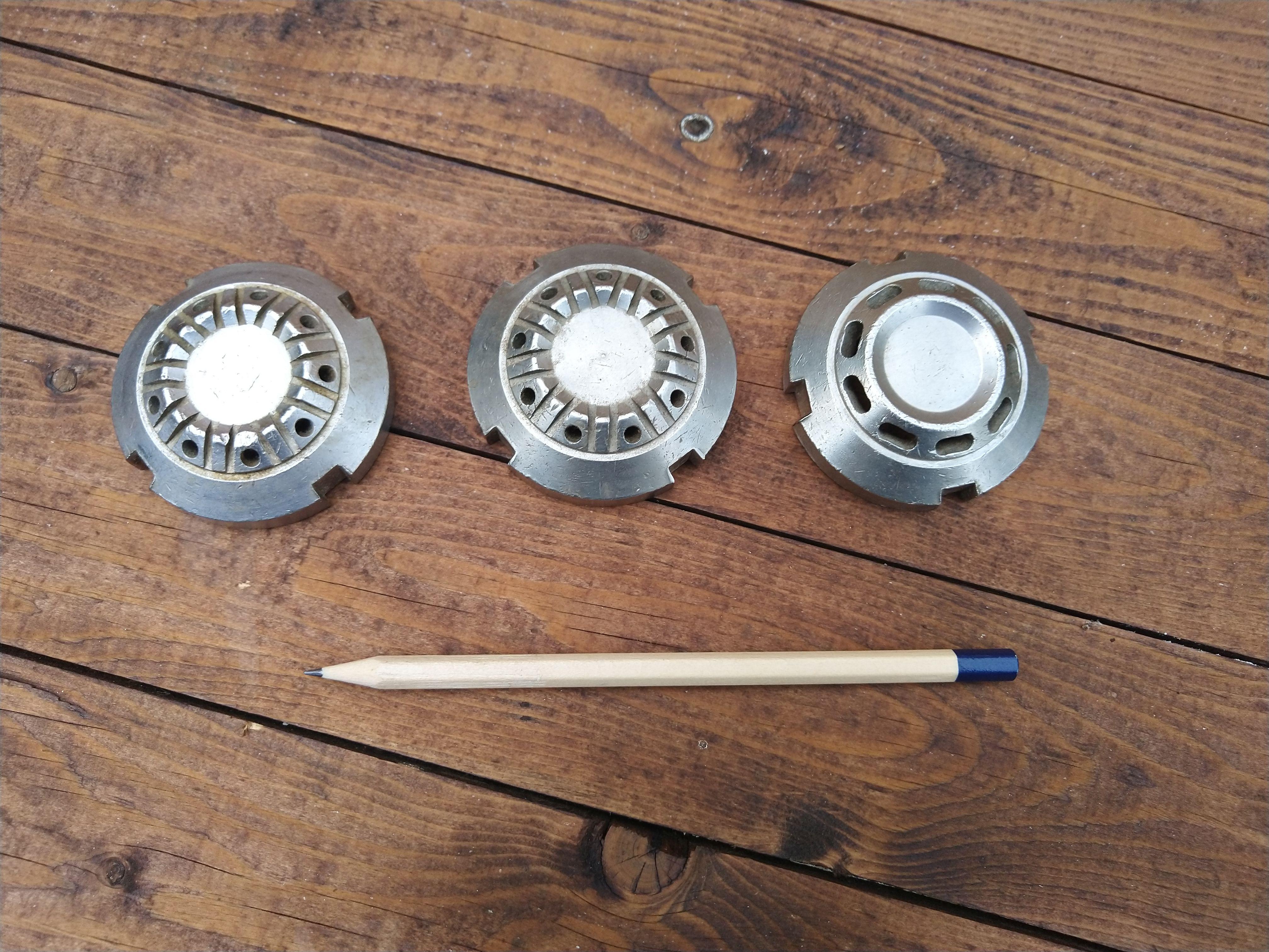

It might be an off topic question, but do you recognize the "things" on the attached picture? I got them with the cleaning machine but I dont think they belong together?
Edited by luiazazrambo
rotating pics
