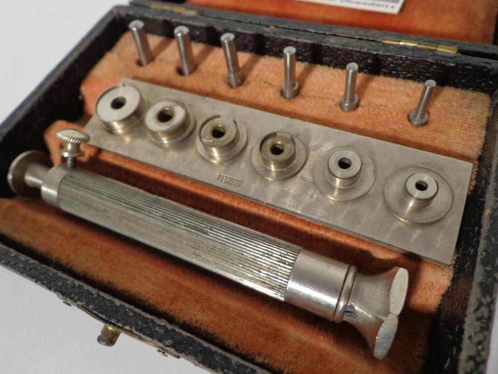

Hello,
I am looking to buy a mainspring winder, since I would like to clean and put the mainsprings (worth putting back) into the barrels. This is something that I found but I am not sure if this is what I need. Mainly looking for a winder which could wind man's wristwatch mainsprings (for example, Seiko 5 or standard ETA movements).
Also, I am not sure if I am able to wind mainspring for automatic watch with this tool.
Thanks in advance!
Edited by bojan1990
These old mainspring winders aren't necessarily bad, but they almost without fail have arbors that are just far too big to work with modern springs. You can sometimes get by fitting a smaller arbor to the bigger barrel,  but it's usually a pain and requires almost more skill than hand winding the spring in.
The trouble her is you cannot tell if the hooks on the arbors are in good condition, you don't want them worn so they won't even hook the spring. I suppose you could ask the seller. It's still an old one.

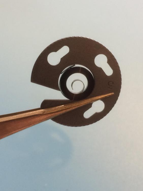

Hi Allan
I too am short of main sporing winders. I bought a really ceap set from ALIExpress but these are poor quality and I do not expect to get much winding out of them. The arbor pawls are brass instead of stianless and Mark Lovich points this out in his appraisal of this set. I went on Cousins UK web site and noticed you can purchase all the individual items for a full set of Bergeon set of 17. I contacted Cousins to ask if they did just the box that would hold the 17 and I could buy they winders as I need them to eventually make up a full set. Sam Cousins wrote back and said that the box only will be available July. I will definitely be ordering one.  I have already started the collection and have the left end right hand holders. This is a good way to spread the cost and get a quality product.
16 hours ago, bojan1990 said:
This is another one I found, looks like Bergeon thing, but again I am not sure if it is suitable for wristwatches:
I own these (but in blue) and they work well for me. They are definitely suitable for wristwatch mainsprings. The handle and the drums are made from aluminium I think, the arbor for attaching the mainspring is made from steel
In my experience (some seven years now, and a few professional level courses at AWCI in Ohio) there is no simple solution to the mainspring winder problem.  I've owned and used the K&D 128.  Not very friendly, but useable for most American PW sizes.  Wouldn't count it for wristwatches -- barrel sizes generally too large.  Also used K&D WW size winders (set of three with variable "barrel" sizes).  These are easier to use and quite useful for older WW calibers, particularly American.  What many folks starting out won't understand is that the winder has to fit a number of different dimensions:  Winder barrel must be just smaller in diameter than spring barrel.  Winder core must be just larger in diameter than spring eye (to assure secure grip without permanently distorting eye.)  Height of winder barrel wall must be close to width (height) of mainspring -- if too high, spring will uncoil inside the winder barrel creating unholy mess and destroying mainspring (ask how I know!)
Understand that modern automatic mainsprings are completely different animal than old PW or vintage WW springs.  They are much longer (meaning larger diameter when fully wound), much narrower, and generally have much smaller eyes.  Old American winders cannot be used on these without extensive modifications.
Which brings me to solutions.  Currently I'm using a set of generic Swiss winders sourced on E-bay for about $350.  These are identical to current Bergeon set of 17 right-hand winders selling around $900.  Also still using the K&D adjustable set of three.  Finally, using new set of Chinese winders (similar to Swiss pattern, quality not bad) designated for various ETA calibers (also fits some Rolex).  Even with all these options,  creative modifications are called for -- reducing height of winder barrel wall by inserting small washer to take up space, turning tiny ferrule on lathe to allow use of ETA caliber winder in generic winder barrel, etc.
Sorry to advise there is no simple solution. You will likely need several different winders before you're fully equipped.  Best advice is to practice repeatedly with old mainsprings, preferably identical to the one you're replacing.  Make modifications as required, and proceed with that expensive new mainspring only once you're fully confident you have the bugs worked out.  Oh, and don't believe people who say you can do it all by hand . . . best of luck installing 60-hour power-reserve automatic spring by hand without destroying it.  Simply won't happen . . . !
